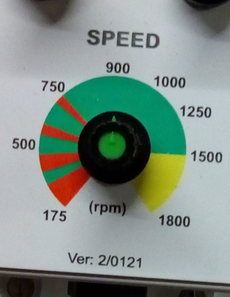

        Hi All. Upgraded my old lathe a while back with a Newton Tesla VFD package, and have been very happy with the end result. Just one item needs clarifying though – on the panel is a speed control knob with colour segments making up the legend. Some sections (lower speed ranges) are red.
        Now common sense suggests the following
        Green segments = OK to use full whack, long as required.
        Yellow (highest speed) = Perhaps OK for a bit, not extended use though.
        Red = ?. Is this do not use at all or yes OK for a very short bit but not recommended or use at own risk?.
        I understand the apsect of motors overheating etc at lower speeds with VFDs, but wondered if anyone had the definitive answer regarding the red segments. There's no mention of these in the NT documentation. I could ask them directly but thought it may be of interest to other members first.

              Can't read the markings around the pot due to focus, but it rather looks like this is the speed range that is below the motor base speed. Running in this area the motor can draw full current but the cooling airflow will be reduced due to the reduced fan speed – with attendant risk of overheating the motor.
              If you want to regularly operate at high loads at below the motor base speed, you could consider removing the shaft mounted fan and fitting an external blower to give the motor continuous cooling air flow regardless of motor speed.

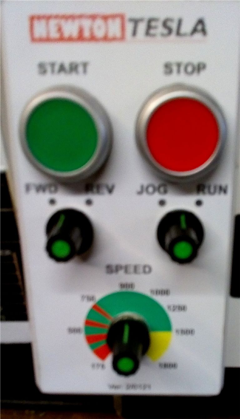

                Better close up pic –
                I think I'll drop NT a message about this and will share any info I get back. It seems odd that this hasn't come up before as i'm thinking this sort of package must be in widespread use?

                  I think this is just an indication that at these speeds the cooling on the motor is compromised and continuous full loads will cause overheating.

                    I’m with Martin on this, when I fitted my NT set up they said only use in the red for short periods so most of the time now I just select backgear for the short period of work (screwcutting as an example) then the vid comes into its own as it then needs to run the motor at a higher rpm

                          Does the lathe have mechanically changeable speed ranges (belts or gears)? If so those red sectors look as if they could be the bottom end speed that the motor can be run at. So if the speed you want, in the mechanical range that you have set, puts the pointer in the red then select a lower mechanical range and run the motor quicker. Motors don't like being flogged at low speed as the cooling fans aren't working efficiently and the windings can cook. The yellow sector probably shows where the motor is being run at significantly higher frequency than the nominal 50/60Hz and so the torque available will be falling off or the losses could be getting higher leading to overheating

                            Some aircraft I fly have similar red bands on the rev counter signifying ranges where the engine shouldn't be operated continuously, normally due to propeller/engine resonance. However I don't think that is the case here. I can't think why the VFD/motor combination would have speeds to avoid.
                            I agree with NigelB, I think it's a warning to be careful at low speeds due to reduced cooling. The increasing width of the red bands indicates that the problem is greater as the speed gets lower. Unfortunately it's not done terribly well, as the graduations from more green to more red are too coarse.

                              Following the variety of opinions offered here, I did raise the question directly with Newton Tesla and have just had a response from George Newton. It is most comprehensive & informative – and something I think will be of interest to many members of the forum as it gives a very clear technical description of VFD operation from a very experienced guy! So have included it in full below (I did ask if he had any objection to that, and he didn't appear to).
                              From George Newton at Newton Tesla:
                              Many thanks for your email.
                              You refer to the legend on our control pendants, the legend plate is due for updating like the AV750 which has smooth graduation from one colour to another.
                              It used to be the case that running motors less than 20HZ could give rise to overheating with inverters running at a fixed voltage/ frequency ratio of 4V/HZ. Today this is no longer the case as we operate inverters in 'Flux Vector' mode whereby the inverter automatically changes the V/F according to the torque demand. Consequently full torque is available at slow speeds without danger of motor overheating. Also even though a lathe may be in use for long periods of time in the workshop the variation of cutting speeds and feeds, stoppages to check the job etc results in a duty cycle of about 40 – 60% compared to many industrial applications having a duty cycle of 100% for 100% of the time.
                              We will update the Pendant control station legend plate in due course and apologise for the confusing red/green graduations, in the meantime please run your lathe at any speed from slow to fast in the knowledge that the inverter will protect the motor from harm.
