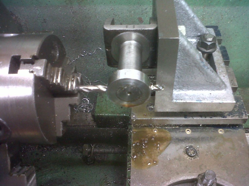

                          #85309
                          Trevorh
                            @trevorh
                            New problem,
                            I need to drill through the shaft that the Perch bracket sits on its 3/4" dia
                            each time I try on a sample peice the drill runs out – off centre by the time it comes out the other side
                            any tips on how to keep the drill true as it drills
                            #85310
                            David Clark 13
                              @davidclark13
                              Hi There
                              Drill should not wander if you use a sharp drill after a centre drill.
                              However, put the shaft in the dividing head, drill undersize halfway through, index 180 degrees and drill the other half.
                              Follow through with another undersize drill all the way through finish with size drill or ream.
                              regards David
                              Edited By David Clark 1 on 20/02/2012 11:08:49

                                    #85318
                                    Trevorh
                                      @trevorh
                                      Sorry I should have been more clear I am trying to drill a 3/16" hole through a 3/4" round bar that also has a collar on it that measures 1 1/4" od
                                      I have to put a retaining pin through them both, I will see if I can take a photo and post it
                                      cheers

                                        David Clark 13
                                          @davidclark13
                                          Hi Kerbtrawler.
                                          That is what I thought, small hole.
                                          Bore a square block out to fit on the bar, drill and tap and use a grub screw to nip the block to the shaft.
                                          Put the bar in the vice, squaring up with a square.
                                          Drill undersize halfway through, turn the bar and block over, drill through from the other side.
                                          Drill through the collar, from both sides if neccesary.
                                          Assemble both parts and open up to finished size.
                                          regards David
                                          #85325
                                          Trevorh
                                            @trevorh
                                            Now thats the kind of idea I can manage, I just couldn't get my head around how I could go 1/2 way, turn the job over and hope to hit the same spot.
                                            Thank you very much for all of the suggestions, I will report back in the morning on how succesful it is

                                              Les Jones 1
                                                @lesjones1
                                                Hi kerbtrawler,
                                                I notice from one of your first posts that you have a Warco GH1224 lathe and a vertical mill. I wonder why you do not use the mill ?
                                                This is a variation of David's suggestion using your lathe. Mount the square bar on the cross slide of your lathe with suitable packing under it to bring it up to be about centred at centre height. (Mark it so you know which is the bottom surface. True it up with a dial guage to be parallel with the axis of the lathe. Move the cross slide to bring the square bar about centered in the horizontal direction and lock the cross slide. Now drill it with a drill in the lathe chuck and then bore it with a boring head or boring bar in the lathe chuck to 3/4" bore. Turn the square bar through 90 Deg on the cross slide USING THE SAME PACKING and the SAME SURFACE DOWN. Again check the alignment with a dial guage. Drill a hole and tap a hole in the block for a grub screw. If you now slide your 3/4" bar into the block and clamp it is exactly at centre height and at right angles to a drill in the lathe chuck. You should now be able to trill the hole exaclly on centre.
                                                Les.
                                                #85370
                                                Trevorh
                                                  @trevorh
                                                  Just reporting Back, Success
                                                  I varied the idea's and mounted the part onto an angle block which i fitted to the modified top slide of my Warco 1224 and used a centre bit in the chuck to spot the ring and then went through with a 3/16" and then finished it off with a No 11 drill
                                                  I had previously secured the ring to the shaft using Gorilla glue which gives just enough grip to keep it in place
                                                  I will post some other photo's once I know how
                                                  Many thanks for the idea's
                                                  Edited By kerbtrawler on 21/02/2012 09:09:53
                                                  #85371
                                                  Trevorh
                                                    @trevorh
                                                    Here is what I did
                                                    over view
                                                    There are a couple of more photo's showing the mod to the top slide and so on
                                                    cheers
