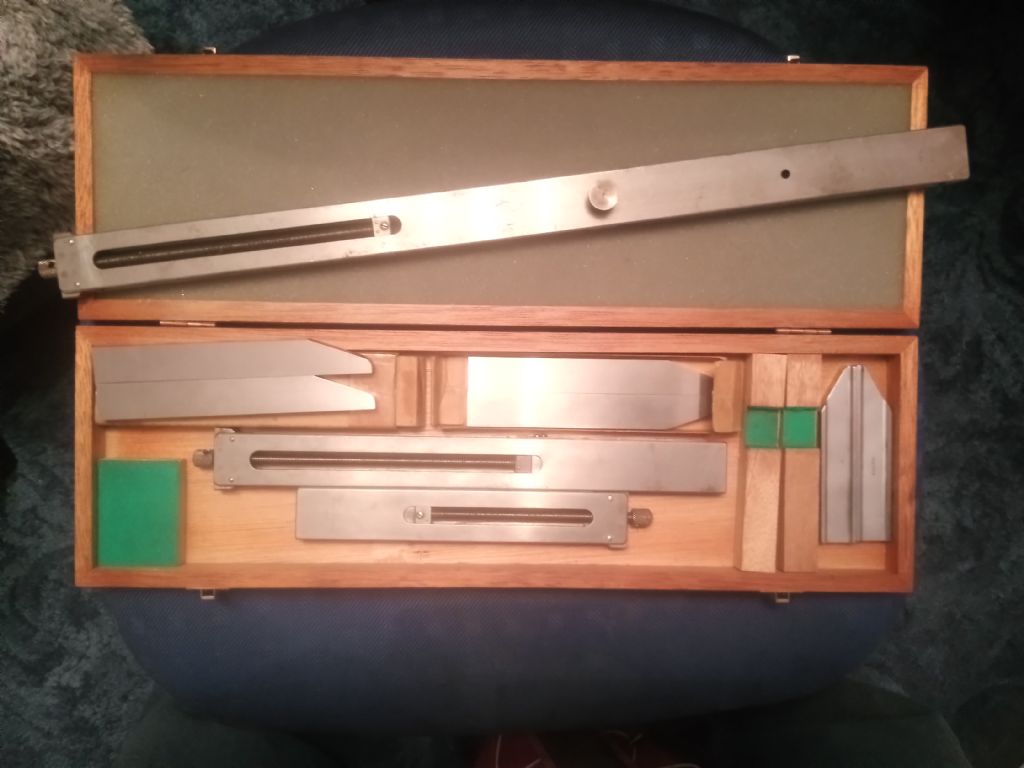

          Good afternoon All
          Please can you help with what this set is called and does, I think it is for setting up accurately parts? The longest arm is 19.5" long. it is not in its original box.

            @davidsanderson3
            it looks like its used for holding a stack of gauge blocks I've seen similar on a few you tube vids

              @oldmart
              As already mentioned, it looks like a slip cage, they had them in our inspection, not thought of highly by the inspectors as I recall.

                @peak4
                Head over to eBay and do a search on "slip gauge accessory"
                There's a couple on there at the moment, though with a few more parts than your set.

                    @howardlewis46836
                    The jaws are used to clamp a stack of slip gauges (Gauge blocks ) as a precision measuring instrument.
                    Only ever saw such things used in the Standard Room, rather on the shop floor.

                      Posted by Howard Lewis on 30/12/2022 22:15:52:
                      Which is presumably why old mart’s Inspectors didn’t think highly of them
                      … if the slips/blocks need clamping together, they are almost certainly out of spec.

                        Posted by Michael Gilligan on 31/12/2022 00:28:51:
                        Depends on how large of a stack of blocks you want to make. Gauge blocks used daily don't necessarily wring together all that strongly after a while. And wringing together a large stack becomes a game of chance. And depends on what you then need to do with the stack of gauge blocks. If you need to insert it into a large piece of precision machinery to set a large gap to a precision setting, you don't want all those blocks falling down inside the machinery so a clamp might be very handy.
