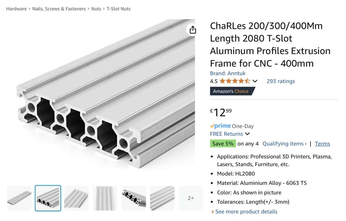

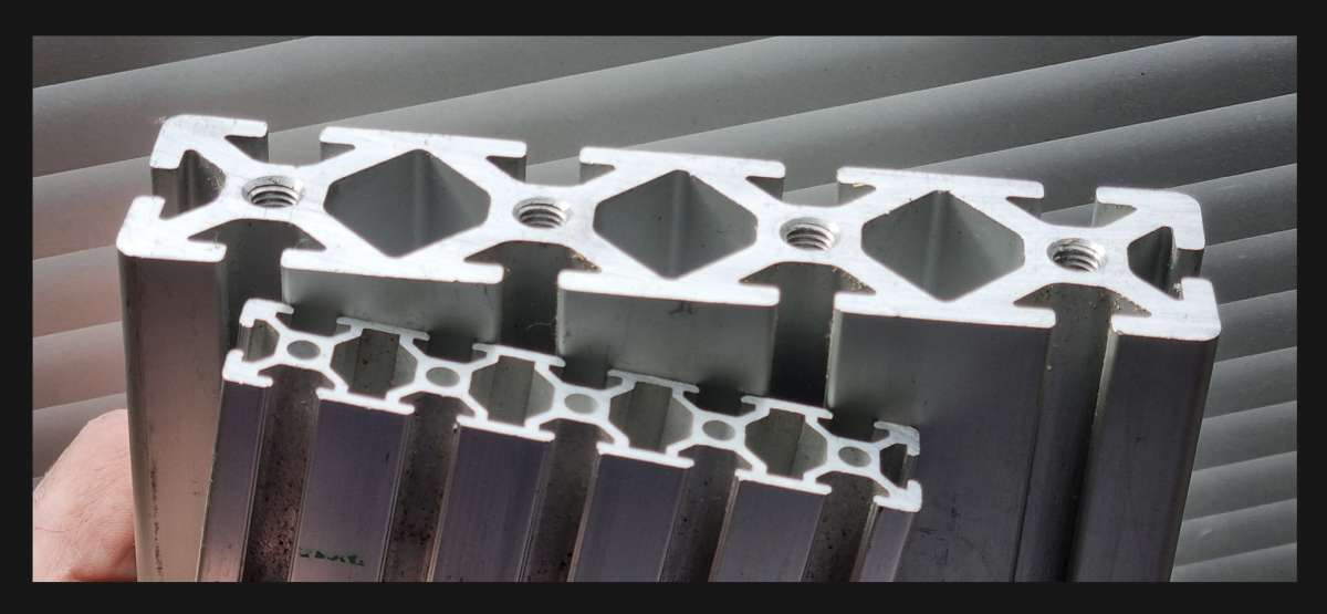

                    I’ve seen this type of extrusion many times before, but nothing this wide. Any links for something like this or a suggestion of a good search term? I’m thinking it may come in handy for future projects.

                      Hi Vic,
                      In my Toolmaking career I built many assembly Robots using this type of construction medium. We mostly used “ITEM”, but for Audi they insisted we used “BOSCH”. The latter was much more expensive, so be sure to be sat down.

                        Vic, google 2080 teeslot for the small one and 30120 teeslot for the large, you can also get 40160
                        #781212
                        Vic
                          @vic
                          Great, thanks. I did have some bookmarks for stuff like this a few years back but can’t find them now.
                          Edit: I’ve added this to my Amazon wish list for future reference. 😉

                            Those profiled extrusions are very useful but some care needed with the economy range versions which frequently aren’t as flat, straight or true as the naive customer might hope. Rarely bad enough to be an issue when building  simple, not too large things, from basically square or simple rectangular profiles but you should check. Machine building quality cannot be take for granted.
                            It’s remarkably difficult to extract actual straightness and flatness tolerances from the online catalogues. The optical equipment suppliers, who might be expected to source high quality extrusions, seem to claim between ± 0.1 and ± 0.2 mm per metre. 25 or so years ago when I got involved with the stuff I was “less than convinced” and rejigged sections of kit built by less discerning co-co workers with cast iron!  For ordinary commercial extrusions up to ± 1.5 mm per metre seems to be acceptable in some quarters.
                            Having paid a small fortune for the good stuff handle it carefully. It’s easier to bend than you might expect. Especially the basic un-heat treated stuff which relies on age hardening to reach its specified stiffness. There should be a material state code. T3 is basically quenched straight out of the extrusion press and ages to T4. T5 has proper heat treatment process and ages to T6.
                            When it comes to the wide ones like those shown by Vic you get what you pay for and the high end brands are far more reliably flat. Re-working an inadequate section to machine table standards could be interesting, and not in good way.
                            Clive

                              If you look at Sebastian’s one that is why he says you may need some shim tape when fixing the linear rails to the extrusion so that they are not distorted an dcan be set true to each other.
