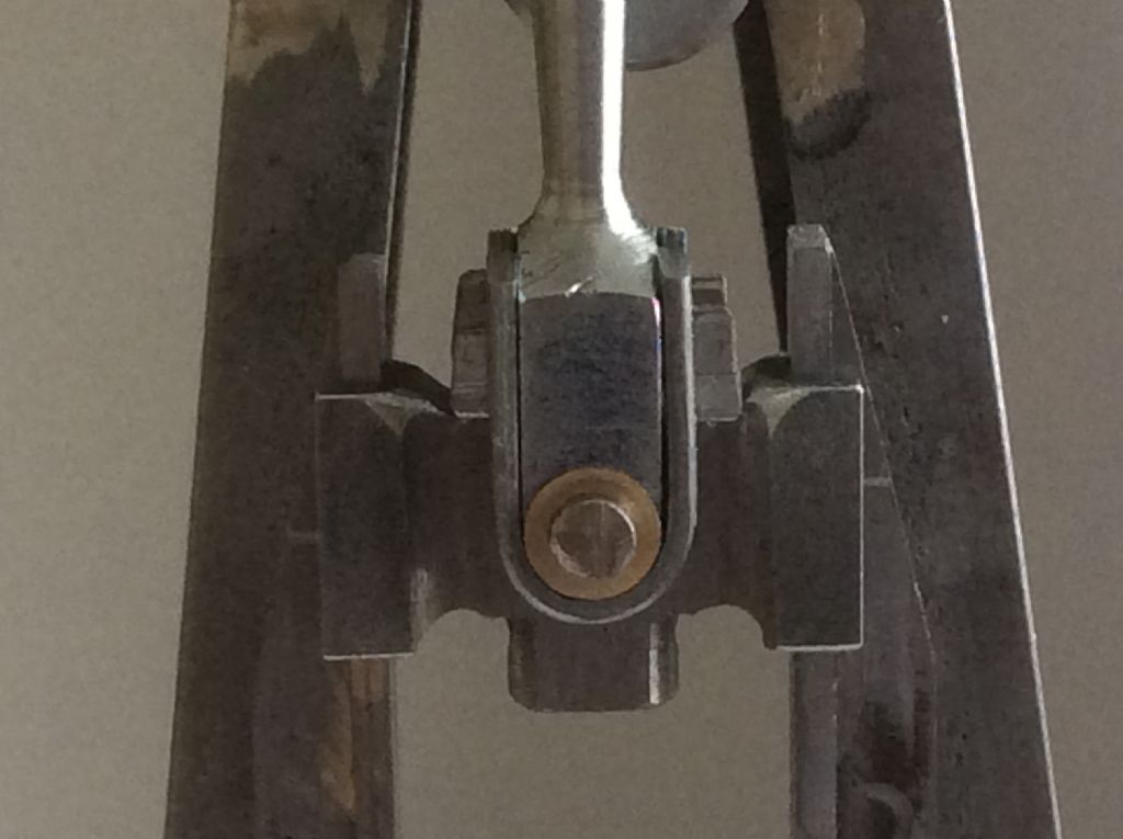

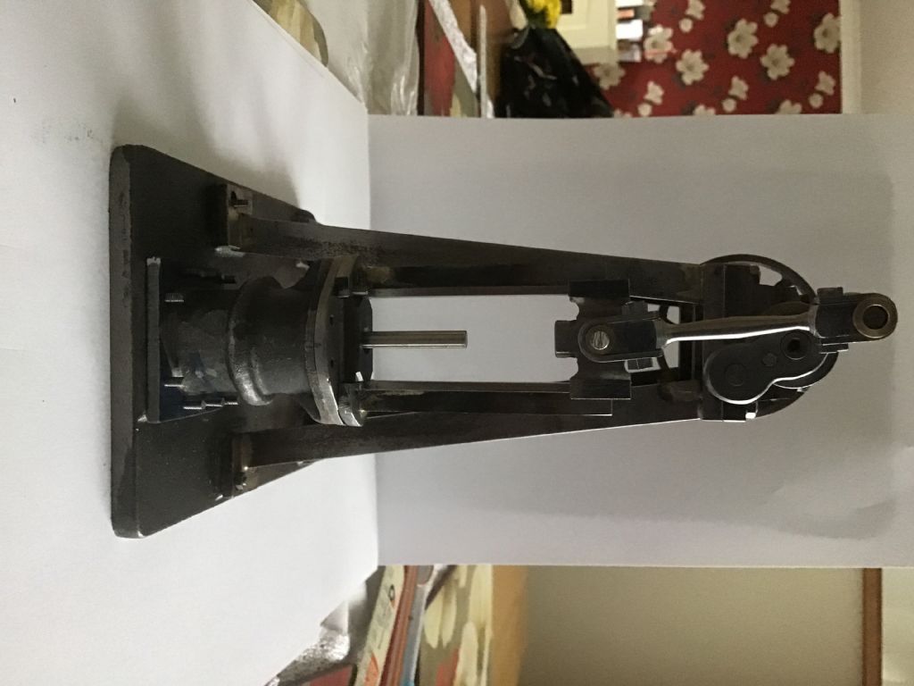

      Hi. Just wondering if anybody has built this engine or is in the process of building it? I am a good way through the project and today had a trial assembly of cylinder, piston, connecting rod and crank. On assembly I found that the cross head travels almost outside of the guide bars by about 1/4 inch at the extremity of crank stroke!! I also left the guide bars slightly over length and am confident that I have all the contributing lengths to drawing size. IE, table legs at 4 7/8 inch long and at 8 degree angle. Suggestions as to what to do now would be very welcome, like maybe try to extend the guide bars? Neil, any drawing errors known of. Many thanks, Jim.

            Jim, can you post a photo of yours, may be able to spot something obvious. Neil's photos of his look to have plenty of room for the crosshead to stay within the guides. I did check through his drawings before publication but nothing on the list that would affect your situation.
            What length did your guide bars come out as as they are a "check on job" item.

                    From your photo it's plain to see the problem at the top of the guides, what's it like at the bottom? If the crosshead has 1/4 of an inch to go before the bottom of the bars the problem could be in the length between the centres of the connecting rod. If the crosshead goes too far down as well as too far up then I would be looking at the throw on the crank.

                      Does look something amiss
                      Adding up the vertical length of the legs ( 4.827),  table thickness and bearing pedestal height I get a crank Ctr of 5.52"
                      If we then add the crank throw to this the pin when at TDC will be 6.07"
                      Less the conrod length of 2.125" gives the middle of the cross head at 3.95".
                      Now add up the cylinder height, cover thickness, guide and foot and you get 3.626" to the top of the guide Though that is a check on job dimension.
                      Two options but best wait for Neil to comment first as he has a Model to check sizes from.
                      Edited By JasonB on 02/09/2019 14:27:32
                      Edited By JasonB on 02/09/2019 14:28:26
                      #427094
                        Doing what we should not do on the general arrangement drawing the legs look like they should be a lot shorter than the 4 7/8" , more like 4 1/4"

                            Firstly, apologies for posting a photo with no additional notes.!! To Jim Nic…when I was initially assembling the engine, I set the cross head at the bottom to gauge the piston rod length. There is lots of clearance at the bottom. It was only when I took the cross head to the top that I realised that the guides where too short. ( I even left them a bit over length !) Hi Jason, thanks for your comments and numerical input. Yes it would also seem to me that the legs as dimensioned could well be over length as you infer. Hope Neil is around soon to put a rule on his model and shed some light on the issue. It may just be possible to cut off the tops of the legs and re solder the table on ? Cheers all.

                              Hi Jim, just caught up with the posts. I thought that I would just point out that the crosshead should just overrun the ends of the guides by, In full size, about 1/4". This is to prevent the wearing of a step where the crosshead travel ends. Likewise, the leading edge of the piston rings, going in each direction, should over run the bore a little, into the counterbore that should be at each end of the cylinder bore. This is what is recommended in text books on full size engines. Whether it is worth while on a model depends on how much actual running it will get, and how authentic you wish to be.

                                Yes, I'm afraid the legs are too long high – they are angled at 8 degrees.
                                They are about 4 3/16" high so should be made 7 1/4" long, I have no idea why the plan give the wrong dimension as it was auto dimensioned and is drawn the right size.
                                Sorry about this – the best solution is probably extending the connecting rod by, say 3/8".
                                I'm surprised this hasn't been noticed before although only a few appear to have been built.
                                I'll change the plans.

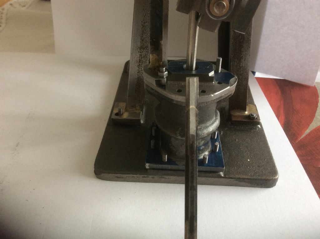

                                  Hi Neil. Thanks for getting back to me. Today I decided I would increase the length of the guide bars. They still might be a tad over length but can shorten if needed. Cheers Jim.f76abaaa-1b75-4bdf-a5a1-556d83135044.jpeg88eb163a-60dd-4305-824b-01aa1e25fcd8.jpeg

                                    Thanks Jim,
                                    You are doing a nice job. Looks neater than mine.
