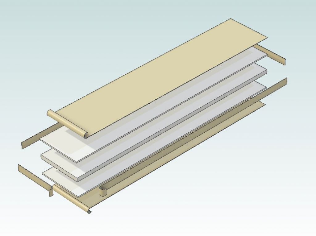

              Two off cuts of 6mm veneered MDF from the backing of your sideboard glued to a strip of 18mm MDF will give you the thickness and a balanced lamination. and stick on some strips of 6mm thick solid oak lippings so you can plane or router cut the chamfer. You don't have to have a solid filling, strips will do to keep the weight down
              Alternative is to glue up another lamination of MDF preferably MR cut to final size once glued a sit's easier than trying to stop the layers squirming about as you clamp them together. Then cut a 6×6 rebate around the top edge and glue in some 6×6 square oak strip. Get some "flexiveneer" and cuts so strips to glue to the ends and then the sides, finally cover the top and bottom with same. Router cut the chamfer which will cut through the veneer and into the 6×6 strip.
              Apply finish of choice.

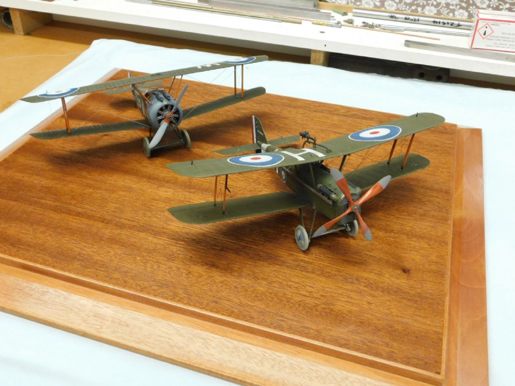

                  Sorry Jason, I'm not sure what you mean. After 6 weeks of going stir crazy with a broken foot at Christmas, and now 10 days to self-isolate in the spare bedroom with Covid, I'm not 100% with it.
                  Do you mean something like this:
                  I'd have to match the side pieces with the surface somehow, and presumably chamfer the corners? I can't accurately cut wood by hand, so it might be a big ask. A friend has a CNC router he built, so I guess he could do it.
                  The displays look great by the way. Cheers.

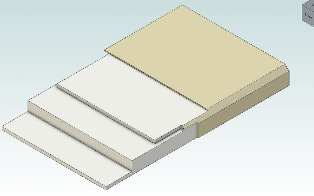

                          The first option described is like this
                          Some strips of 18mm MDF say 35mm wide glued onto a piece of 6mm oak veneered MDF with a second piece on top. If you make that structure 1020 x 220 once dried it can be cut down to 1000×200. Then glue some strips of 6mm x 30+ oak around the sides. once set plane/sand flush and then cut your chamfer.
                          Second option is to just glue up solid or with the strips again but just use unfaced MDF.
                          Once that has been cut to 1000×200 cut a 6mm x 6mm rebate along the edges you want chamfered and glue in some strips of 6×6 oak or a littkle larger and plane flush so you end up with a core that looks a bit like this box where the oak would be your MDF and the ebony your 6×6 oak strips
                          You can then veneer the ends & trim flush. Veneer the front & back and trim flush. Veneer the top and bottom and trim flush. Finally cut the chamfers which won't expose any MDF as it will just be the soak stringing that shows through

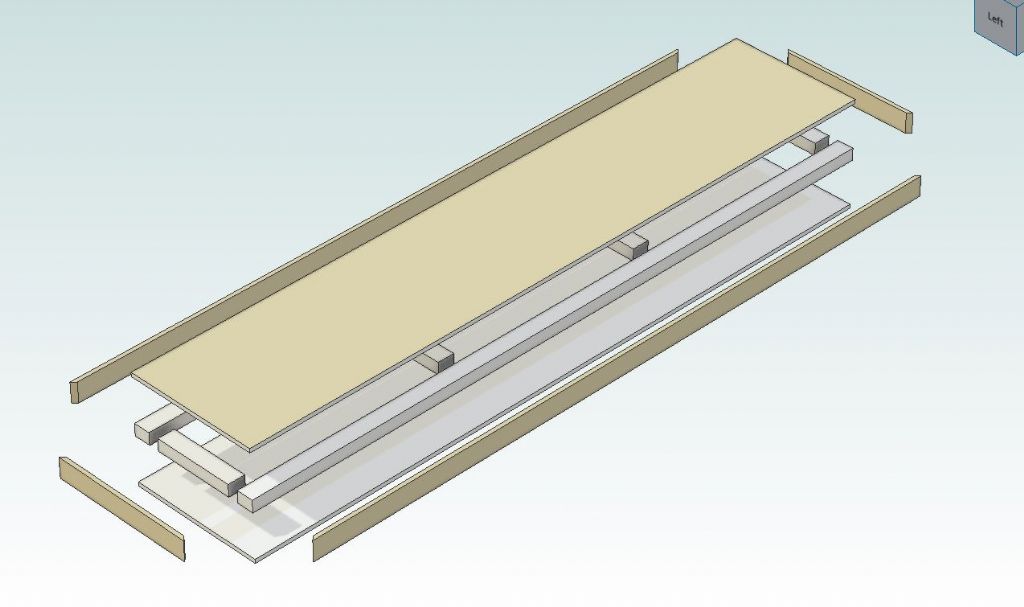

                            I would broadly do as Jason has suggested.
                            Two sheets of 3 or 6mm MDF for top and bottom, inner framework of MDF strips, (like an aeroplane wing, only flat)
                            Glue it all together, then lip the outer edges with hardwood, say 8mm thick, mitred at the four corners, flush it off with the top/bottom.
                            Veneer over the top and bottom, trim edges flush, then chamfer . Use matching veneer and lipping, and you won't see the join when you chamfer it.

                              Jason – yes, the first option is what I like – I've had no luck with attaching thin veneer to the edges of any veneered MDF furniture I've make, so having the top surface already done is good.
                              Only difference to what you say is to get overall dims back to 1000 mm x 200 mm, I would have to machine to 988 mm x 198 mm before sticking the 6 mm solid sides and ends onto it.
                              Another similar option, which would avoid any thin veneer would be to use 6 mm veneered MDF for the top, sides and ends, all cut to be 6 mm short, then glue in square stock and chamfer all edges (top and vertical)? In fact there are lots of combinations of the above. I guess it depends on the capacity of my friend's CNC router becasue I know if I try to do it by hand I won't be happy with it.

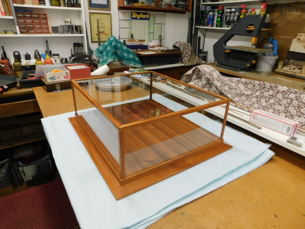

                                        It seems to me looking at your previous models that you have used wood but in comparison they are much shorter. I can certainly appreciate your desire not to have a base that will eventually twist.
                                        You could try using block board – a lamination of two layers of ply separated by strips of timber glued together. Not cheap but you may get an offcut. I have some that is 1" thick that I used for a baseboard to build a large ship model many years back (due to circumstance at the time it was never finished) It's very dense and extremely warp resistant.
                                        I used a left over piece to make the base for this case and cut the timber to surround it. The timber was recycled from an old mahogany mantel shelf
                                        The surface is the ply – not further veneered and coated with french polish ie it is not 'french polished' in the traditional sense
                                        Its absolutely flat and is now several years old and sits on the sideboard in a centrally heated environment – no warps yet
