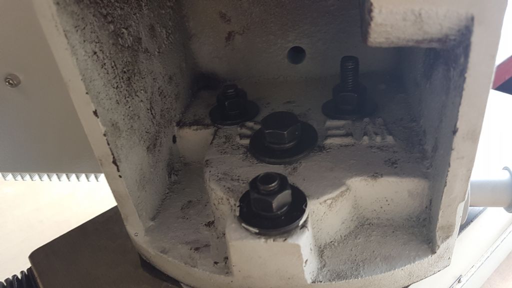

      That's a grim thought but hopefully not the case, weiss have just emailed me back telling me to make sure all 4 bolts are loosened to rotate the head.

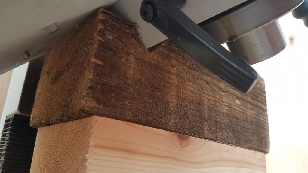

        I think it will have jammed, but shouldn't have caused any damage. I don't think you need to rotate the head to remove it, but you will need to support the weight before removing the nuts/bolts. Probably just need to make some wooden vee blocks as you said, lower it onto them and when the weight is taken on them, it will probably be free then. You will then be able to remove the nuts/bolt and wing the table forward with the head supported on the blocks.

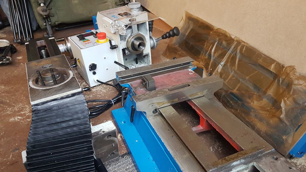

          20191218_100542.jpg20191218_105342.jpg20191218_111832.jpg20191218_142648.jpgSuccess, it came off easily, not sure if it moves freely when attached but will reinstall when the column is lying flat to see if there are any problems. Managed to dismantle the rest to get it in the shed so i'm very happy. The column was the heaviest thing and the gas strut was a pain to get off. Couldn't get the y axis off the machine, gib is jammed so will have a look at that later on or tomorrow. Couple of pictures below and have uploaded a few more of my dismantling process to an album in case anyone wants to have a look at the guts of the machine. If anyone wants any detailed pics let me know and i'll do my best.
          Thanks for all the help everyone

            Interesting bit of 'Chinese' engineering in your 1st image above, where the bolts and washers bear on the cast in raided letters rather than a flat surface. Might be worth fettling that whilst it's apart. could make the clamping / rotating / re-fitting a bit smoother.

              Good point John, will have a look to see how they fit back on and file down the high spots, nice tip thanks.

                If it were me, I would loosen the pivot bolt then run it back by hand until it just contacts. Then loosen the other 3 nuts 1/4 – 1/2 turn.

                  Looks like Grey got it right. The top right tee bolt looks like it is pulled up into the hole for fitting and removing the tee bolts. This will prevent the head rotating until it is pushed back into the slot.

                    Nice spot martin, i completely missed that but the angle that the head rotated to would line up perfectly with the tee bolt entry gap and explains why it would only move a few degrees each way. I have just got to make sure that doesn't happen again when i re-assemble. I'll tighten all the bolts up tight whilst its supported then just loosen the 3 perimeter bolts by 1/4 – 1/2 turn like Bandersnatch said and take it from there. I'll leave the alignment pin on the side of the head out until i'm back upto vertical.

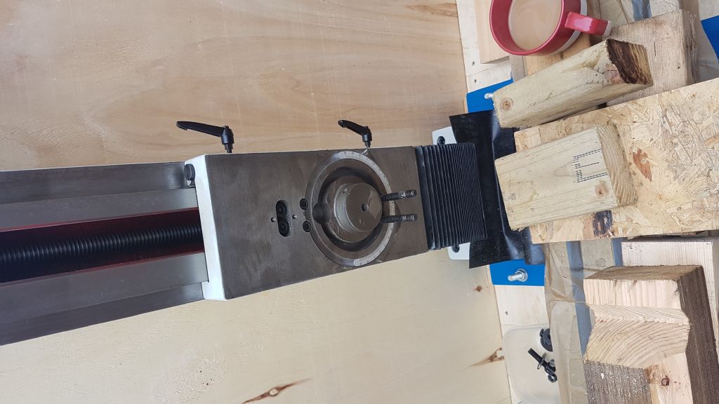

                        Yes they aren't too bad weight wise Mart, heavier than I would like and the column took me by suprise when i undid all the bolts and a the gas ram nearly knocked me over but getting there. I can only see 2 issues that are going to cause me some real trouble. Re- attaching the gas ram as the thing is really strong, I couldn't move it when I tried earlier and getting the y axis off as the gib is really stuck in there.

                          It's a taper gib so only comes out one way.

                              Look closely at the ends, one will be larger than the other. Big end pulls out though you should be able to slide the whole thing off with key in place. leadscrew nut probably needs removing from underneath.

                                Thanks Jason, Y axis lead nut has been removed, could see that it was probably going to hit. will have a look at the 2 ends though. I bet i've tried to get it out the wrong way, place your bets guys and gals. lol

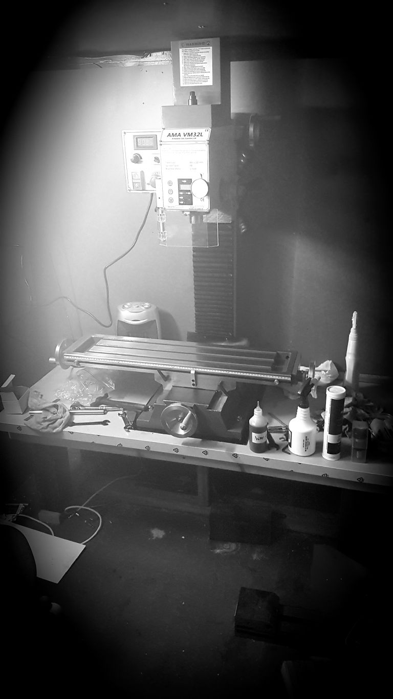

                                  Well it's took 5 days to get to this point. Dismantling, making a bench, bit of wiring, cleaning, oiling, and reassembling but I got there in the end so thank you all for the guidance along the way. Tramming starts tomorrow.

                                    Great news, congratulations, you've got your Christmas present early.
