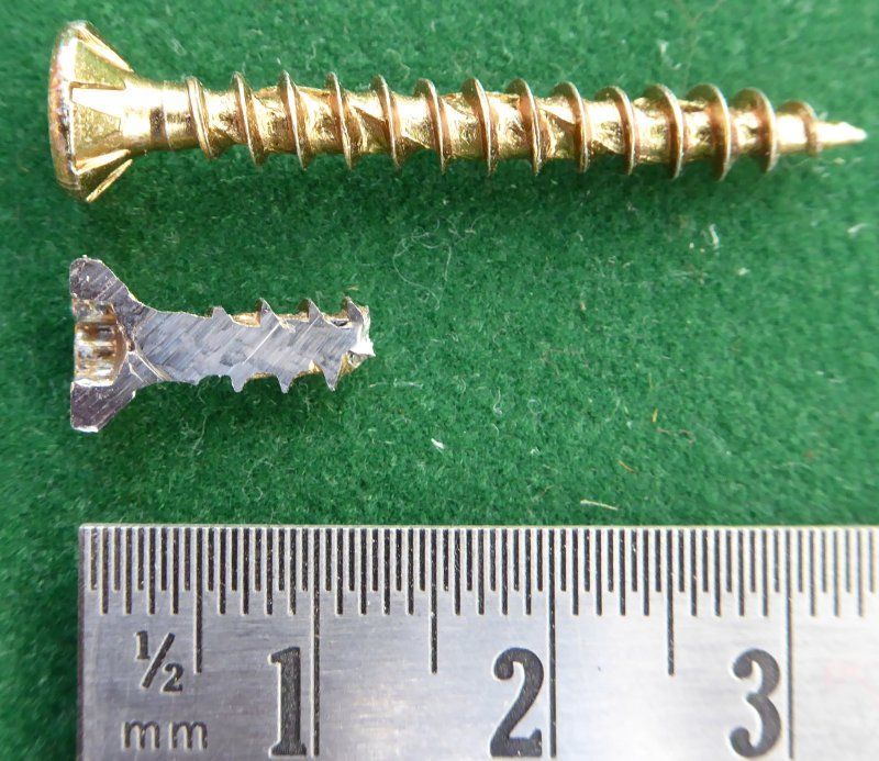

      1. Don’t try this at home (else really at your risk): metal cutting.
      I recently finished making a crosscut sled for my home-made woodworking table saw; the final operation was to mount the sled onto the saw in order to cut its own clearance slot for the sawblade. I accidentally found that some idiot embarrassed had assembled the sled with a woodscrew in the line of the blade: there was a sudden minor shower of sparks, remarkably little mechanical resistance, and the screw was very quickly and neatly sectioned! After digging out the remains, a part of the screw is shown in the middle of the picture below. The screw is a ‘Torx-Fast’ part from Toolstation, and is expected to be reasonably hard.
      I was surprised to find no obvious damage to the (fairly expensive) sawblade. It has 80 carbide-tipped teeth, 250mm diameter, spinning at nominally 4350rpm. So approximately 5800 teeth per second at a surface speed of 205km/hr, or 128mph. The cutter speed of over 11,000 feet per minute is rather faster than I normally use for steel! Something had to give way; I am glad it was the screw.
      Whilst I ‘got away with it’ this time, I would not recommend using one’s best sawblade for cutting steel, but it might be worth considering for softer metals? I think the very high cutting speed is probably critical for this use.
