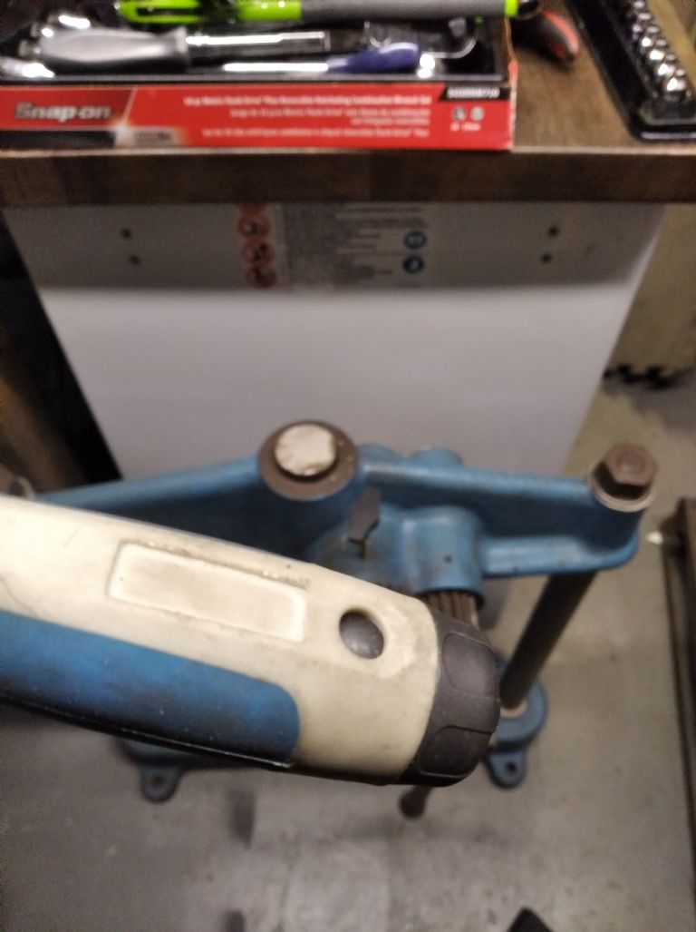

                    Vic
                      @vic
                      Are these any good for holes in round bars? I’ve thought about buying a Noga for just this purpose but the price put me off a little in case it didn’t work.

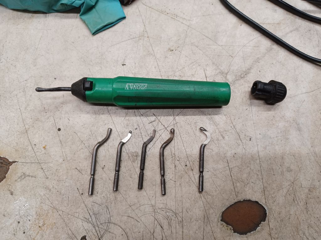

                      Vic
                        @vic
                        I’ve pulled the trigger on a Noga set with 3 different blades. Any recommendations for blade types and good places to buy them? Do other brands like the SwissBurr blades fit the Noga handle?

                                      Vic
                                        @vic
                                        I understand the patent issue, I’m just surprised it’s such an exact copy? Others make handles that are clearly the same type of thing but at least they changed the colour etc.

                                                    Vic
                                                      @vic
                                                      I finally got round to actually using the Noga I bought today. It worked extremely well on what was a tricky part to deburr. I should have bought one years ago!
