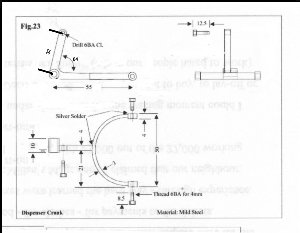

                  PS Drawings in 4408 look beter just need the angle for teh displacer crank in Fig 23 its shown as a strange 34+

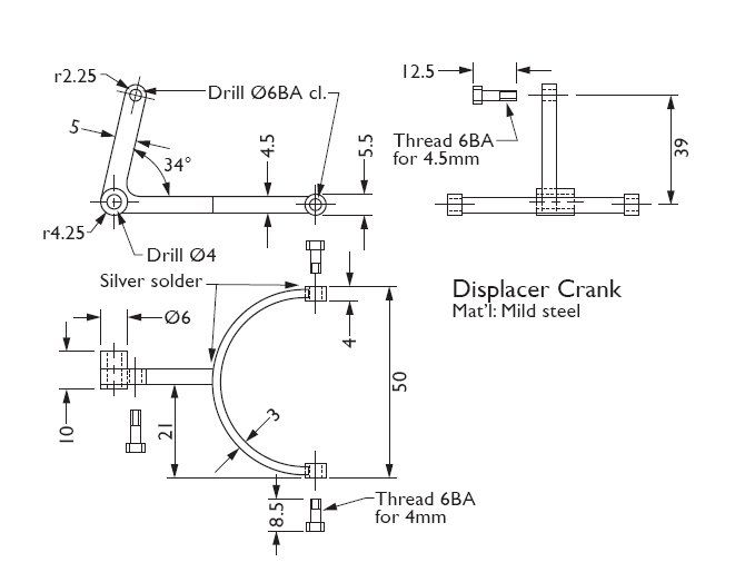

                  David Clark 13
                    @davidclark13
                    Hi There
                    This is the drawing I aproved for press.
                    As you can see it clearly says 34 degrees.
                    It has obviously been changed by the page design software.
                    I will get this checked on Monday.
                    Probably to do with the fonts used.
                    regards David
                    Edited By David Clark 1 on 09/07/2011 14:44:55
                    #71570
                      Yes could well have scanned in 84 and got 34 out.
                      Thanks, J

                        I get that angle at 77 degrees by tracing over it.
                        Martin.

                          Looks like it could also do with a dimension between the fork holes and the 4mm hole while you are at it David, as yw long teh lower arm should be without a lot of calculation

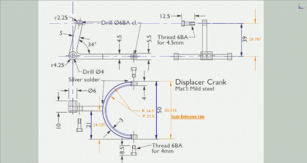

                                            As a little test, I’ve roughly scaled the drawing to the 50mm reference line and overlayed a few arcs and lines with their actual dimensions and some are pretty far out, as can be seen in the picture.
                                            The large arc is ok, but the smaller one is not so good when compared to the theoretically correct one I’ve put in.
                                            The 21mm measurement is miles out, as is the 39mm one.
                                            I know we don’t scale from the drawing, but it should bear a closer resemblance to reality than this one appears to.
                                            Martin.

                                              At the risk of these errors getting lost in another epic drawing standards thread could I ask that we keep this thread to the actual errors so its easier for future builders to locate corrections. Having said that….
                                              Sid, the use of “Plan” comes from my construction background where the view from above is generally termed the Plan View, from the side Elevations and rarely from below would be inverted plan. What I was saying is they are consistant in as much as all the drawings for this engine in both 4407 & 4408 use the same mixed projection eg 3rd angle for the elevations with what should be the 3rd angle view from above placed below the elevations rather than above. Still could be worse, the Rina has one drawing in 1st and the other in 3rd, now that is inconsistant.
                                              Martin thanks for taking the time to draw the part out and it does raise the point that without a drawing being drawn in proportion its very hard to spot if a dimension has been printed wrongly. A point for David to take up with Stavros the illustrator.
                                              Interesting that the 39mm is so far out, if it were drawn the correct length then it may mean the angle is supposed to be 84deg as I suggested rather than the 77 it measures off the drawing

                                                The text says the centre bar is offset, so the 21 is probably correct.
                                                The drawings may not be to scale.
                                                The drawings are made from the originals and if they are not supplied to scale they will not be redrawn to scale.
                                                The same goes for projection.
                                                We have time to tidy up what we get, we don’t have time to redraw and redesign everything.
                                                If we did that, we would have to make another model to prove the dimensions.
                                                regards David

                                                  .The 34 degree angle should be a reference dimension and the position of the 6BA clearance hole should be dimensioned relative to the X-Y axis.
                                                  Edited By Eric Cox on 10/07/2011 10:26:18
                                                  Edited By Eric Cox on 10/07/2011 10:35:49
                                                  #71624
                                                    I would have thought that the curved dimension line indicates that it should be an angular measurement.
                                                    But agree that teh hole could be positioned using teh 39mm and a second dimension fort teh other axis.

                                                    David Clark 13
                                                      @davidclark13
                                                      Hi There
                                                      Updated dimensions.
                                                      84 is correct measured from original.
                                                      regards david
