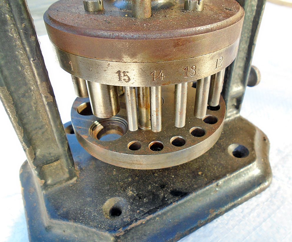

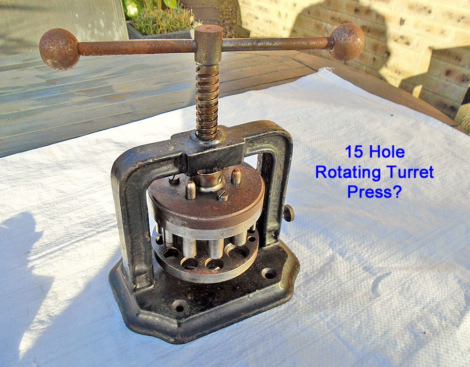

      Here we have a very well made rotary turret screw press item with 15 different sized holes and plungers with a locking screw at the side.
      The plungers seem to have a small amount of clearance in the holes.
      No ID anywhere on the tool that I have found so far but it is quite grubby.
      Not sure whether to lean towards leather working or jewellers trade?
      Any thoughts welcome!
      Cheers, Martin

            Do the punch and die plates rotate together, in other words are they keyed to each other?

              Maybe a ammo reloading press

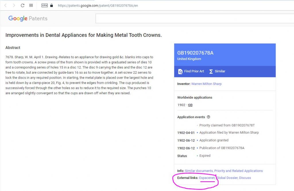

                I've no idea if this ID is correct, but could it be a dental press?
                https://mcleodhistory.pastperfectonline.com/webobject/0D8A867C-28B1-4D65-A226-428217916246
                Some in the US would seem to be made by WM Sharp, and one gets a mention on P 110 of this document (P117 of the pdf)
                https://www.tmd.ac.jp/files/topics/40387_ext_04_5.pdf
                Bill
                Edited By peak4 on 09/01/2023 16:45:33

                    It looks like they made long straight ones as well as this round variety, see P16 of this pdf
                    https://www.qmc-sabahalsalem.com/wp-content/uploads/2019/01/museum-Digital-Book.pdf
                    This is a start for your patent searches
                    https://patents.google.com/patent/GB190207678A/en
                    Bill
                    Edited By peak4 on 09/01/2023 16:58:06
                    #628340
                    Martin King 2
                      @martinking2
                      Bill,
                      problem solved! Well done Bill, thanks so much for that stunning research.
                      what along, drawn out process the crown making is.
                      cheers, Martin

                        Ian P
                        to answer your question, they do rotate in synch
                        Martin

                          #628349
                            Posted by peak4 on 09/01/2023 16:48:47:
                            Bill
                            Not sure I understand the comment, Bill
                            There is a hyperlink on ‘your’ page … direct to Espacenet
                            … Job done, isn’t it ?

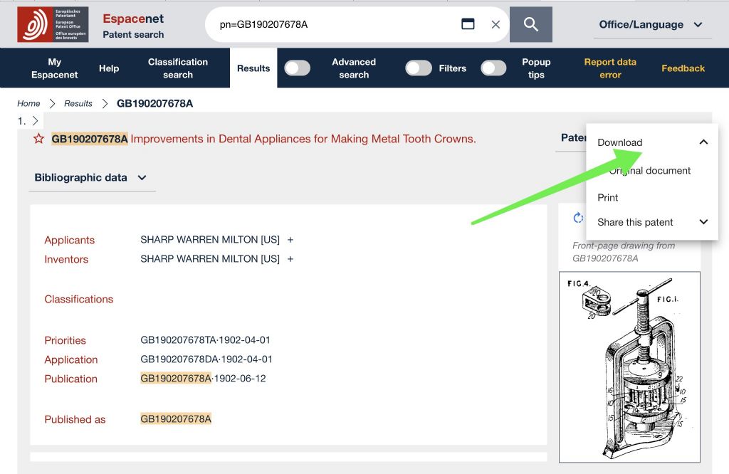

                              #628361
                                Is it safe to assume this is much smaller than the photo makes it appear?
                                (Unless it is for horse's teeth…)
                                #628364
                                  Posted by peak4 on 09/01/2023 18:35:31:
                                  but as far as I could make it work, it only shows an abstract, rather than the details of the actual patent.
                                  that is, there's some words and a description there, but the diagrams etc seem to be missing.
                                  Aha !
                                  You need to know how to drive Espacenet
                                  There is a 3-dot icon, which opens a menu … one item being Download
                                  Wait a few moments and I will add a screenshot:
                                  Edited By Michael Gilligan on 09/01/2023 20:13:56
                                  #628365
                                  peak4
                                    @peak4
                                    Posted by Michael Gilligan on 09/01/2023 20:08:26:
                                    Aha !
                                    Sussed what was going on now.
                                    On the page I linked to, there was a section for External Links, one of which is to Espacenet, (along with Global Dossier, and Discuss.)
                                    Unfortunately when I tried it earlier, all it took me to was a blank white page.
                                    I'm using Opera as a browser on W10, and for some reason, occasionally hyperlinks don't open correctly, returning just a blank page, sometimes with just a few adverts.
                                    On closing that new tab, and re-clicking the original link, the full page is then usually displayed.
                                    This time it didn't work, but re-booting Opera now allows me to get to the patent.
                                    I was getting stuck before I even got as far as your screenshot
                                    This link took me to a blank page.
                                    Cheers
                                    Bill

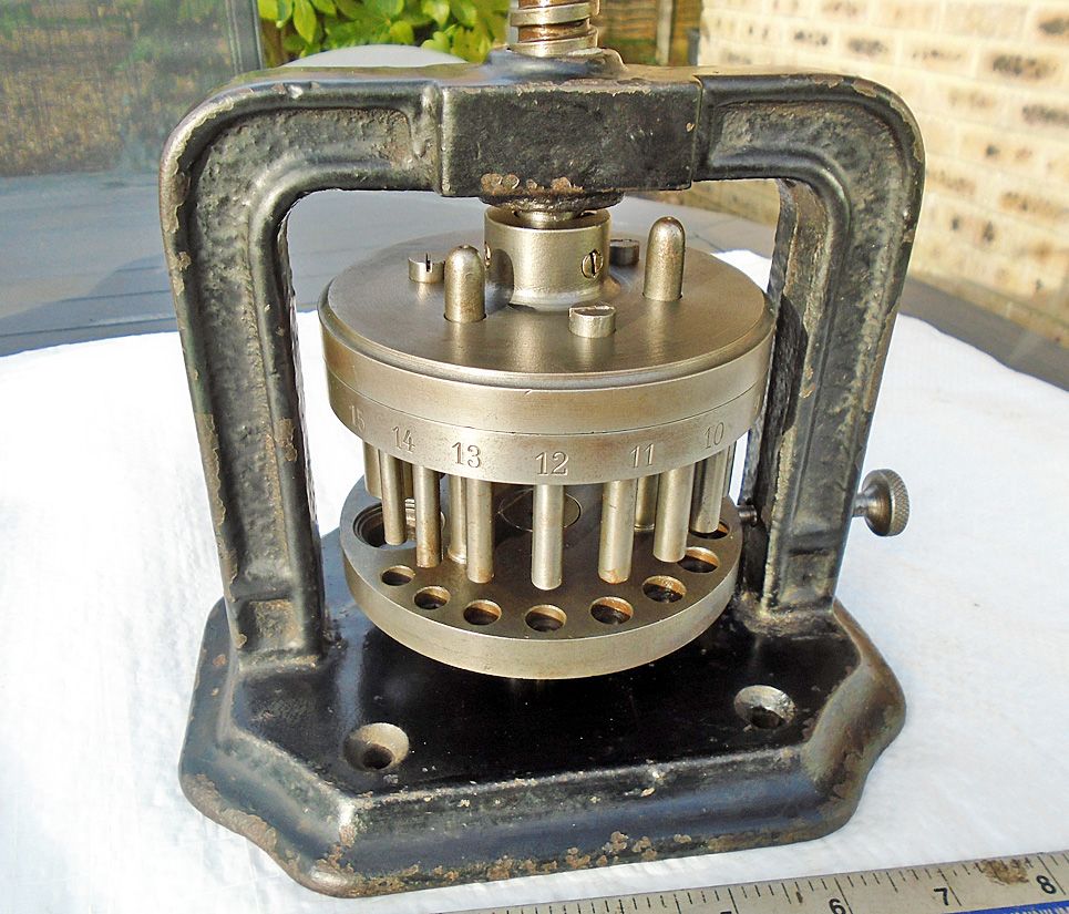

                                      Hi All,
                                      Now all cleaned up and working as it should:
                                      Neil: the largest plunger is 16.5mm diameter; the smallest is just over 5mm; the idea was too gradually draw down a thin disc of pure gold into a "jacket" that could then form the outside of the crown.
                                      Different sized plungers for different sized teeth.
                                      It involved lots of annealing I suspect?
                                      Thanks again for all the help here.
                                      Cheers, Martin
                                      #628700
                                      old mart
                                        @oldmart
                                        Gold is one of the most ductile and malleable metals, I don't think it requires annealing.
