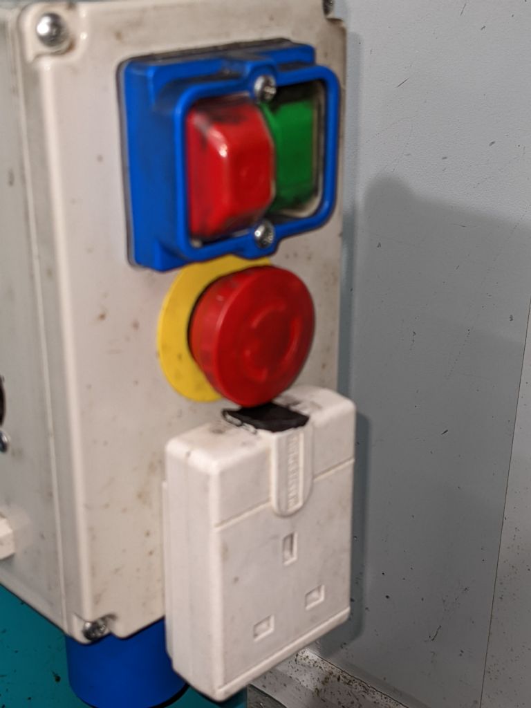

      Afternoon all. I've got one of these on order for my Super7 and, absent detailed information from NT like a downloadable manual, I was wondering if anyone could help me with a query please.
      The lathe in question is CNC'd and I would like to have a single e-stop to halt the CNC and the lathe motor. I gather from NT that they don't have any spare contacts on the internal e-stop to bring out and anyway the warranty would be void if the box is opened.
      The alternative is to have an external e-stop that just turns off the power to the drive as well as halting the CNC system. I have the usual NVR starter/estop switch for the Myford which will be redundant when the NT unit is fitted, this could supply the NT drive as well as operating a suitable relay to feed an e-stop to the CNC.
      So my question is, does anyone know what the NT estop function is, does it just operate on the mains or is it more intelligent (e.g. braking the motor quickly)?
      Thanks in anticipation!

            I have the NT CL750 package on my S7. I just did a quick subjective comparison between the estop and normal red stop button and there seemed to be no difference.

                      Thanks for the information everyone. I've now got a pdf of the manual and it confirms that the estop removes all power from the inverter so the motor coasts to a stop. So an external estop should do the job, switching the supply off and also generating an estop signal for the controller.

                                  Quite possibly Mike, but that is not what I am proposing. The internal estop clearly just removes the supply from the inverter/motor. Connecting another switch in series with the supply to the unit does exactly the same thing.
                                  From the manual…
                                  "Emergency Stop.
                                  Pushing this will cut off all power to the inverter and the machine will coast to a standstill. To release the stop button, the head is turned clockwise allowing it to return to its’ normal position. The machine can then be restarted with the green start button."

                                    Just to finish this off, I have adapted the original lathe switch box by removing the reverser and fitting a 13 socket to the front with the "e-stopped" supply brought out to this from the contactor. Also across the switched output is an opto-isolated sensor that gives a logic "low" when the output mains is "on" to the estop input to the CNC BoB. This is on a little board from a supplier on eBay. Box mounted on the RHS of the lathe cabinet, the NT box will mount where this used to be.

                                        I'm struggling to understand what you're getting at here Mike. It's clear from their manual that the NT estop just switches off the mains supply to the inverter, nothing else! I suspect that there is also an NVR function of some sort since normally the box just replaces the normal Myford unit.
                                        So what I am doing is simply replicating their estop function with a switch upstream. So there are two estop buttons that DO EXACTLY THE SAME THING as far as the drive is concerned.
                                        Just in case it isn't clear, in normal operation the estop WILL NOT BE USED to stop the motor, only the stop button on the NT controller.
