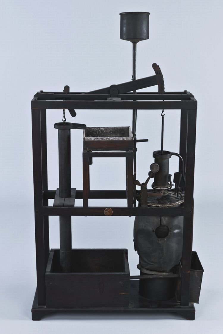

          Might be of interest to some. I'm on chapter III of Andrew Carnegie's biography of James Watt, and I've stumbled on some info regarding a model Newcomen engine.
          The short of it, while working at Glasgow university Watt found out (in 1771) that the university had purchased a model of Newcomen's engine but it had been sent to London for repairs. He promptly raised funds and requested its return. Unfortunately the model could not go past a few strokes of the piston before stopping; the same issues regarding scaling down alluded to in this thread, perhaps.
          From what I can gather it's on display today at the Hunterian Museum. I wonder if it's ever tested or fired up. I did try and find out online but to no avail.

            #613566
              I’m sure Jason could knock-out a replica from this image:
              Credit: https://jameswatt.scot/2019/08/20/newcomen-award/
              #613576
              Michael Moore
                @michaelmoore38916
                Good one, Michael.
                I'm reading that Sisson, who supposedly manufactured that model, went bankrupt a number of times and even went to prison for failing to cough up money.
                On reading about these tinkerers and innovators of the early industrial revolution, I'm struck by how many ended their days in poverty. It seems Sisson fared well in the end but many did not.
