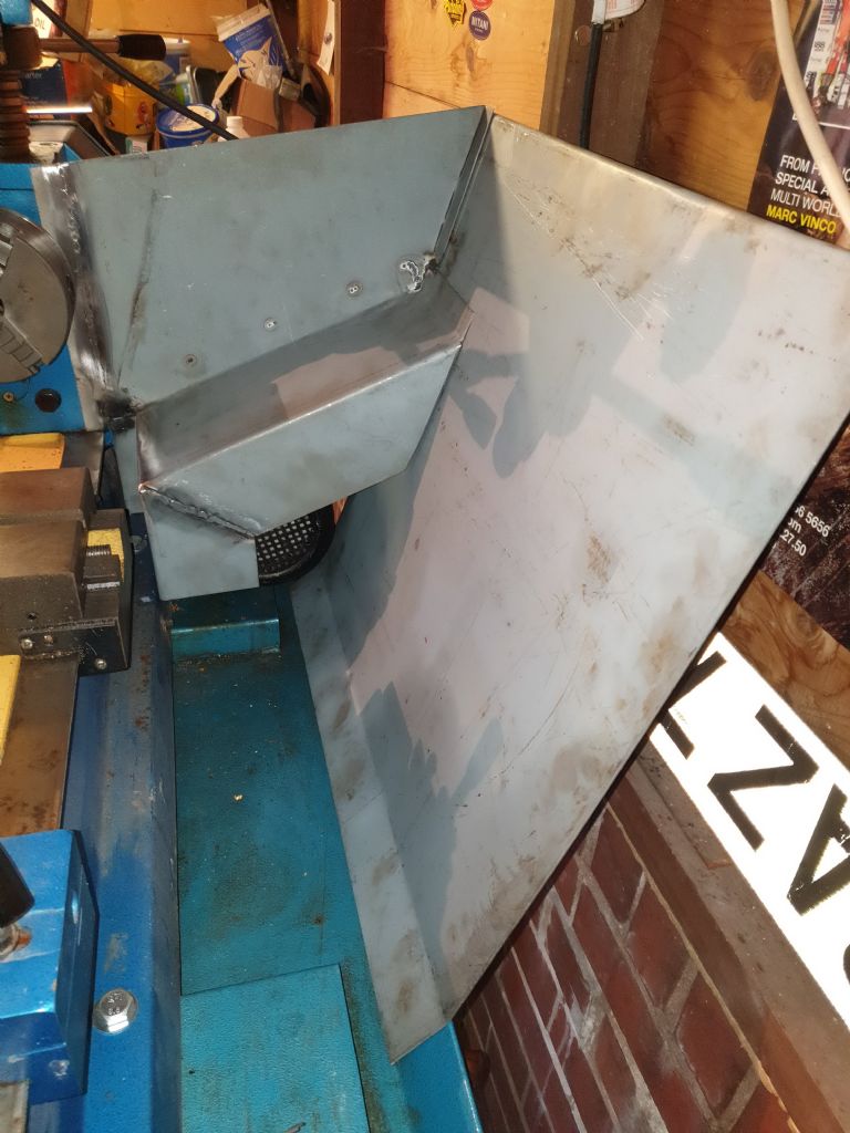

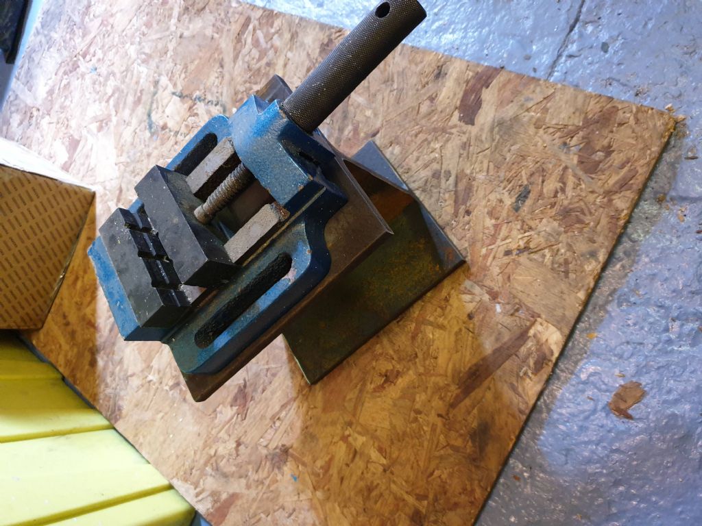

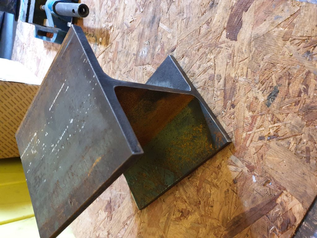

              So the Splash Guard is done. Just need to paint and fasten it proper.
              Also, I went for a lump of FOC I-section instead giving Clarke £75. I'll see how I get on when Ive got it fastened down.
              Not: Clarke shite vice for demonstration purposes only.

              Howard Lewis
                @howardlewis46836
                The H section provides the needed increase in height, and will be stiff for and aft, but not so rigid side to side
                I would suggest welding in some struts at the ends to turn it into two back to back boxes, plus some struts at the sides (Just narrow enough o allow access to the fixings )
                In this way the stiffness will increase, and any distortion from welding should be taken out when the top and bottom faces are machined.
                You could even take a skim along the top of the outer edges to use as a datum face, if thought likely ever to be needed. (For Vice alignment? )
                Howard
                #546198
                Danni Burns
                  @danniburns84841
                  Thanks again Howard
                  The skimming of edge for a datum is a great painless idea. Will ease setting up.
                  I'll get the fixings in place and think about those struts. Not used the miller yet, but from comments I've seen about stability of the machine when milling, that may be the least of my problems.
                  Cheers

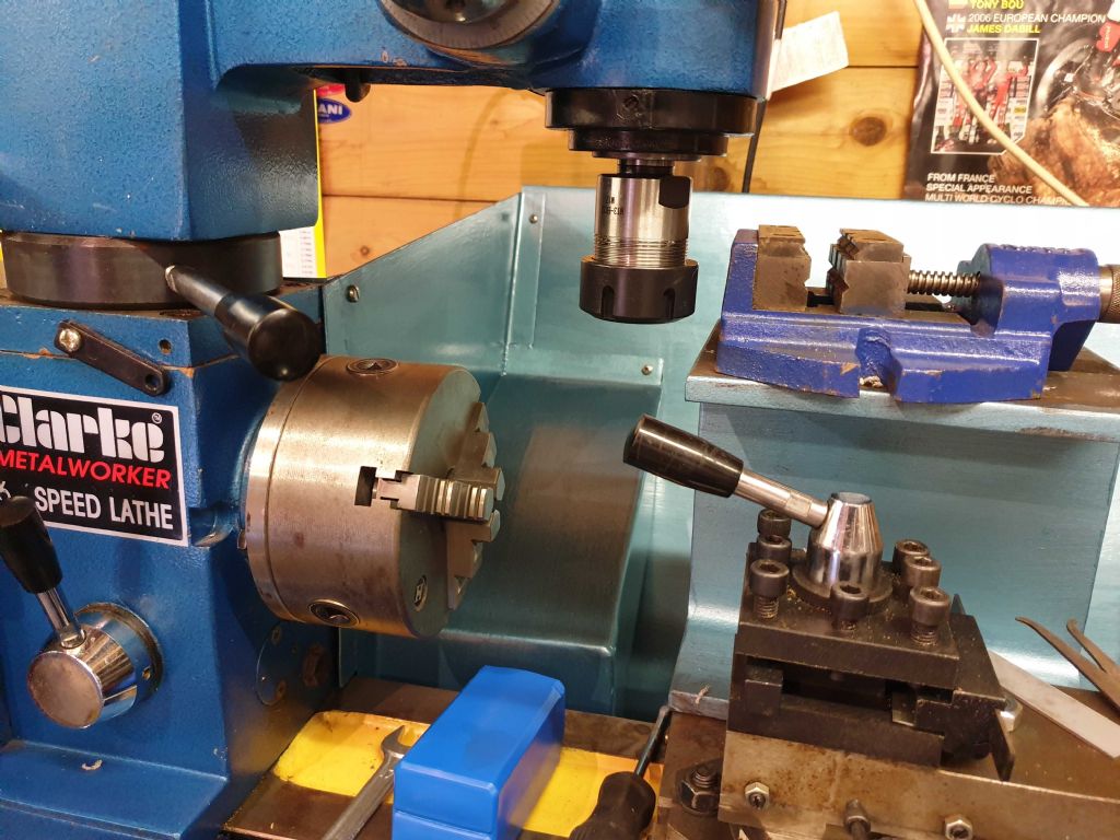

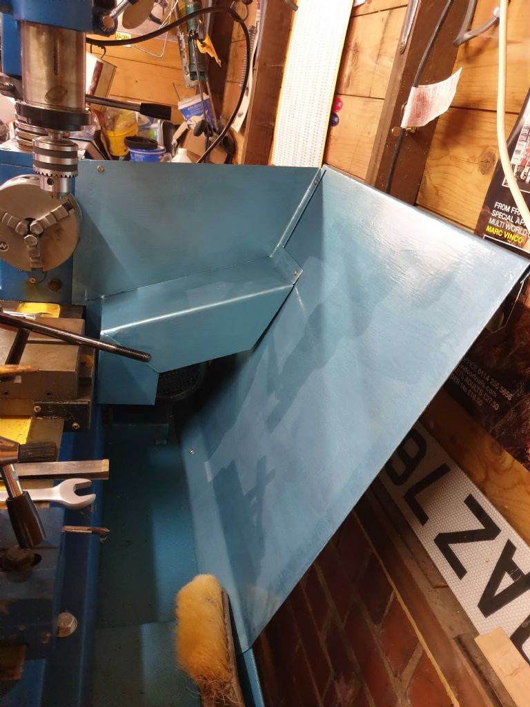

                  #547543
                  Danni Burns
                    @danniburns84841
                    Hi guys
                    I thought I would update on the Splash Guard.
                    I do beg your forgiveness for the bloody mess.
                    As you can see I'm trying to sort milling stuff out and looks like that I-section is looking well too high (and therefore the £80 Clarke block would be even less suitable). Looks like I need 4" height max if I'm going to use it as low as poss and locked-up to avoid vibrations – as it should be I guess.
                    Any comments – Im happy to take them onboard.
