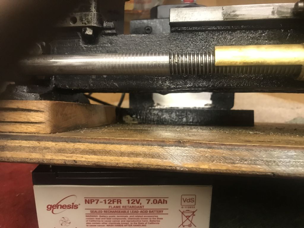

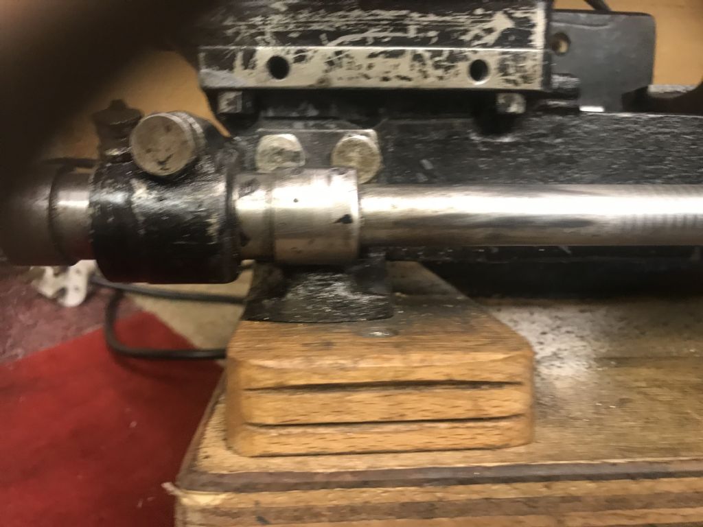

      Could you post a photo of the lower bed and feet please? The underneath is often more distinctive than the more-or-less similar gubbins on top, examples from lathes.co.uk:

      MickB
        @mickb25219

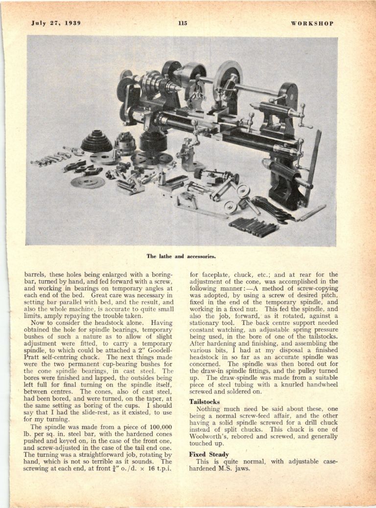

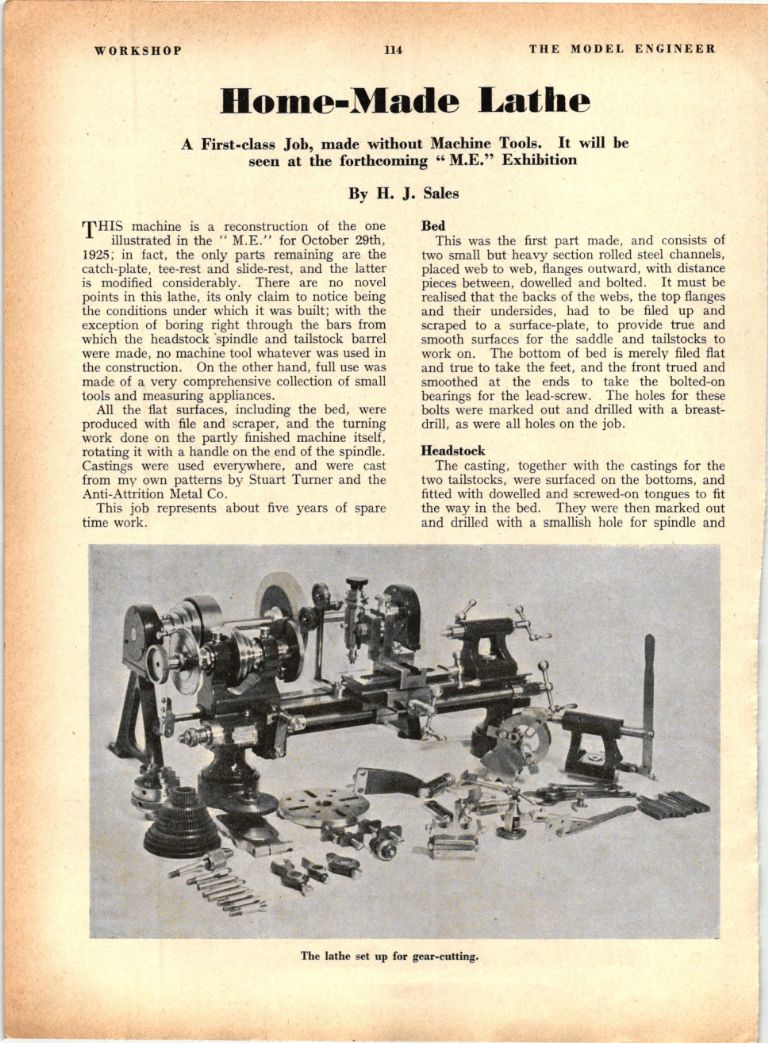

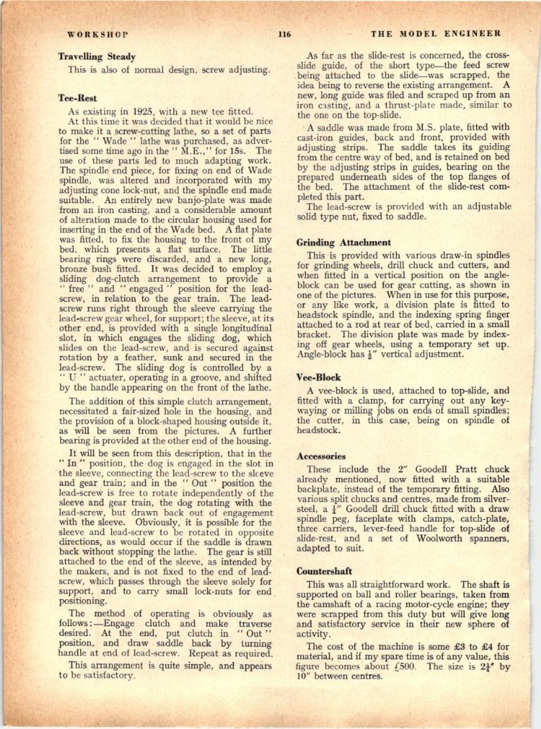

                              It's a bit strange that no-one has pinned this one down yet because it seems to be constructed from proper castings, even the faceplate looks like a proper machined casting

                                  The standard of work would get a mention in the ME if it was one of the usual suspects who made it
