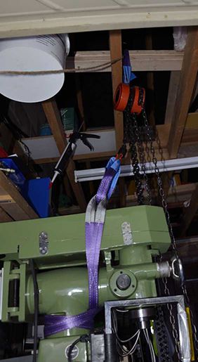

                                    Some weeks ago I mentioned that I had ordered a new lathe, Warco 280v-F.
                                    Some days later a ordered a new VMC mill, which has now arrived and has been positioned, but I am still awaiting the lathe.
                                    Pictures of the VMC are in my album.Luckily the flooring joists took the load.
