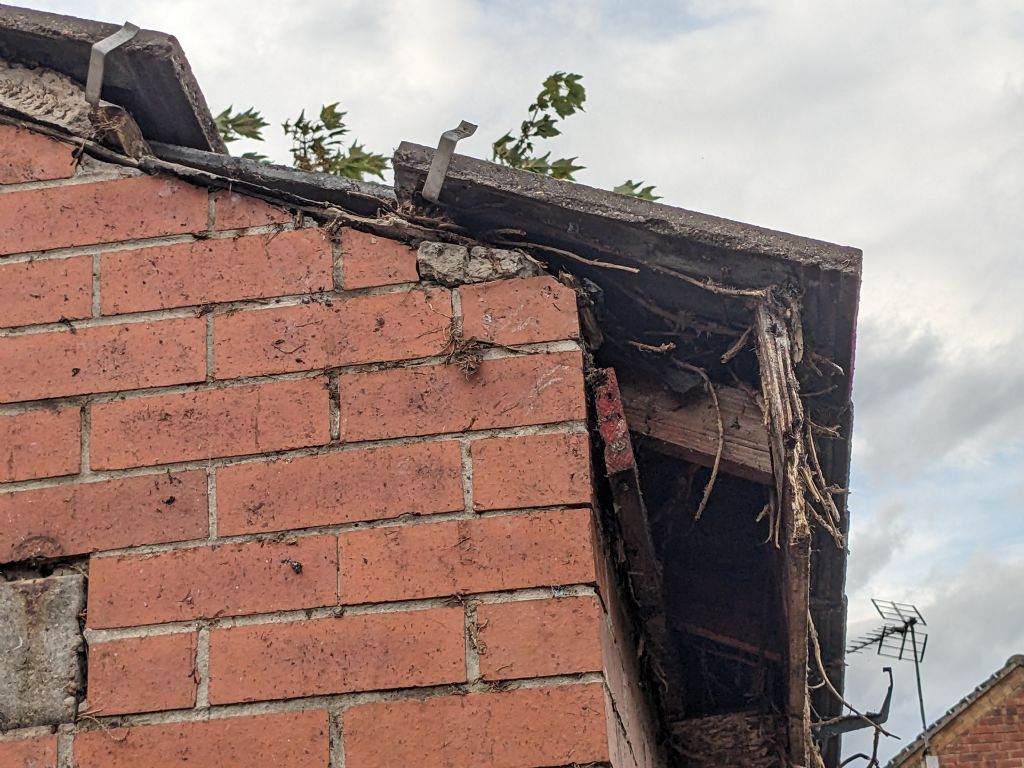

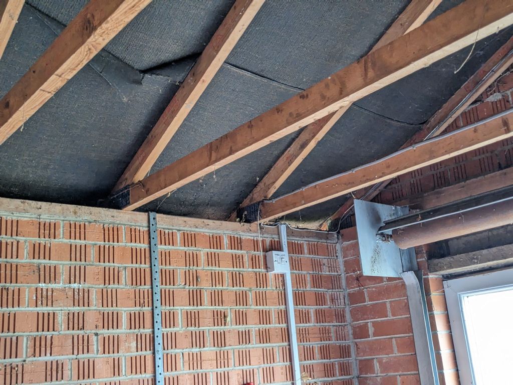

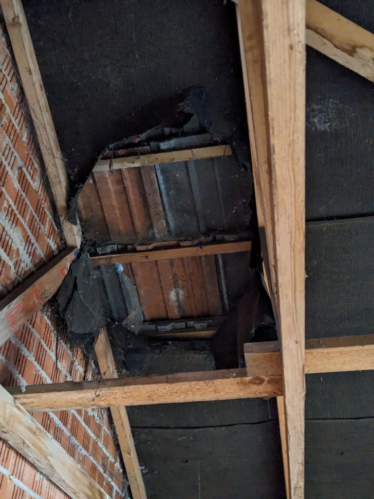

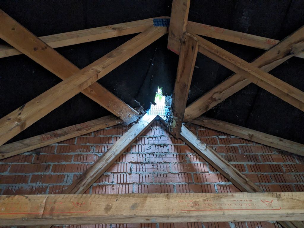

                              Thanks for the advice so far everyone. The roof has been heavily damaged by ivy and I feel it is well beyond simple repairs. My plan is to remove the tiles, re-felt and fit a dry verge. The pictures below show the condition.
                              Picture 2Picture 3Picture 4Picture 1

                                    A note of caution with respect to the single skin brick wall. Many years ago I had a similar construction and found that water penetration, especially with driving rain, was extraordinary, i.e. water running down the inside of the walls. The type of clay brick used was an issue but the problem will occur to some extent with any single leaf masonry wall. Use of a clear sealant on the external surfaces helped to a great extent but was not perfect.
                                    In your situation, in addition to sealing the external surface, I would suggest a waterproof membrane on the inside. This could be a brush on type or sheet foil followed by battens and an inner skin comprised of ply, particle board or similar – moisture proof for preference.
                                    I have no issues with concrete floors re comfort ( where there is no sense there is no feeling ) but depending on construction ( i.e. use of a sub-floor damp proof membrane ) this can also be a source of water ingress. A coat of paving paint or use of an epoxy coating may be required.
                                    A reflective membrane under the tiles and as much insulation as you can fit in would be highly recommended. Something lacking in my current workshop, which is double brick and has fully addressed the moisture problem associated with brick walls, which gets very hot in summer ( Australia ) and surprisingly cold in winter.
                                    You will need to assess your own situation and local conditions in assessing which actions will give the greatest benefit.

                                      Replace the sarking felt where it is damaged and then use 4" of rock wool insulation (use the one with paper attached) underneath that. Hold it in place with light wooden laths running the length of the roof.
                                      Batten a waterproof membrane to the exterior wall and then use insulated plasterboard.
                                      Up and over door needs lots of insulation, draft stopping would be advantageous.
                                      Ceiling – make it fireproof with 2 layers of plasterboard ?? but with good access for storage, but if you wanted Velux lights, scrub that idea.

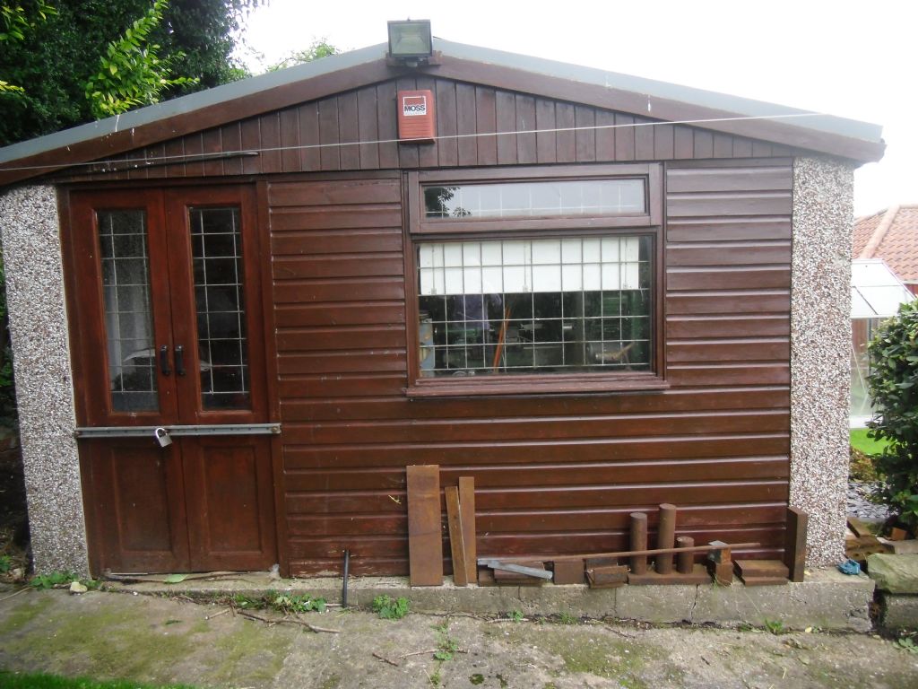

                                            Workshop front built into up-and-over door aperture.
