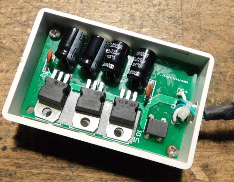

              I got these 5V PSU’s with my Warco mill. They were sort of hanging free with wires all wound up with cable ties. Luckily I was able to pull 5V off the VFD and lose them. All neat, works a treat X) (Experimental smiley)
              Robin
              Warco5v
