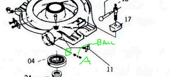

      Hi, after completeing and threading the holes(a lot) on the Disc I made clamps(Various) 8mm bolt size for use to RT Vetex-HV-6 model, 3x slots.
      Stops made:
      I then decided to make two adjustable sliding stops which slide on the outher edge of the disc, bolted in place to privide working between two stops, milling curved slots 8mm  in it.
      It is with this operation, I realised there must be some backlash as cutter gets to end of cut and excit, where conventional milling feels like climb milling exciting the workpiece.
      Backlash experience on this RT by me:
      1-If I move the the table normally by cranking, I feel no backlash, it feels smooth, if connected a dial indicator I dont see any, but this is light load.
      2-If I mill I feel the possibility of backlash in handle, under load with cutter, I can feel the difference between climb & conventional milling here.
      3-This brings met to completing the stops and adjusting the table towards a stop, and if table stopped at 0 degrees as example by two stops, disc/table no movement, I can detect definite backlash.
      4-The “Manual/Pamflet I got with it is quality printed, and it says under “ADJUSTING MESH OF WORMGEAR” (Theres zero axial play=Another type of adjustment), it says theres a screw A-Steel Ball-Screw B to adjust this. On inspection I found one screw(A-?), no steel ball, no screw B, if A is screwd out, I can see the conentric part turning inside.
      Screw A=12mm long by 4mm allen.
      Now whatever I try I cannot get this backlash adjusted out……I can adjust it where it feels uncomportable stiff to turn, but the backlash still theres.
      Its not the end of the world, but just curious what you think. I am going to enquire as to where the ball & screw B is from seller.
      Thanks for ideas……This backlash confuse me a bit….
      #732567
        Screws and ball shown on the exploaded view, ball may be stuck in grease. Effectively it is a stop that adjusts where the eccentric stops when you turn the lever to swing the worm into mesh.
        ball
        #732627
        Chris Mate
          @chrismate31303
          Hi, If I loosen the T-Handle to release, If I feed(Try to) the dial with my hand and adjust that one screw in or out, I can see the dial moving, so there is only one grubscrew, no ball and screw B further down in. I can see the part unrestricted with light shine in 4m hole, so not sure if they change it on new one, or just a miss assembly, waiting for answer from dealer.
          So the one screw(A) 12mm long does change the backlash to a point where you get no backlash under no load like against a stop, or cutting, it indeed feel very smooth and good cranked with no load, I can adjust where it feels stiff to turn, but I can still produce the backlash againt a stop-?.
          Not sure if the main tapered bearings(maybe slight play, cannot feel anything by hand) can cause something like this-?
          Its not like on a Lathe or A Mill where you can feel the backlash with no load, easy.
