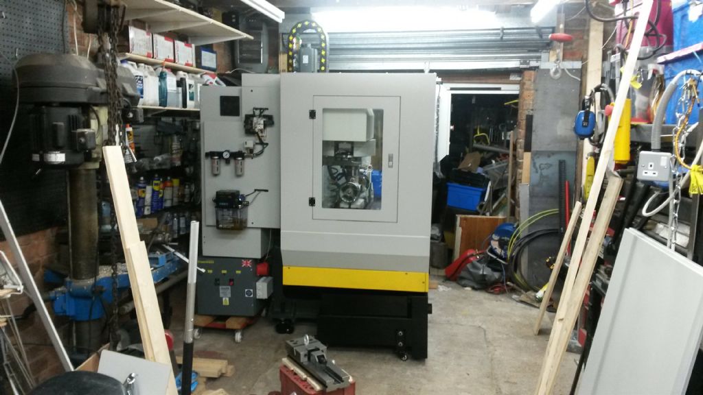

      That's it in position, just the complete rewire of the workshop to do, the cable trays are going in next week 😀

          That looks impressive, more details please.

                Looks lovely, what is it ?

                    Looks like a Syil X7 CNC mill.

                              Looks a bit contradictory to me. The loopy bit on the far end looks like an auto toolchanger carousel thingy, but the handwheel in the window shrieks 'manual'. Somebody'll maybe give us a clue eventually.

                                      It's the Syil X7 with 12 tool changer, the big 4th (that's the hand wheel on the tailstock!) , Siemens 808d Advanced controller and Siemens servos and drives, the factory were very kind in including the laser ballscrew mapping at no extra charge.
                                      The massive column and base castings were a significant part of the appeal of the X7, the absence of proprietary gubbins you can't buy elsewhere was also a consideration.
                                      I've had my nose to the grindstone replacing the shower enclosure at the behest of SWMBO this weekend and this morning, back to work on the garage today! 😀

                                            Although I did look at Tormach and Skyfire at the start of this journey I don't think the X7 is intended as competition for either, the X7 is far more rigid and massive and has a base casting, not a stand.
                                            It is my personal machine and will be used for motorcycle parts for me but I will be doing some commercial work with it, the commercial stuff is covered by NDAs so I'm not at liberty to give details without the permission of the IP owners until the products are released into the UK market.

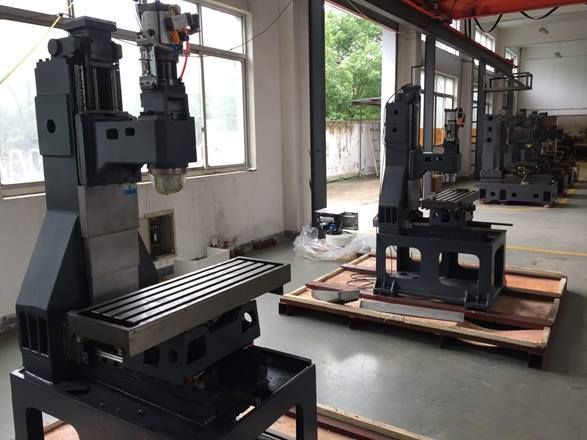

                                                    @nickhughes97026
                                                    Nice machine.
                                                    I hope the X7 is built better than my P.O.S X5 Plus.
                                                    I had to strip the X5 down completely to correct the geometry errors built in due to non existant QC at the factory!
                                                    An example here, is the Saddle. Note the top edge grinding for the X axis alignment!
                                                    No wonder I couldn't produce anything with 90 Deg corners!! This was replaced eventualy by Syil.
                                                    I only found this (and the other alignment faults) after checking the machine with a calibrated Granite Square from work.
                                                    Also I hope you have more luck dealing with Syil (Including Syil China directly), if you need any replacement parts, than I have (not for the saddle, although that was a battle, but I have tried and failed to buy some replacement electronic boards).

                                                    Nick Hulme
                                                      @nickhulme30114
                                                      Yeah, it's a shame they went through that learning process, I'm pleased to say that my X7 is as square as my DTI is able to detect and is astoundingly rigid, it almost puts the wind up you the speed it shifts material! 😀
