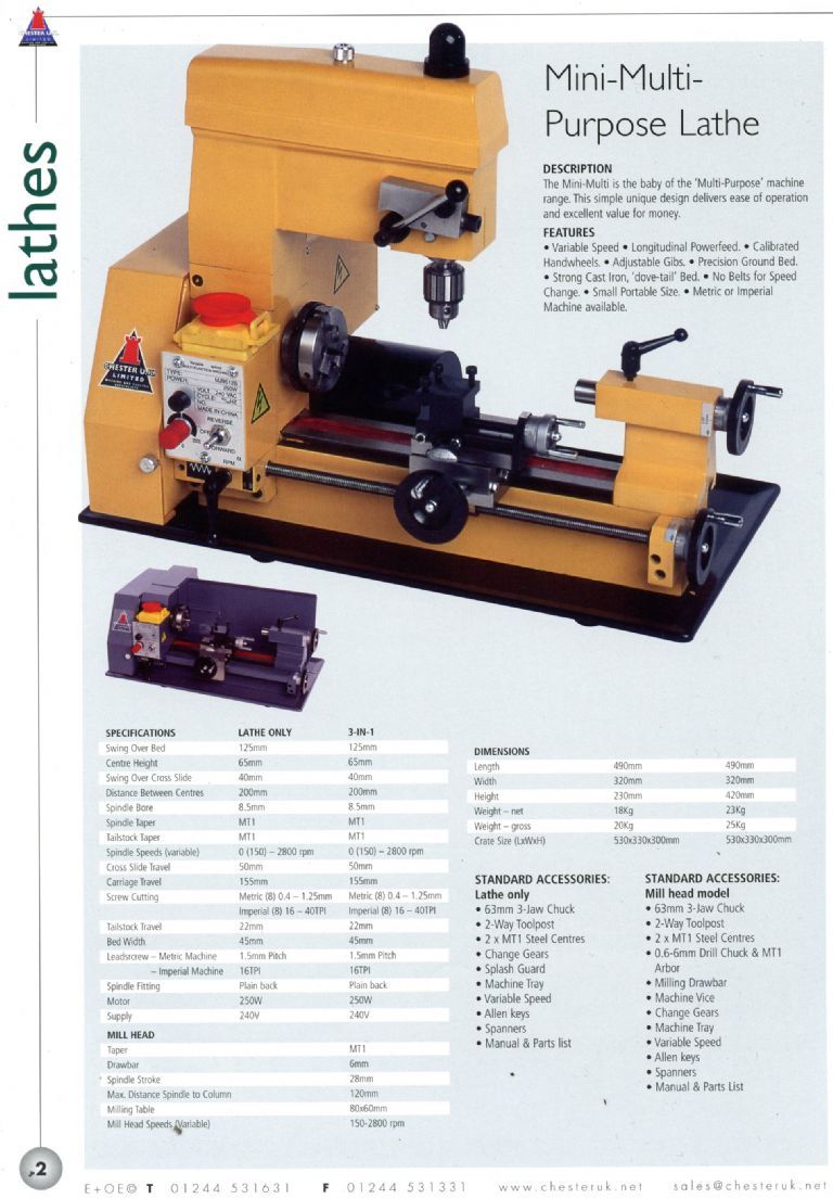

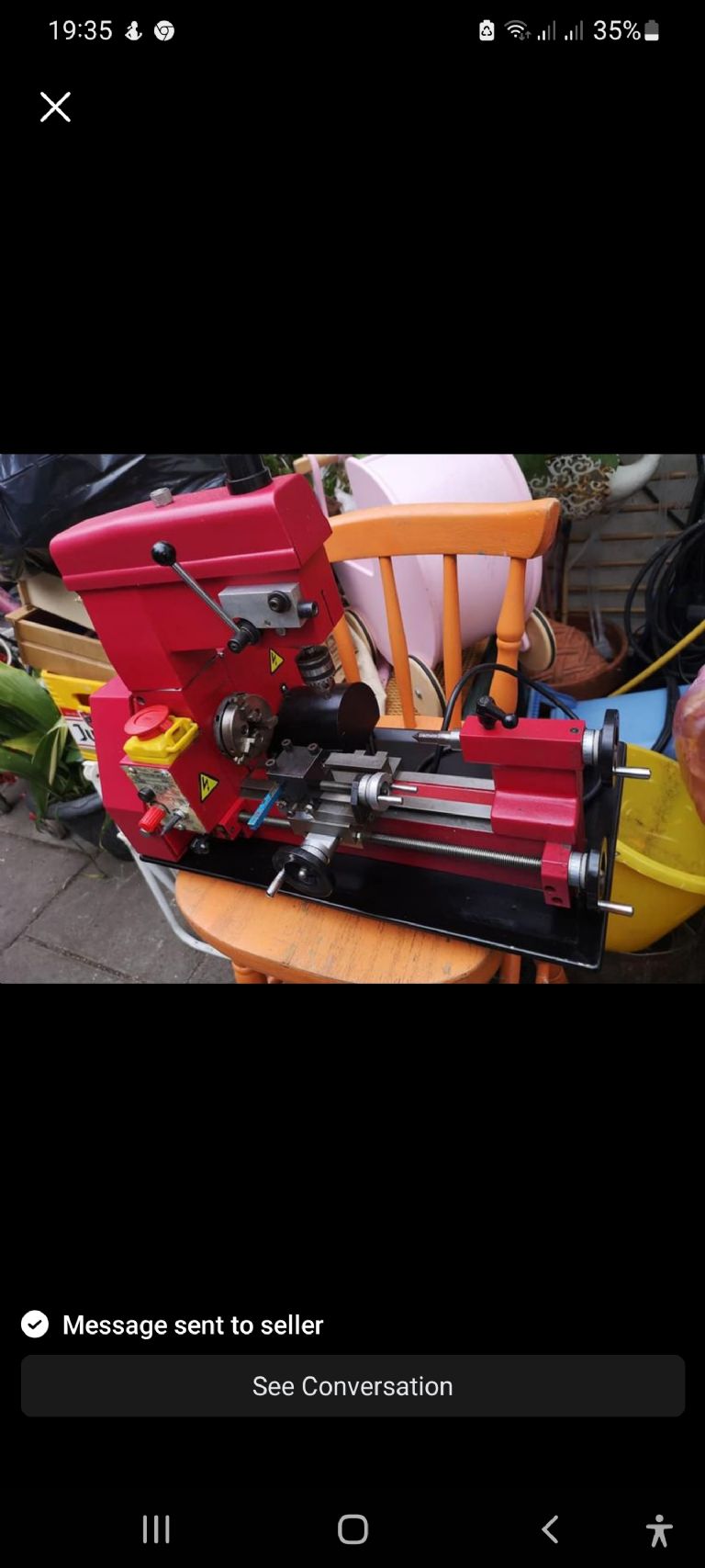

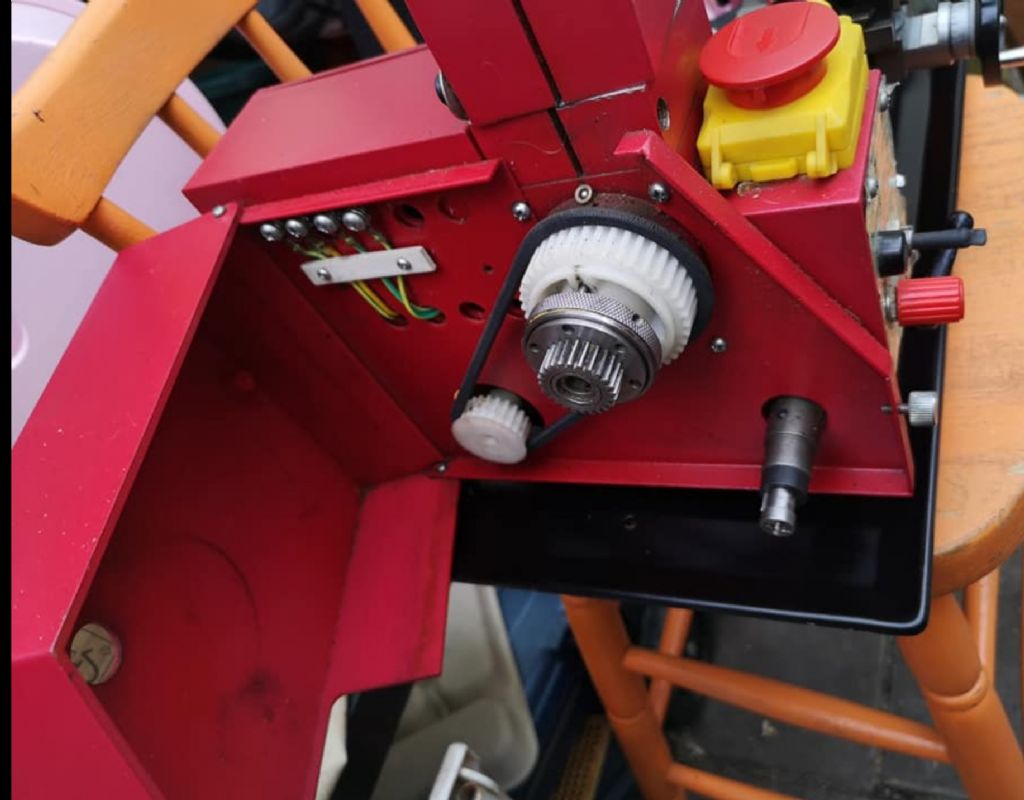

                    Please forgive my computer skills there not great , the model shown in yellow is a chester which is identical to the model I have only the colour is red and as said its missing all the gears , the only thing behind the door are the two gears and a shaft which I assume is where the missing gear fits ? .
                    I am a complete novice to this sort of work but with time on my hands I'm eager to learn as much as I can before age catches up and I start to forget all I've learnt .

                            Dats a dinky one
                            It will teach you all the basics, I would start with small bits of aluminium and mild steel
                            Knowing your machine is half the battle
                            Rule one: Eye protection
                            Never ever start her up without something on your eyes, even a £1 pair of reading glasses

                              You have done well to find data on what looks to be the Chester equivalent.
                              Since yours is painted red, it may well be a Sieg. In which case, it may be that Ketan Swali at Arc Euro Trade might be able to provide more information.
                              Looking at your pictures, to my mind in addition to a set of Change GHears, you will need:
                              A banjo, c/w with clamp This will clamp around the bush through which the leadscerew protrudes. It will have a slot to take the
                              Stud/ s (C/w clamping ) for intermediate gears

                                    The machine you have is good for indoor model railway sized work rather than clocks or traction engines. It's probably quiet enough to be used inside the house rather than needing a shed or workshop to to contain the racket and mess.
                                    The motor is small, so although it will turn, drill and mill mild-steel, it will be happier on Aluminium and Brass. Don't expect it to plough through metal in seconds! I like to drive my machines so the motor can be heard to be straining slightly, but not struggling. Patience is essential on a machine with a 250W motor, but they can do good work.
                                    Best to buy metal described as machineable or free-cutting rather than trust random scrap; quite a lot of scrap and DIY store metal doesn't machine well and small lathes are less able to deal with awkward metal than big powerful ones. My entry into the hobby was almost derailed because my collection of scrap was all rubbish!
                                    The missing change gears are annoying but not the end of the world. Most small threads are cut in the lathe by tap and die. Change wheels are only really needed for large diameter threads. A problem may be the lead-screw moving the saddle too quickly to be used as an automatic fine-feed; again annoying rather than fatal – you just have to develop a steady hand.

                                      With the high minimum speed, making and using a mandrel handle, may be a necessity for cutting threads by any means.
                                      With a machine, this small, threads are likely to be cut using Taps or Dies, rather than screw cutting so the lack of change gears may not not be that detrimental.
                                      Imagine trying to open half nuts with the lathe running at 1150 rpm. VERY quick reactions needed.
                                      The changewheels are more likely to be needed to provide a fine feed for sliding. BUT, at 1125 rpm and assuming a 20: 80/20:80 set up, the Saddle will still cover the length of the bed in a couple of seconds, by my calculations!.
                                      Maybe that's why the gears and the banjo are missing?
                                      Definitely a job for the Leadscrew handwheel to provide a longitudinal feed, in my book.
                                      Howard
                                      #610927
                                      Howard Lewis
                                        @howardlewis46836
                                        Can't read the speeds from a print of the picture!
                                        Is the minimum speed 150 rpm rather than 1150?
                                        If so, that means that the Saddle would travel at about 14 mm per minute, which is much more useable, but still quick if you were cutting a M8 thread (11 threads in a minute ) .
                                        Howard

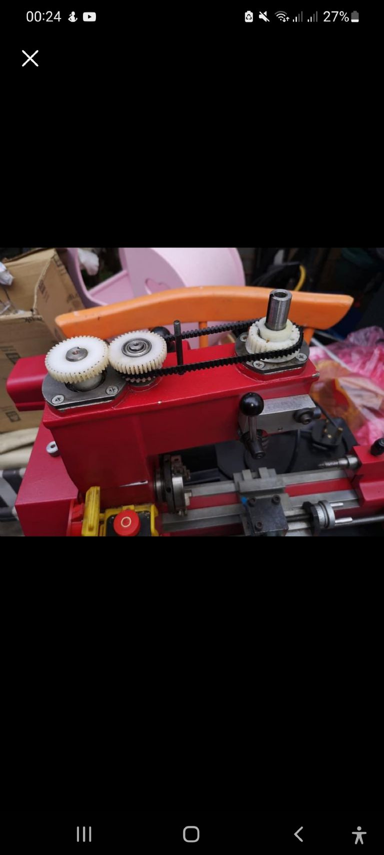

                                            Hello Martyn. From the manual the belts are 1.5 x 83 x10 for the lathe and 1.5 x 70 x 10 for the milling head. The only place that I found them was Banggood. The originals were steel belts but I got rubber ones, much cheaper.
                                            The milling head belt was far too tight on mine, I got round this by making a new pully with one tooth less.
