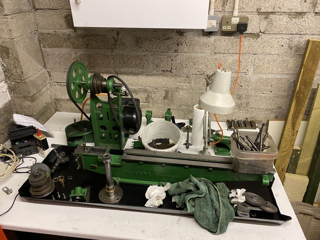

        Thanks Dave, easy peasy, I have added my pic, I will take more tomorrow and post them as well.

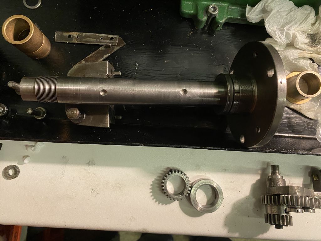

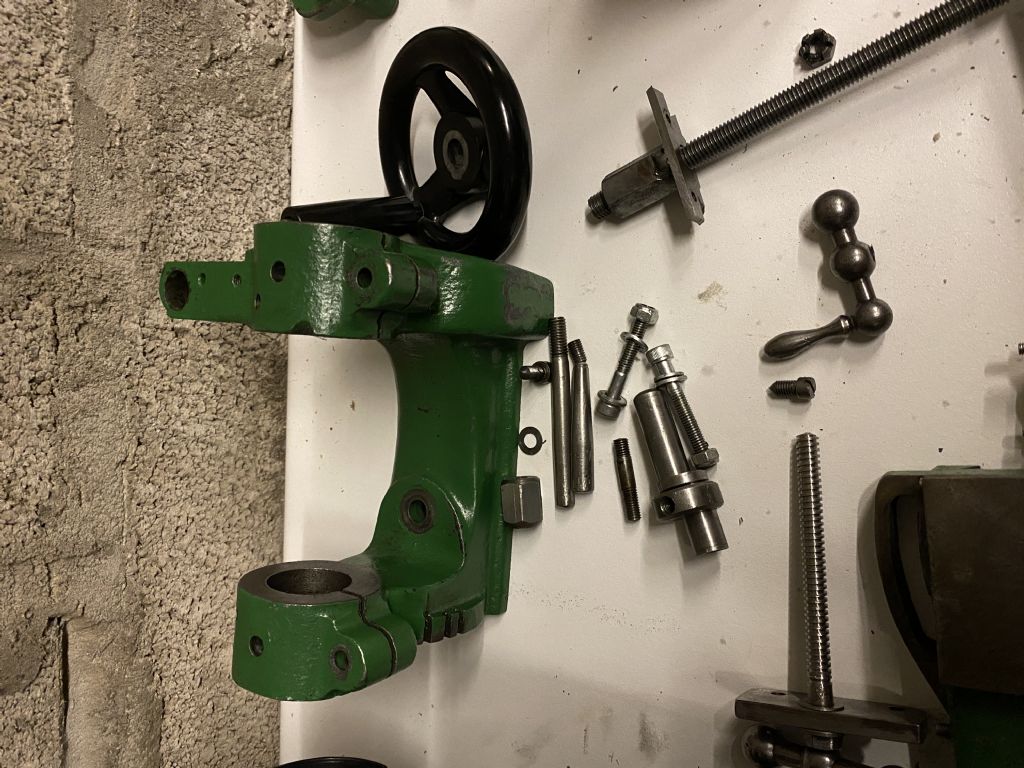

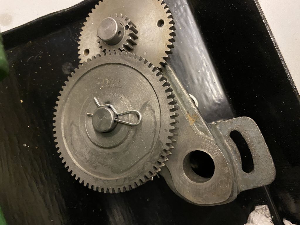

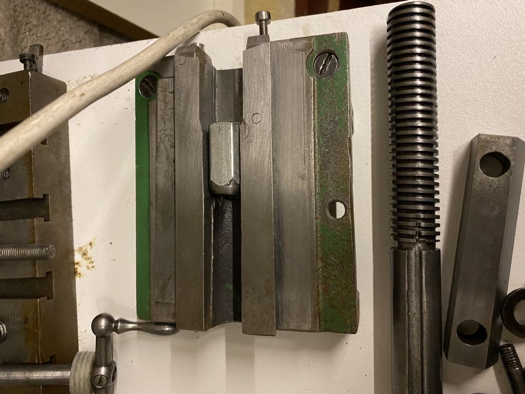

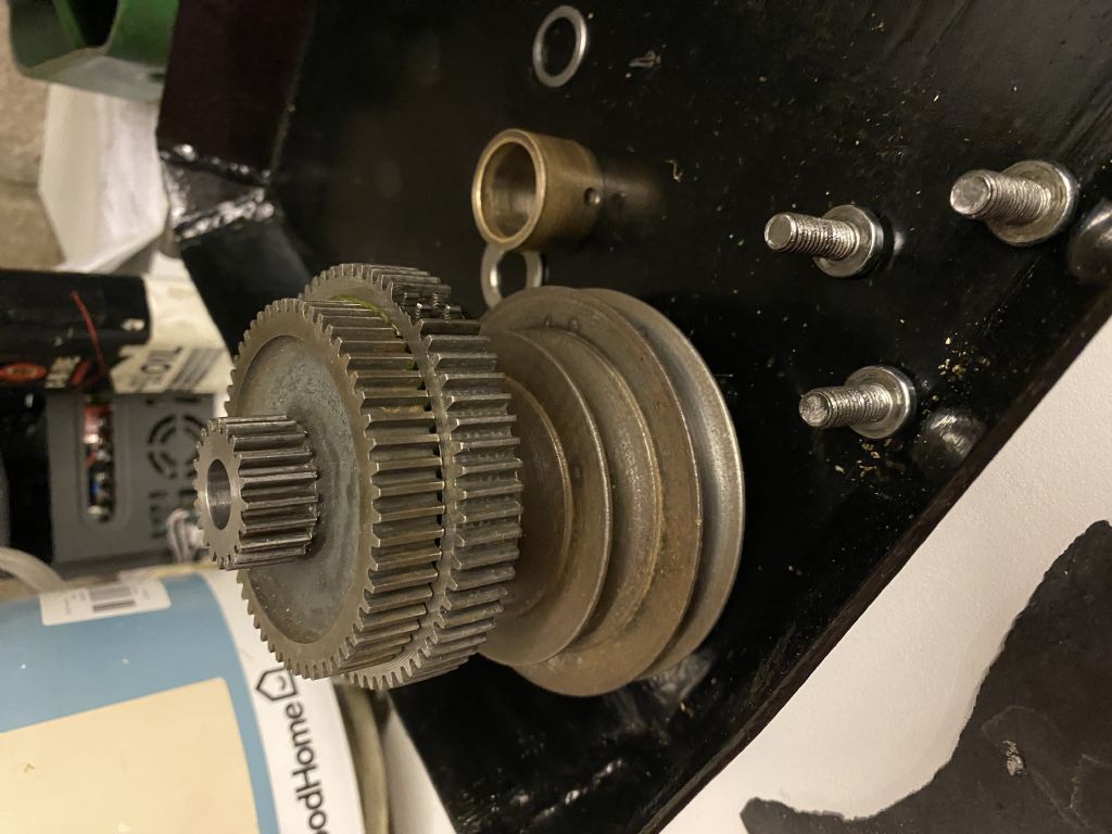

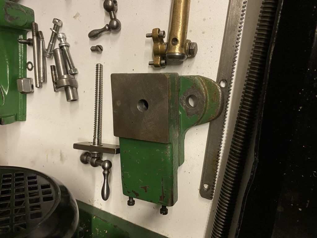

          img_6141.jpgimg_6140.jpgimg_6139.jpgimg_6138.jpgimg_6137.jpgSome more pics, hopefully someone can identify the model for me, serial number is RD3211.
          You will see one pic with a nut wedged where a screw thread should be, botched job but I have no idea what it should look like and even what it is called.

              Lathes.co.uk should have pics to identify which model you have. They also list a lot of serial numbers for some models.
              There is also a MyfordLathes group at https://groups.io/g/myfordlathes/topics that has a lot of info on older Myfords both from members postings and in the Files section. There is also a Myford Lathes Facebook page with members with earlier Myfords who may be able to help.
              The bottom pic you posted is the tumbler reverse mechanism that goes somewhere at the top of the quadrant on the headstock and engages with the gear on the end of the main headstock spindle. It's purpose is to reverse the direction of the leadscrew for cutting left hand threads or feeding left to right etc.
              A good book to give you the basic layout and terminology and how to use lathes of this vintage is The Amateurs Lathe by LH Sparey. Available I think from Tee Publishing.

                @robertatkinson2
                Hi,
                As it is a long bed and appears to have a bronze bush bearing on the headstock spindle it is a ML4.
                The damaged / repaired gear is part of the backgear system that provides low spindle speeds.
                Robert.

                  @georgineer
                  Welcome, Colin. If you haven't already done so, search this site for ML4, followed by ML3, ML2 and ML1. You will find a wealth of information, some of which might prove useful.
                  Since your lathe has a serial number, it is most likely to be a relatively late ML4. Earlier lathes weren't numbered, and the ML4 is by far the most common version
                  George

                          Colin,
                          Something odd about the serial number you quote. My Dad bought a new ML4 in 1945; the serial number on that lathe was D 2382. The spindle and 25 T gear fitted to it at the tumbler end were both stamped with the number and other castings etc were also so marked.
                          The motor drive unit is pure ML4.
                          Enjoy bringing it back to working order
                          Regards Brian

                            @howardlewis46836
                            Later machines uswed V belts rather than flat beltsDepending on it's age, the thread on the Mandrel could be 7/8 x 9 (Which is 7/8 BSW ) or 7/8 x 12 tpi.
                            I belive that some of the very last used 1 1/8" x 12 tpi, but without the 1 1/4" register of the 7 Series.
                            The lever with two gears on it, under the Spindle is the Tumbler Reverse. This allolws you to select in which direction the Leadscrew revolven when using it for power feed for sliding or screwcutting.
                            The damaged gears are the result of engaging Back Gear without releasing the grubscrew in the pulley that locks it to the Spindle. This is the abusive way of slackening a stuck chuck, but the gars suffer damage as a result!
                            You will already know that the fixings used are either BSF or BSW. (Possibly BA for the gib adjusters)
                            The changewheels are driven by Driving Collars, (These are secured to the shaft by 1/4 BSF grub or capscrews ), which drive the gear by a 3/32" diameter pin.
                            Usdsually the gear on the Mandrel will be 20T.
                            The gear that you fit ro the Leadscrew will also be driven by a Driving Collar and pin.
                            If you need to use a compounf gear in the drive between Spoindle and Leadscrew, they will have a 3/32" pin locating them to each other. The holes do not go all the way througjh, to ptrevent the pin falling out.
                            The Leadscre wis 8 tpi, so if screrwcutting you need to set up a suitable ration to achieve the thread pitch that you want.
                            If you can summon up enough gears you can set up a fine feed of about 0.004" / rev.
                            Driver 20 : 60/20 : 65/20 : 60 on the Leadscrew. You may need to fettle the Mandrel end of trhe slot in the bamjo, and possibly the lower end of the stud that fits into the slot, to be able to get proper mesh..
                            For this using two idlers, the Tumbler Reverse will need to be used to ensure that the Saddle moves twoards the Headstock for most work.
                            To set the mesh, run a piece of paper (About 0.003" thick ) betweem the Leadscrew gear and the Idler., adjusting the stud position to achieve this, when tightened into mplace. Repeat for the other Idler mesh, if there is one, and finally, swing the Banjo to run the paper through the idler / Driver mesh.and lock with the 1/4 BSF bolt.
                            The Cross Slide and Top Slide leadscrews are 12 tpi, and the dials have 80 divisions, so each division is not EXACTLY 0.001 (0.0010416666 a little more precisely )
                            The Tailstock barrel is prevented from rotating by a 1/4 BSF grubscrew with a key machined or filed on the bottom. This locates in a keyway bin the barrel. Ideally it is a snug fit. Adjustment is by trial and error. Screw it it until it will not engage in the keyway, and then back out, half a turn at a time until it just enters. Job done!
                            If you are short of gears, and cannot find any for the ML4, ML7 ones can be use. Thay are the same DP , PA and bore. but will need a 3/32 hol drilling for the driving pin, instead of the key used on 7 Series machines.
                            I used one of the genuine ML4 gears as a drill jig, by drilling right thriugh and locating this on a stud over the 7 Series gear. Keep away from the keyway!
                            Hope tnat some of this helps.
                            Howard
