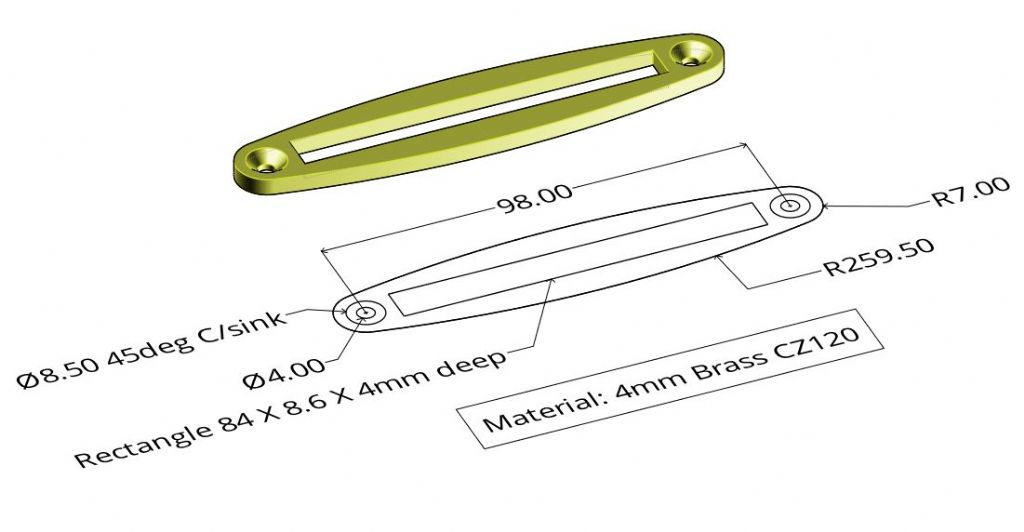

      I'm not sure what your definition of an all purpose mechanical CAD is, but although MoI doesn't have constraints such as in Alibre, Fusion 360 and SolidEdge, it is highly productive for me.
      Here's a simple workshop drawing of a part I just made, drawn & dimensioned in MoI.
      Give me an example of something you think might be unsuitable to be drawn in MoI and I'll check it out.
      Martin.

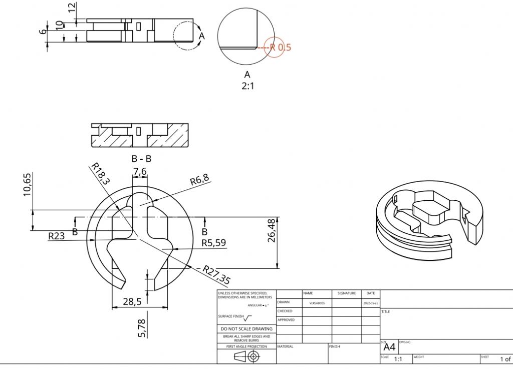

      Versaboss
        @versaboss
        Hi Martin, thanks for this, I will see if I can recreate something similar.
        Meanwhile, something which I think would be difficult to do. To be honest, I'm not sure if I added enough dimensions to copy it exactly, but some guesses would be good enough…

            From what I have seen of MOI that should not be a problem, easy enough in Alibre
            making it would be more of a challenge with those two sharp cornered triangles and where the 6.8mm radius ends and the small rectangular hole time for an EDM me thinks.

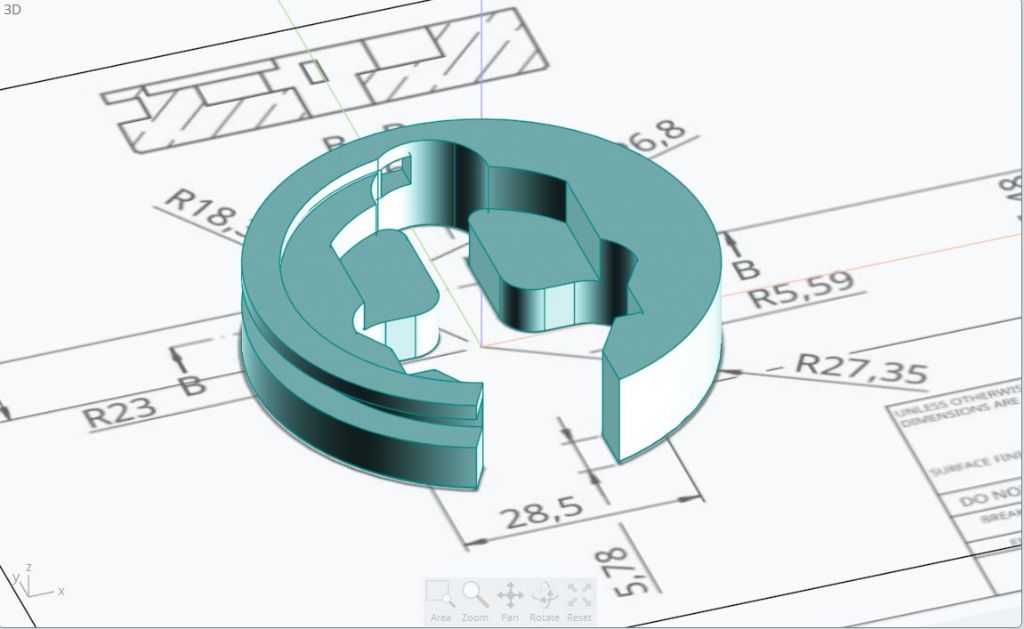

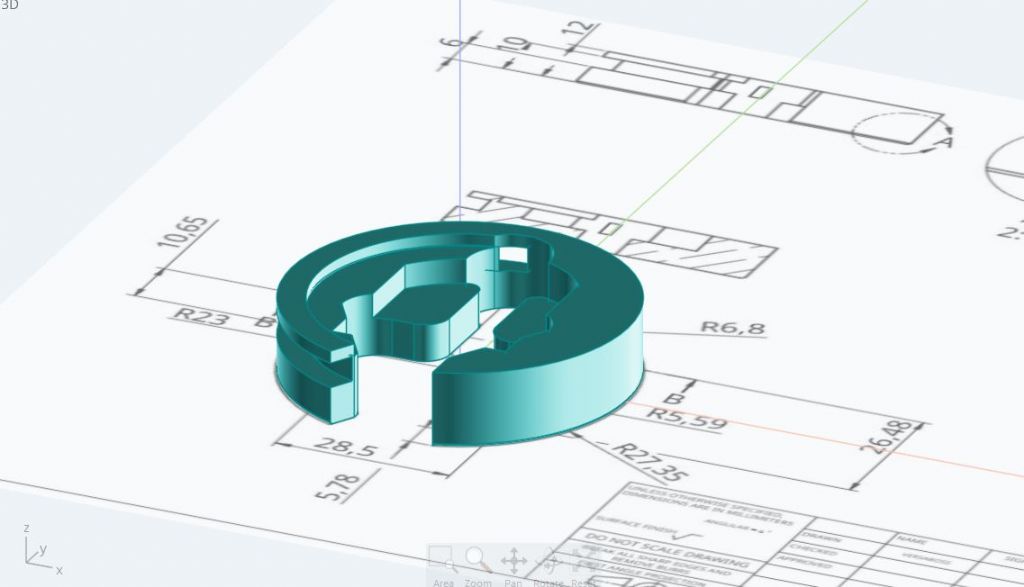

            blowlamp
              @blowlamp
              Not bad to do Hans, just a little fiddly with the stepped areas. I haven't added dimensions, but could copy those of yours without much problem.

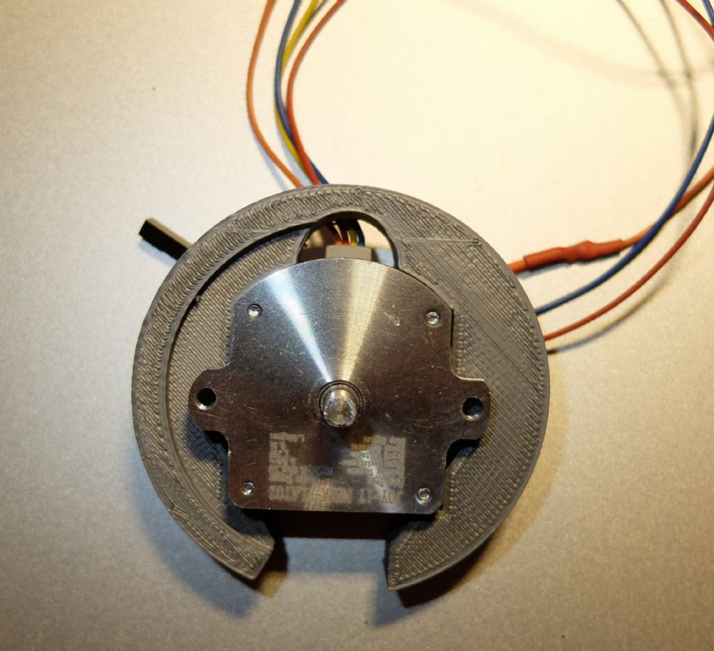

              #599458
              Versaboss
                @versaboss
                Fantastic, Martin, I'm really surprised and pleased!
                Btw, this part was 3d-printed, it is for mounting and centering a small stepper motor. So no problem with the sharp corners. Well, the print was maybe not of the highest quality, but sufficient for the purpose.

                #599664
                blowlamp
                  @blowlamp
                  Hans.
                  If you don't need or want to get involved with Assemblies & Constraints, then MoI can be quite productive for engineering drawings and is probably more powerful in some ways than other popular hobby CAD packages when it comes to producing more unusual surface shapes. It also has a 'soft' look to its interface which may lead some to overlook its capabilites.
                  You've come up with a nice solution for that part. Is the groove for the wiring? If so, it is a very neat way to route it and makes for a tidy job. thumbs up
