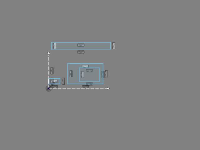

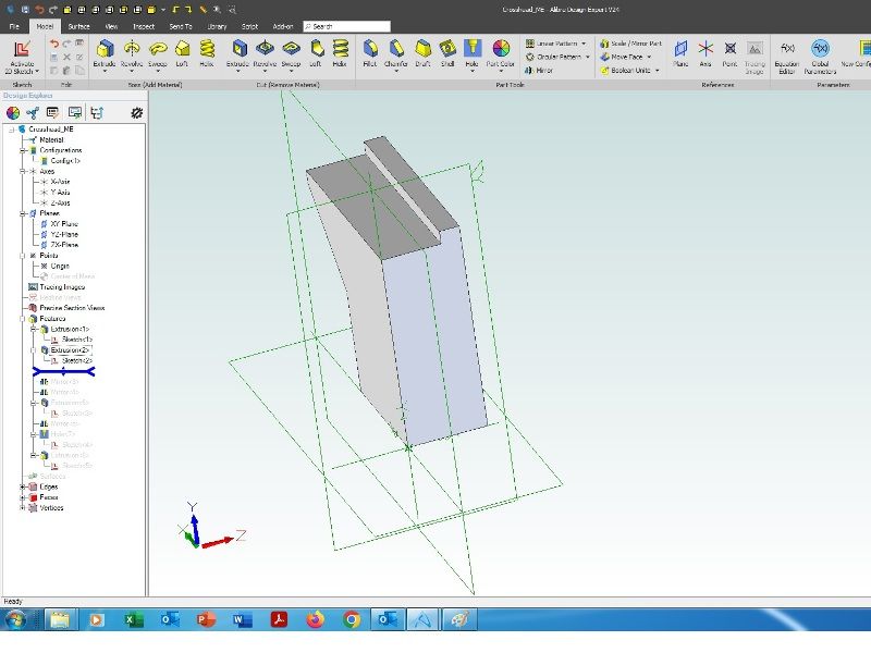

                    There seem to be some complicated ways of looking at, and creating, parts being mooted?
                    Considering the crosshead shown earlier one notes that it is has partial symmetry in 3 directions. So I would model it as followings:
                    Draw 1/8 of the crosshead body. Extrude cut the slot for the slidebar and for the cutout for the connecting rod.
                    Mirror everything preceding in one plane
                    Mirror everything preceding in another plane
                    Mirror everything preceding in the third plane
                    Add hole for small end pin
                    Extrude boss for the piston rod – if the hole is flat bottomed it can be extruded as a tube, if drilled extrude a cylinder and add a drilled hole
                    To my mind a T-nut is one indivisible part with one shape. I'm not sure where an assembly comes into it? I'd make the t-nut by extruding the shape of half the t-nut, then mirror and finally add a hole with appropriate thread.
                    The advantage of using mirrors is that if changes are needed then only one domension needs to be changed. Of course for multiple dimensions that are always the same the subsidiary dimensions can be pointed to the original dimension and will update automatically. That does mean that you have to remember which dimension was the original.
                    In my 3D CAD program (Alibre) there are two different areas where constraints apply. One, in sketches where they control features in 2D. Two, in assemblies where they control positioning of parts in 3D.
                    If anyone doesn't understand my part modelling descriptions above I'll implement them and post screenshots.
                    Andrew
                    #597840
                    Nick Wheeler
                      @nickwheeler

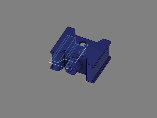

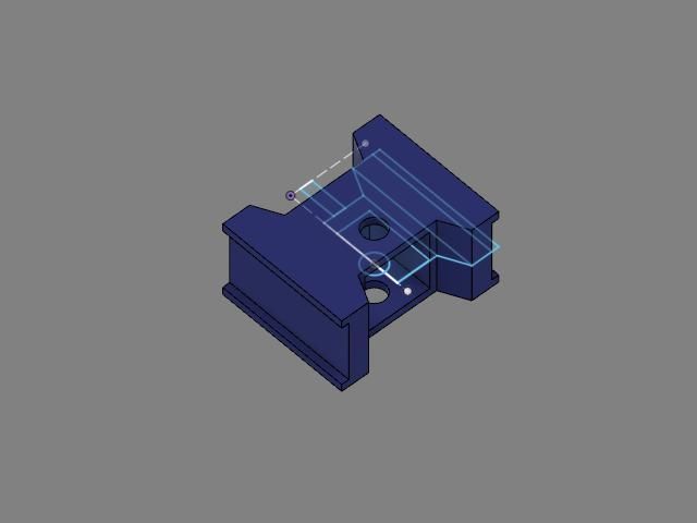

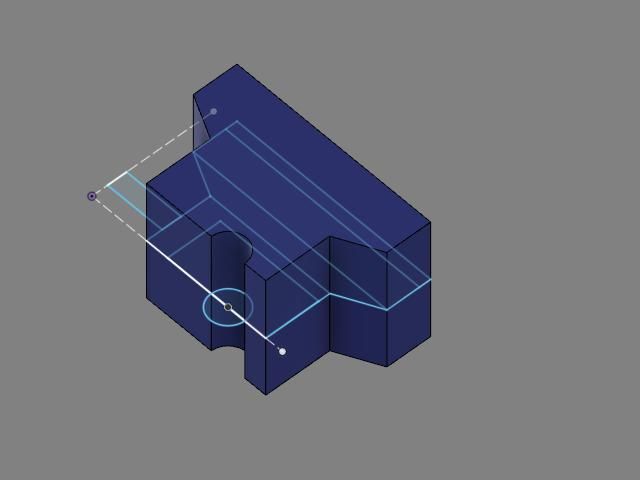

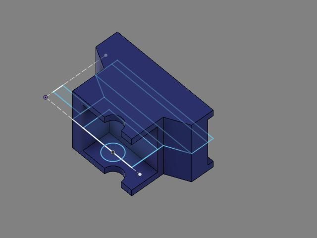

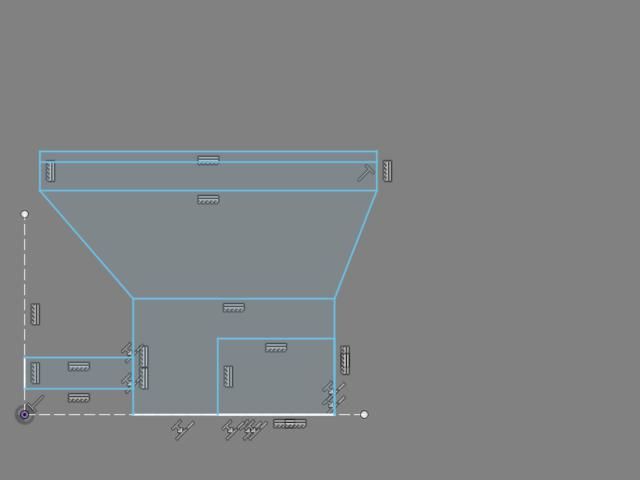

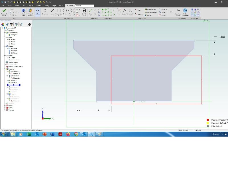

                      I'd use symmetry for the crosshead, but in one original sketch, and the extrudes:

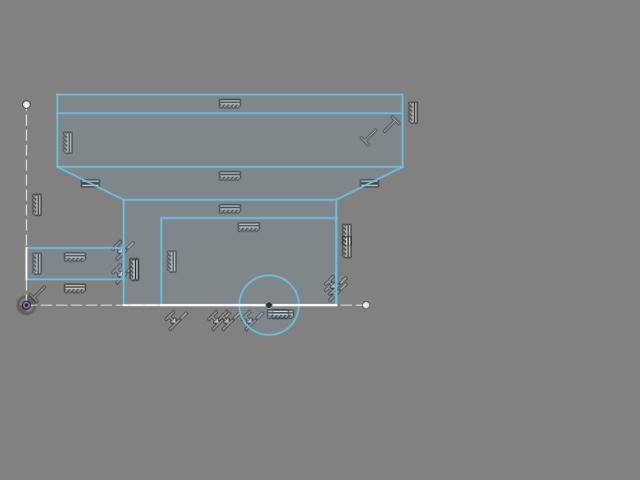

                      Draw some rectangles and construction lines:
                      add several colinear constraints for most of the profile:
                      Draw 3 more single lines, then make the angles ones equal with another constraint:
                      Move everything about for the proportions – this is where you'd add dimensions – and the circle I forgot
                      Extrude most of the profiles symmetrically:
                      Extrude two more profiles symmetrically as a cut:
                      Mirror the resulting body around its own open face, ensuring that join is selected:
                      Finally, revolve the last unused rectangle around the construction for the hollow spigot:
                      That's probably as complicated a sketch as you'd want, but simplifying it would need two more for the other features. The pin would be created in place, using projected geometry from the hole it fits in.

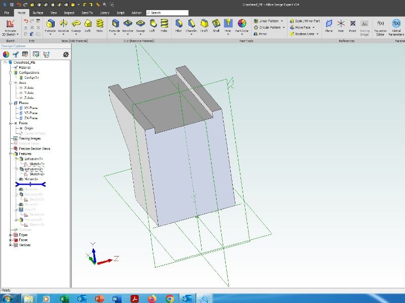

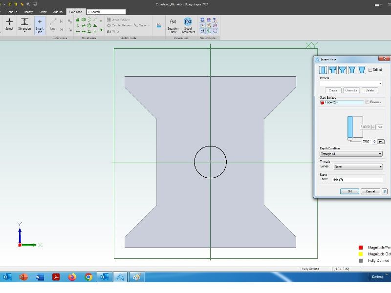

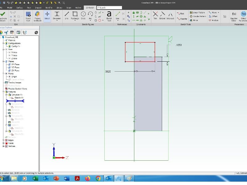

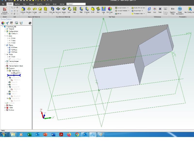

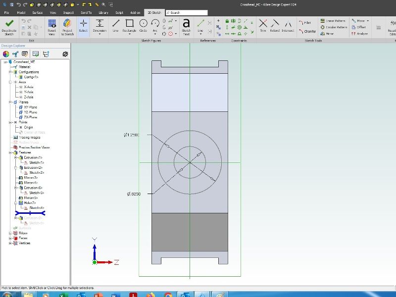

                        Crosshead CAD – Part 1
                        First sketch on the XY plane, with dimensions:
                        Line at bottom is constrained to be on the X-axis and on the left to be on the Y-axis. Extrude the sketch on the Z-axis:
                        Sketch on the end face of the model for the slidebar cutout, only two dimensions needed:
                        Extrude cut through all:
                        Mirror everything in the XY plane:
                        Mirror everything in the YZ plane:
                        TBC
                        #597897
                        Anonymous

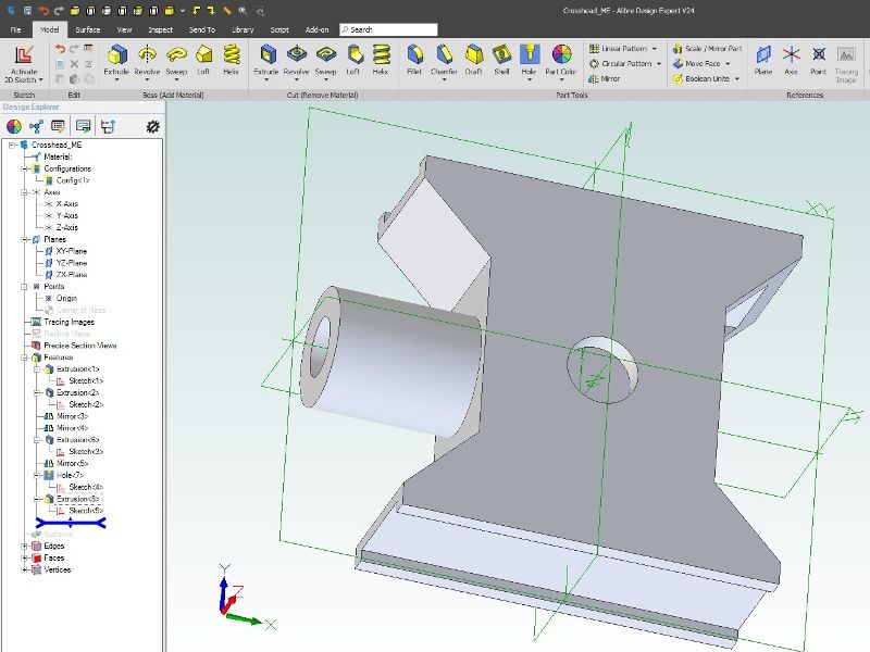

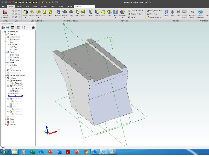

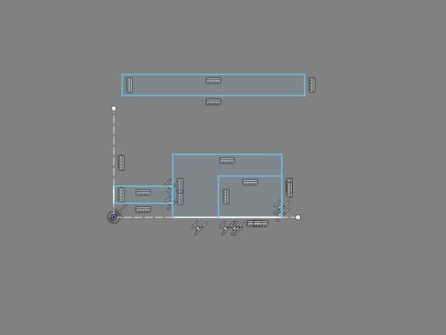

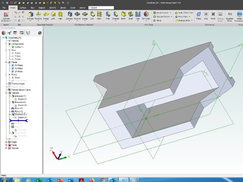

                          Crosshead CAD – Part 2
                          Sketch for the cutout for the connecting rod on the XY plane, only two dimensions needed:
                          Extrude cut to depth midplane, so equi-spaced around the XY plane:
                          Mirror everything in the ZX plane:
                          Add hole for the little end pin. Dimension of the hole is in the submenu, no dimensions are needed in the associated sketch, just constrain the point to be on the Z-axis:
                          Sketch on the end face of the part for the piston rod boss. Only diameter dimensions are needed, both circles are constrained to be on the X-axis:
                          Extrude to length:
                          For each feature only one dimension is needed, which ripples through the part if changed. Careful placement of the original sketch avoids the need for many dimensions and construction lines.
                          Andrew

                              Nigel,
                              Andrew's example is in Alibre Design Expert (big brother to Atom3D), I don't recognise the software that Nicholas was using. In Alibre there are 'Boss' (add) and 'Cut' versions of all major tools, other systems I've looked at are similar in that respect.
                              Two points –
                              1. yes there are differences between systems, even those that work in a broadly similar way. Generally the concepts will apply across many systems, but points of detail may require slight adjustments to the methods. Tools may have different names too.
                              2. there are generally many different approaches that can be used to model any particular part. There is no 'right', 'wrong', or 'best' approach – though some might have pitfalls.

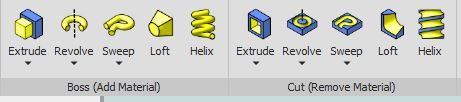

                                Alibre's "Boss" and "Cut" – probably akin to TurboCAD's "Boolean Add & Subtract" – the latter making a through-hole provided the sacrificial part to be subtracted does protrude from both surfaces.
                                Incidentally, and digressing somewhat, I think my previous, WIN-7 Pro, PC still holds a copy of a graphics programme called Pov-Ray. This is not a draughting package for engineers and architects, but for making lovely geometrical art-work! An expert at it and the maths might be able to create Fractal Dragons on it. My copy is an old edition and I don't know its up-to-date forms, but it works all by fairly simple command-lines holding the numerical distance, colour, etc. values. It reminded me of Hewlett-Packard's version of BASIC for users writing their own programmes to drive HP-made electronic test-equipment from (naturally) an HP computer, and process the readings. I don't know if the commands are a near-standard language like BASIC or C++, or Pov-Ray's own.
                                #598067
                                  Posted by Nigel Graham 2 on 12/05/2022 22:01:32:
                                  Not the same. They simply add the 3rd dimension to a 2D sketch for example the boss that the piston rod goes in was drawn as 2 concentric circles (2D) then extruded to then make the 3D boss with a hole in it. Had cut been chosen instead of extrude the ring would have been cut out of the part. This is the very basis of just about every 3D package, you need to grasp that before you can move forwards.
                                  No sacrificial part is needed. The Boolean is generally used when you want to remove a complex shape from a part, have a look at this thread where it was used to remove the core from the pattern leaving what the finished casting will look like. Also used to remove the core from a solid block to produce the core box

                                    My guess is Boss is what Freecad calls 'Pad' and SolidEdge calls Extrude, and Cut is Pocket. The commands work on sketches and faces.
                                    Say you want a cube with a hole in it.
                                    • By sketching: draw a square and extrude it to make a cube. Select a face, sketch a circle on it, and cut (aka pocket) the circle out of the cube – a negative extrude.
                                    • By boolean: Create a cube by any means. Packages often have buttons for creating primitive shapes directly, but they can also be made by sketch/extrude. Drill a hole in it by creating a cylinder, moving it to where the hole needs to be, and subtracting ( aka 'cut', or 'difference' ) the cylinder from the cube.
                                    Boolean methods are a bit of a booby trap in that they provide an obvious way of creating shapes, but it's not obvious that a model so constructed becomes ever more difficult to manage as it grows. I find it best to use booleans sparingly; good tool, but specialised. Jason's 'remove core from a pattern' example is a good one – most of his casting model is built from sketches, and then inverted with a boolean only at the end.

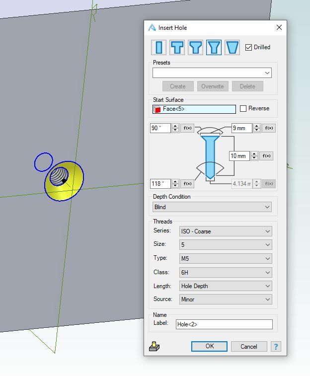

                                              If a hollow tube, or shape, is inherently part of the design then I tend to implement it using sketches. But for smaller holes, especially if countersunk, counterbored, or threaded, I use the 'hole' function. The 'hole' function also allows one to take account of the drill point; useful when checking whether a blind hole will unintentionally break through or not.
                                              Andrew

                                                Another reason for creating holes using a function and not sketches is that you rarely want one. So patterning one feature, that created a custom countersunk, threaded hole with a drill point bottom is much easier than doing that when you've performed several operations to make it. And you can easily change the thread size on all of them when you discover that the original breaks out in an unexpected location.
                                                Fusion doesn't differentiate between cut and additive extrudes until you've selected the profile. Then it makes an intelligent guess at what you want; one in a blank space is almost certainly going to be additive but could be a new body or component, so you have the option to select what you want. It won't allow you to choose cut if there's nothing to cut. One near or into another solid could be joined to it, cut into it, or not affect it at all. One inside an existing solid will be suggested as a cut, because that's most likely.
                                                Extrudes can be a specific distance, or to an existing feature of some sort. Referencing relevant features(holes, centre lines, planes, axes, edges, faces etc) is best practice. You have the option to cut through all and if it's a through hole that's the one you want as it will update if you change any of the dimensions.
                                                I can't imagine creating a simple cylinder just to subtract it from another another solid that was created from a sketch; adding a concentric circle to that sketch saves a lot of extra work, and is easier to understand when you look at your efforts six months later.

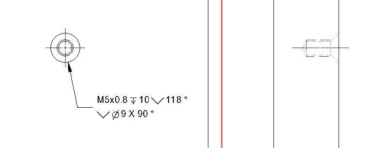

                                                  #598284
                                                    Alibre has a "hole" function that is ideal for drilled, tapped, CSk, etc holes or a combination of those. It has simply clicked options so if your hole is drilled then it will show it with a conical end, if CSK it will show that, if tapped then it can represent the thread on the 3D model and will also size the hole and CSK to suit say an M5 CSK socket screw, you just click one of the many threads listed.
                                                    When it comes to producing a 2D drawing from that 3D model the Alibre will correctly show the thread as two lines, the CSK and the drilled end and add the annotation.
                                                    Had the hole been done as a simple circlular sketch that was then cut it would have needed a second operation to chamfer the edge to produce a CSK. It would have had a flat bottom which if the drawings are going to be used by others will make them think a flat bottomed hole is needed. It won't show the thread correctly on the drawing and there will be no not to say how deep or what thread it is unless added manually and hope you remember the size from the design stage,
                                                    #598288
                                                    Nigel Graham 2
                                                      @nigelgraham2
                                                      Jason –
                                                      Thank you for explaining how Alibre works with extrusions and threads.
                                                      I think the surface skin effect I've encountered in TurboCAD could be a rounding error, perhaps related to the numerical limits I've set. Although this controls what is displayed in the dimensions, I don't know if it also affects the accuracy of the drawing. I would not expect it to though, otherwise polylines and snaps would keep failing, and they don't, but it is an odd effect that was frustrating until I twigged (or someone on the Users' Forum told me) what I had to do.
                                                      .I like the way it prints the thread details for you, but I am afraid I am not clear what it means. I don't know if there is a trade convention by which the 10mm shown is always either depth of full thread or to the tip of the cone – whichever it is. The hidden detail lines show the thread meets the start of the cone, but is it literally to be that? A conventional symbol might meet some official standard, but of no use if it is likely to be ambiguous.
                                                      I've not regarded showing the drill-point portion as so important, preferring instead simply total depth and thread depth. Even so I would add it, symbolically not accurately, where needed.
                                                      My design stage is usually the stage at which I am also drawing the thing, or have earlier drawings showing what's needed, so "having to remember" is not an obstacle. Indeed, some of my drawings are of things already made from a rough pencil sketch at best, and to help me work out how make the next bits fit them.
                                                      (At work, a colleague once showed me a drawing that demanded something like an M3 thread full-depth without breaking through… the material thickness was all of 4mm!
                                                      It is all too easy for details to be made by draughtspeople who know how to draw to the last BS / ISO full-stop in pictorial standards, to pass "Design Reviews" of those not of part function; but who have had little or no real experience of making anything. I have seen this even before CAD became nearly universal!).
                                                      When actually drilling a hole to maximum depth I do of course set it from the point contacting the metal.
