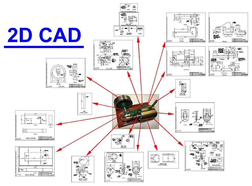

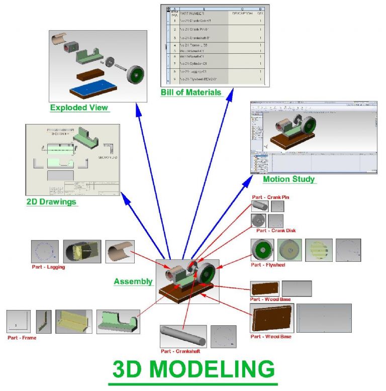

                                          PatJ
                                            @patj87806
                                            I created 2D drawings daily for 18 years before I decided to try and learn 3D modeling.
                                            I think "3D modeling" is a more accurate term, in lieu of "3D drafting" or similar terms.
                                            You are no longer drafting per se, but rather created these solid models.
                                            I have to agree that a long-term knowledge of 2D CAD is a detriment to learning 3D modeling; it was for me at least.
                                            I had to create the graphical maps of information flow, which I posted in my other post, to clarify the differences in information flow in 2D CAD and 3D modeling (I will copy them below).
                                            In 2D CAD, you created drawings that are isolated views.
                                            In 3D modeling, you create individual models, and everything else emenates from those models, such as assemblies, 2D drawings, bill of material, motion studies, exploded views, etc.

                                              3D modeling is parametric-style design.
                                              I recall asking the question "What the heck is parametric design?".
                                              The beauty of parametric design is that a change to any 3D model automatically propogates to its related drawing(s), and thus every view (such as left, right, top, bottom, side, and isometric) in a 2D drawing automatically changes when the associated model changes in dimension.
                                              The power of this one feature cannot be overstated.
                                              It would be the equivalent of changing a front view in 2D CAD, and having the right, top, side, bottom, and isometric views automatically change in a corresponding fashion.
                                              The individual 3D models that you create are the "base" of the design.
                                              Changes to any model not only automatically reflect in the 2D drawings, but also reflect in related assemblies, bill of material, motion study, expoloded view, etc.
                                              Parametric means that everything is linked together in a web of interrelationships.

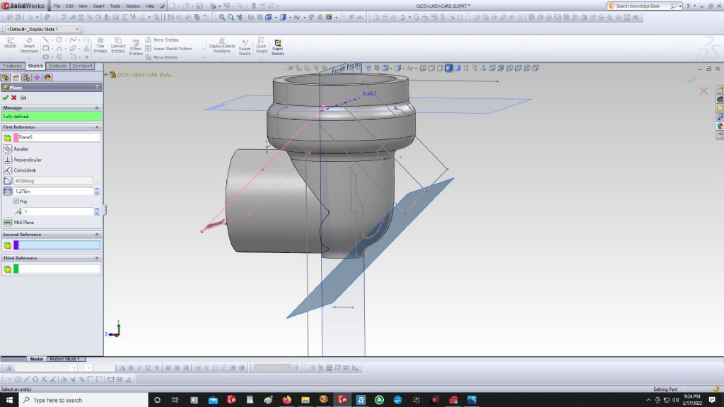

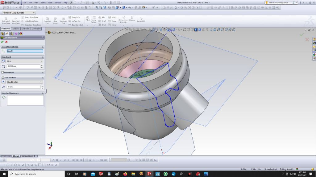

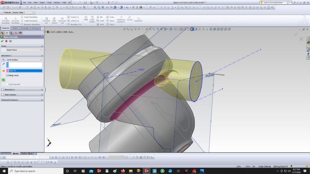

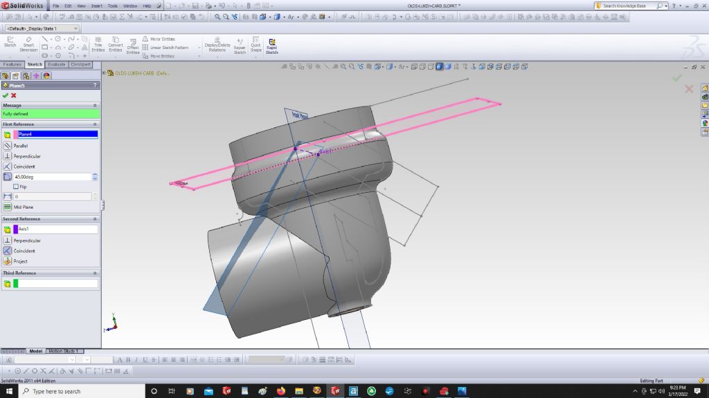

                                                      One of the last puzzles that I figured out with 3D modeling was how to insert planes, and manipulate those planes.
                                                      Without mastering the insertion and manipulation of new planes, you will not be doing any sort of complex 3D modeling.
                                                      Again, the tutorials showed how to insert planes, but did not really explain when/where/why I should do this, or how to do this to the best advantage.
                                                      When a model is first started (in Solidworks anyway), three planes are visible (if you have plane-visibility toggeled on), which are the front, top, and right side planes.
                                                      Any of these planes can be copied and offset out some distance from its original location.
                                                      I always start my 3D model centered on the origin of the front, top and side planes.
                                                      A new plane can also be rotated, and it took me a while to master this trick.
                                                      You can create a sketch on an offset plane, and then extrude back to the rest of the model.
                                                      An example of using an offset plane is the creation of the fuel inlet on a Lunkenheimer carburetor body, as shown below.
                                                      I had to sweep the interior cut again after I added the boss, so perhaps there is a better way to do it, but you get the idea about planes.
