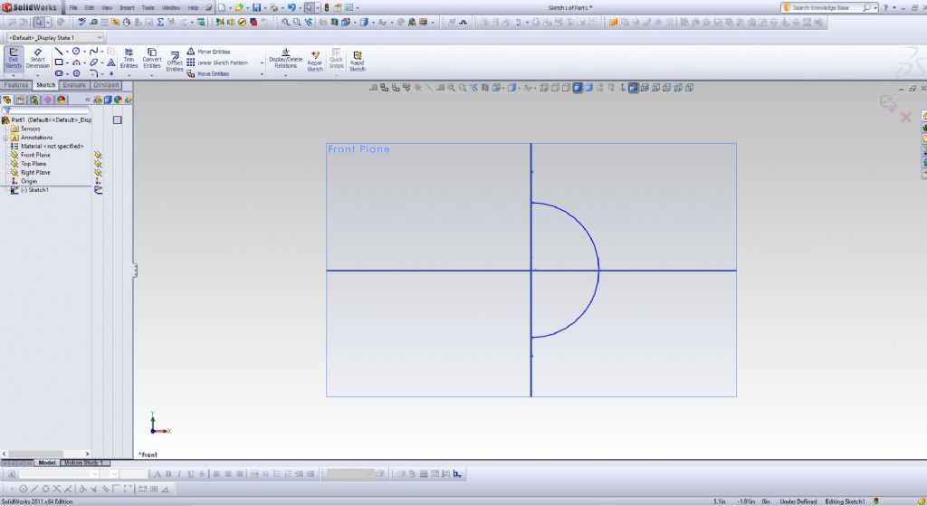

How long does it take to become proficient? I'm teaching myself Solid Edge at the moment and have spent 30 hours on it so far. In that time I've cracked how to make individual parts and a moderately complicated Assembly (with sliding, rotation, a cam action, and fixed joints)
I already had a head-start because I know FreeCAD and Fusion360: they and Solid Edge have many similarities, That saved time but, but there are many detail differences and relearning is hard because old habits have to be broken.
Switching from 2D to 3D is particularly difficult: when 3D-CAD first appeared many draughtsmen fully competent at a drawing board were unable to cope. 2D design requires a different mindset from thinking in 3D: the two thought processes are a kind of inversion of each other. Some folk take to 3D like ducks to water, others fail to make progress because they misconceive how 3D modelling works and end up fighting it every step of the way.
I started with FreeCAD and wasted an enormous amount of time trying to make sense of the enormous number of different workbenches it provides. Didn't help that many older FreeCAD web tutorials were out-of-date and positively misleading because the developing software had moved on. (Outdated tutorials are a general problem on the internet: always check the tutorial matches what you have.) However, FreeCAD became much easier when I realised that almost all mechanical design is done in the Part Design Workbench, and the others can mostly be ignored. My Making a Start in FreeCAD thread is intended to get beginners going quickly by showing how the software is started, put in gear, and taken round a typical obstacle course.

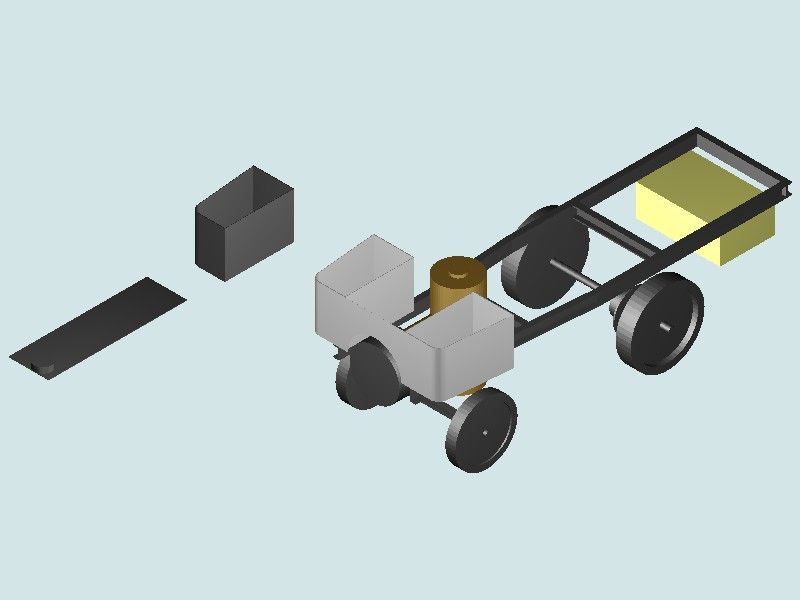

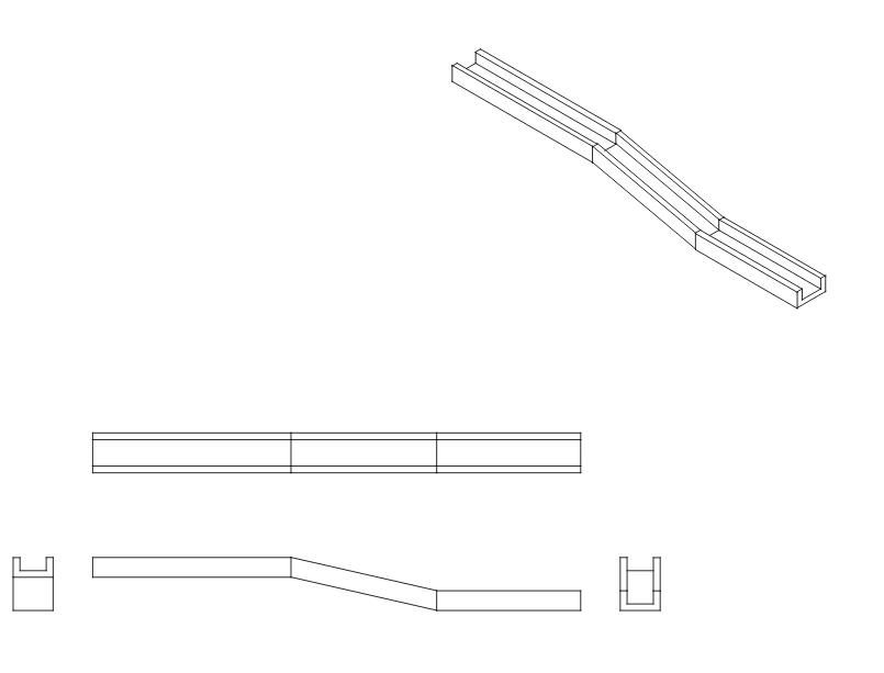

I hope the drawings below, produced in TurboCAD 19 Deluxe, help explain my points.
I hope too, no-one thinks I do not realise the value of CAD. I do, but while most people use by their choice and own approach to how they – not it – design what they make, my choice is limited by how to use it, not by why.
Martin –
I am sorry but you are mistaken here:
" I'm not seeing any intention of you wanting to learn. "
Wrong. I have every intention of wanting to learn – I already knew what CAD offers; but I had not realised it is so hard to become sufficiently proficient! If I had known that in advance, I would not have bought it.. Anyway, is it wrong to be honest and admit failure?
The pictures represents my level after hundreds of hours' trying to teach myself what many others must find easy to learn to high level, in much less time.
My original question was from my trying SolidEdge (CE) as an alternative to TurboCAD. I knew if I made reasonable progress, there are people here and in my club to offer help. It seems few in model-engineering use TurboCAD, but I have just updated my edition to TurboCAD 2021-x64. Siemens web-site offering SolidEdge tutorial videos deterred me with terms like "synchronous" in describing the videos supposedly for beginners. It implies needing much existing CAD knowledge, suggesting the material is for professional users moving from other makes. I had hit a wall of unintended technical exclusivity.
The drawings: Of my 4"-scale steam wagon chassis essentially as it is now, minus the enclosed vertical engine not yet made but which will stand behind the boiler and between the crew seats. I have omitted the seats and the chimney, for some reason, though I have made them. The flywheel shows as the green circle in the elevation.'
The orthographic colours are by Layers; which I find help differentiate sub-assemblies, and too see details under them.
The bunkers proved very difficult to draw as open-topped boxes with floors. The yellow block is of course the water-tank, sheet brass. The two chassis rails are of heavy channel-section; drawn by Extruding rectangles into cuboids for thickness / depth, Assembling and Adding them into cohesive units. Since the chassis necks inwards for the steering, making one rail needed nine cuboids!
Putting the bits together used both Assemble tools and co-ordinate sums – I know the latter should not be necessary; and I saw SE does not show a grid and co-ordinates, by default.'
I probably used "primitive" (library) cylinders for the boiler, smokebox, the differential with its chain-sprocket (not the true shape of the modified BMC unit, nor the sprocket teeth); rear axle, wheels. '
The front axle is really an I-beam. Each wheel is really a pair of dished, rose-pierced steel plates in a thick wooden rim and shrunk-on steel tyre. The radius-arms, springs and Ackermann steering are also fitted but like the wheel details, too difficult to show in 3D. I don't yet know where the chain and 2-speed gears will lie in the chassis: a typical task for the 2D drawing.'
(Shrunk-on: 30 minutes in the oven at Gas Mark 9, then wiv' a big 'ammer! Many Edwardian factory staff photos include a bloke with a sledgehammer.) '
I did not make it from many drawings, certainly no CAD ones. I made these drawings from it. Perhaps that will explain that I am the designer – sort of – not the pencil or computer. Although the 3D picture has no practical value, these two drawings represent firstly, what I have already "designed" and made, and secondly, my level of skill with CAD.
I wanted taking up CAD to facilitate the project, with me still as designer ! All my mistakes, revisions and re-makings are by me. The software won't necessarily stop that, but might help me make the revisions and corrections before wasting more metal and electricity in the shed.

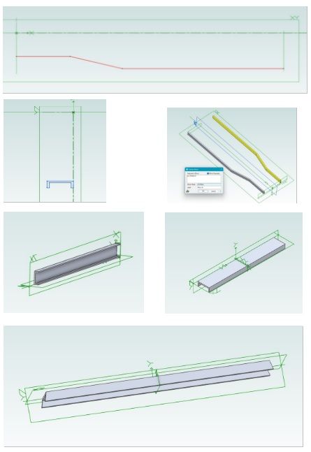

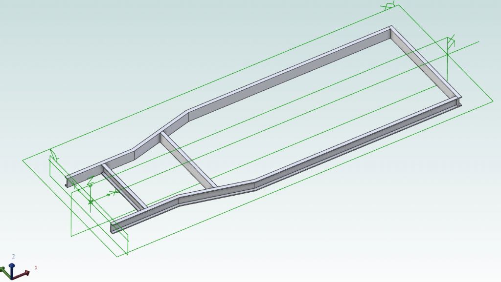

Once again, your approach is causing your problems. We keep saying that you need someone to show how any of your parts could be produced using a program you already have.
As we showed in a previous thread, your chassis rails are not nine separate operations each, but two simple, editable sketches and another editable procedure. Then you create a mirror of it for the other side. That makes you the designer, with the computer as a tool.
Coordinates are another deadly trap: let the computer use the features on the parts to position/align/join them. You won't assemble the real thing by moving the boiler back 30.56583mm and up 23.9 from the front crossmember and ground, but shift it until the mounting holes line up.
The elevations you need(I would prefer want, but I suspect we work differently) are then taken from the model because it already has ALL of the information. You can create as many as you need, showing the whole machine, separate parts or how sub-assemblies relate to each other. Again, that's being the designer.
Your 3D model is the CAD equivalent of a back of an envelope sketch, which is then used to start the design and figure out how you're going to do it – the traditional drawings of complex parts weren't created by just grabbing paper and pencil and drawing away. A considerable amount of training, practise, experience and thought was used first.

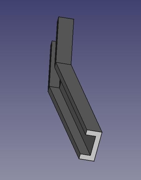

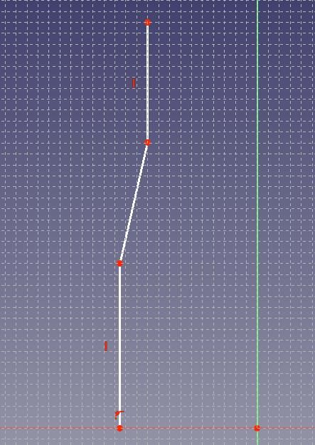

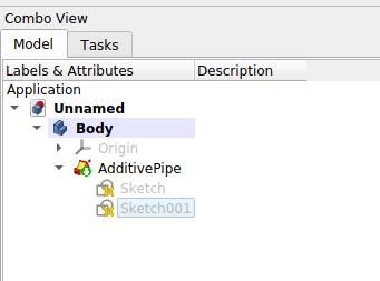

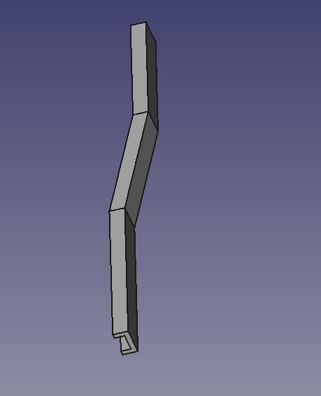

I have to agree with Nicholas Wheeler above, in that it appears that your basic approach is flawed. I find the drawing in your last post extremely crowded and difficult to read, possibly exaggerated by the scale. However, to prove, at least to myself, a relative newcomer to Alibre Atom, that a reasonable stab at it could be made, I devoted a whole half-hour to drawing up the following to illustrate how it could be done:

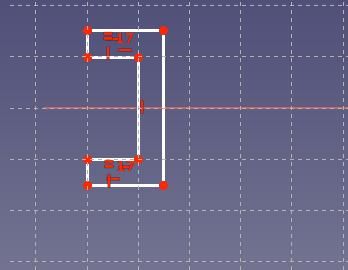

From the top, the shape of the chassis side rails, offset from the centreline by the appropriate dimension. (I had to guestimate the values, of course.) Next row: the cross-section of the rails, then sweep the cross-section along the side rail shape and then mirror about the centreline.
Third and forth rows, the cross members. That's the individual parts. Make an assembly and using constraints, align the parts to form the complete chassis, thus:
In this way it is possible to build up the whole model from the separate parts as you would in real life. Rightly, or wrongly, I have got the impression that you are trying to produce the 3D model all in one go from an orthographic projection. Correct me if I've got the wrong end of the stick..
Sorry to have taken up so much space. I really am trying to help.
Edit: Just noticed that I've missed a crossmember out – but you get the idea,

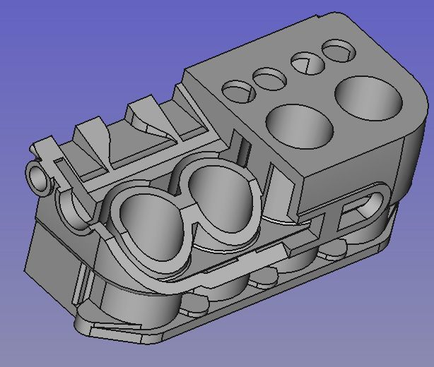

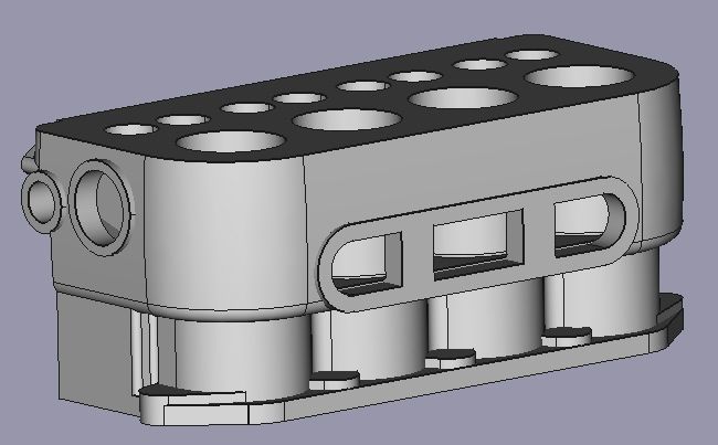

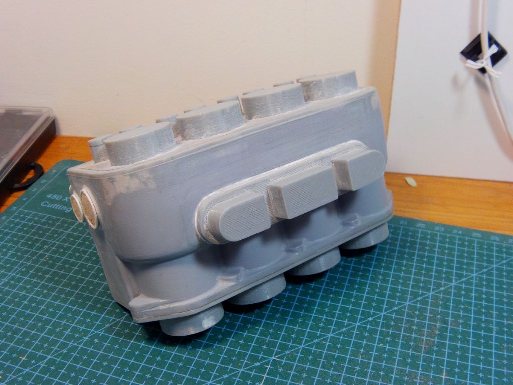

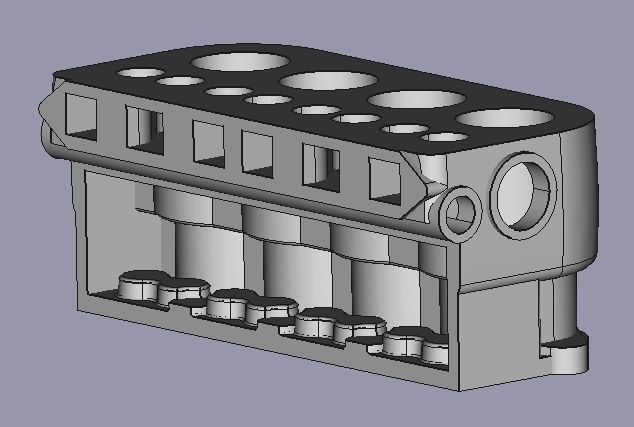

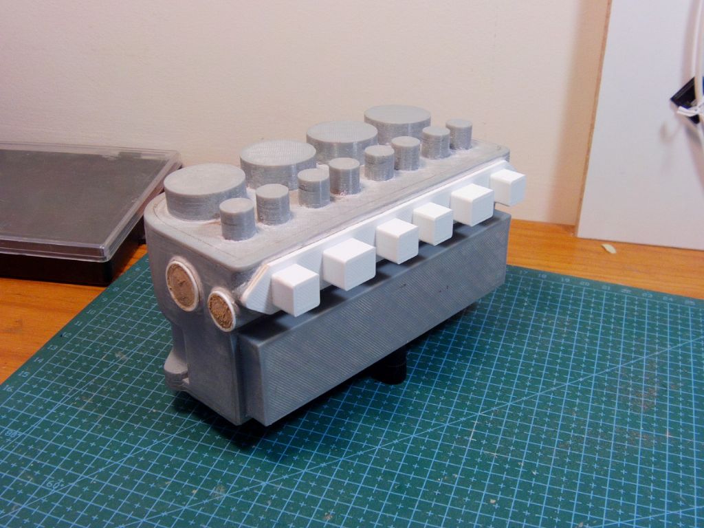

When I started with 3D cad 3-ish years ago it took me months to get something worth the effort. I was using FreeCAD then and managed to produce this model of an Austin 7 engine block.
The next image is a "cut away" view of the block internals, internals I might add that play no part in the casting process. My mistake to include them in the design. I am learning!
And then I 3D printed it using an Ender 3.
The 3D prints will be used as patterns to cast the parts in aluminium, I can't cast iron with my set up. If you have no strong need for 3D, don't bother with it. Stick to 2D if it suits your needs. There is no way I could have produced these models without 3D cad.

Finding a tutor is the hard part! Short of very expensive courses a long way from home and not feasible for me.
TC does not use the term "sketch", and in the edition I used at least, those cranked channels can only by built up by adding separate entities. All ways came down to that approach. Thinking about it, I probably assembled only one length of channel from 3 cuboids, then made copies for the other 3 parallel to an axis.
The central portion being cranked meant I could only build it up separately from three rectangles, starting with a line joining the corresponding vertices on the parallel sections – which in turn can only be set by entering grid offsets. Using rotation would have entailed calculating the angle, but probably not accurately enough to work (i.e. pixel-on-pixel).
From a straight section of channel it was easy to rotate a copy of appropriate length by 90º, then copy that, to make the three cross-members. (One is in the cranked portion, its ends angled to suit, to support the back of the boiler, footplates and eventually the engine. No. 2 is just ahead of the back axle, No.3 across the rear end.)
As you say, the second longitudinal was a mirror-copy, and that was straightforward.
I know you are supposed to let the computer do the calculations but TC allows co-ordinate moves; and I use them when I should not, for assembling entities to each other. That is because I find TC's 3D assembly methods so hard. Simply mating two vertices is fairly easy, but otherwise needs fiendishly difficult "Reference Point" manipulations. (I don't know if other CAD systems use Reference-points: an object's RP is by default the centre of the plane area or of space the object occupies but can be moved to, typically, a 3D object's surface to give an assembly snap-point not on a vertex. )
Using co-ordinate and distance entries lets you place easily, objects at points not fully identified by others. For example, the cylinder representing the differential on that representing the axle: assemble the diff co-axially to the end of the axle, then enter the appropriate dimension to push it along the shaft. If you can't move the RP to help you do that, the only option is co-ordinate sums – but I do know TC hopes you don't need do that!

You show the Alibre version of TC's "Model Space" – the drawing area – is a planes-frame floating in an infinite nothingness. Solid Edge seems similar. TurboCAD lets you display a grid instead, optionally inch or metric, to which you can set the drawing – using the Grid Snap, I normally put the major centre-lines on the main axes. In 3D your default view is "looking down " obliquely on the grid, in its (x, y) directions.
I could not see how you produced that channel cross-section; nor how you produced it along the full length, bends and all.
TurboCAD has a "Sweep" command, but I have never used it, and do not know what it is for. It is sometimes mentioned in the Users' Forum Gallery by users describing how they made some exquisite 3D image; and appears called "Rail Sweep" – hardly intuitive!
The drawing looks crowded because it is greatly shrunk to fit here; and contains many centre-lines and dimensions that do not show as such. However, I did not produce the 3D image from that. I don't think that is possible (in TC) anyway, and I drew it entirely from new.
Anyway, I would want the opposite – producing the orthographic workshop drawings from the 3D model. I think TurboCAD does offer that, but I don't know how.

That is very impressive! 3D printing and CNC machining are obviously beyond me, and beyond my means, but I admire what can be done with them.
2D suits most of my needs, and is necessary for the workshop drawings, but I had wanted to be able to use 3D CAD mainly for assembly-drawings; and at least I have that option.

I made a video using rectangles to create a simple symetric version of a chassis similar to yours, without needing to mirror anything.
It uses the sweep tool that you haven't tried yet.

I've also had a go at your bunkers. Started with a rectangle and shaped it to suit. Extruded, then Shelled to leave an open top container. Finally Mirrored to make a pair.
Martin.

Sweep exists to solve bent girder type problems. They make a solid by running a profile along a 'rail'. Example is FreeCAD, but F360 and SE are similar.
1. Sketch the U beam profile on the XZ plane:
2. Open another Sketch on the XY Plane, and draw the length and sweep of the U-Beam:
3. Select both sketches and click the Sweep button, yellow & red centre.
All being well, the U-Beam will appear:
Not bad, but wrong – the sweep line is incomplete! No problem, looking at the History I see I've created a 'Body' consisting of an 'AdditivePipe' based on two sketches. One sketch contains the profile, the other is the sweep line. Within reason I can change both.
The missing line is added to Sketch001:
Closing the sketch redraws the sweep:
No dimensions yet- it's all been done by eye, correct shape, but not size. Generally best to add dimensions and other constraints as soon as they're known, but they can be deferred whilst the design is fluid. However, the model isn't finished until constraints have been added, and missing them can cause trouble. A later change might cause unexpected movement. Planned moves are wonderful, unplanned moves are annoying.
Best practice to give sketches and parts meaningful names in the history rather than the defaults:
In FreeCAD everything depends on what was done before; history. It can cause bother if an early step is adrift. SE's Ordered mode is also history based, but it also has a 'Synchronous' mode, allowing models to change irrespective of the history. Speeds development up, but can cause confusion. Then Ordered Mode is better. Solid Edge recommend learning Ordered mode first.
2D drawings are generated last from 3D models. Third/first angle are tick-box choices, the hard part is deciding what to dimension and caption etc, which is done with the mouse. Sections are easy. FreeCAD, SE, and Fusion are similar.

TC gives several options for creating plane figures and "solids" _ but the solid figures are in more than one form, with peculiar properties, and this is partly why it is so hard.
TurboCAD floats the image and plane-indicators against a grid (options include inch/metric and non-display). The 3D default view looks obliquely down at the grid: isometric, as the view-angle tool says. You can of course rotate objects to any angle in any plane.
This allows aligning major centre-lines or outlines to the origin, axes and grid; and placing objects by Snaps and/or co-ordinates and direct dimensions. So if I place an object at typed-in (1, 1, 1) from the origin or some other point, I know its Reference-Point will be (1.000000000, ditto, ditto) from that datum. If I then use the Copy tool appropriately, I know its offspring's RP will be at typed-in (x, y, z) translation or Aº rotation from its parent, again at n.0000000… accuracy. (You can also set you own co-ordinate origin, and definite angle or count-round increments.)
The RP in TurboCAD is the centre of the object's plane or spatial occupation: the dead-centre of a cube or sphere, on the centre of the long axis of a cylinder or prism. For an object not fully symmetrical, such as my chassis rails, it lies outside the object itself.
Using this RP correctly can be vital for 3D assembling parts other than by handy Snap points like vertices and edge-midpoints, but I find this very difficult. Luckily TC is flexible: allowing Assemble Part B to A by Vertex Snap, Move B across A by dimension-entry change, as accurately as above.
My error is not in using numerical values. TurboCAD expects numerical entries where necessary as it often is of course. Entering numbers allows for example, fitting parts along a shaft or across blank facets (surfaces); but I am using them where I need not, or should not. .
By trying to do the computer's work for it, a drawing that may look right by eye can hold tiny value errors preventing other editing tools from working at all. It took me a long time to learn that in drawing a plane figure from scratch rather than editing a "primitive" or by the Polygon-tool, I need Snap the lines together so the polygon can be filled (e.g. coloured, or cross-section hatched), copied, moved, extruded, etc. If one corner fails even invisibly, the extrusion is a wall of display-line thickness, not a solid.
To draw those bunker walls, I copied-in-place the outline to a very slightly smaller size – tricky on a non-rectangle and with a quadrant corner – and extruded both. The line thickness filled the gap. I see now I should really have extruded a Poly-line with one wall fractionally shortened to stop the figure closing. For its companion, I used mirror-copy or rotated a straight copy 180º. These are the only ways available in TC.

Did you check out the two videos I made on the previous page, of how straightforward 3d CAD (MoI) can be?
I did your bunkers and your chassis in about seven or eight minutes – only approximations of sizes, but just to show the principle.

Looking at your version of those cranked channels….
Yes, a very different package but the idea that TurboCAD might have made its 3D mode an extension (extrusion?) of its 2D had never occurred to me. Though I am worried how to use it, not how it was written.
I could have extruded the basic section from a "polyline" rather as I think you have – perhaps did, I forget now – and I am not sure that this shows much difference in difficulty and work between the two systems. If I could have used TurboCAD more efficiently that's by me, not its designers.
To make that channel section in TC there are two or three alternatives, all probably of similar effort. I did not try going the whole hog with root radii and tapered flanges!
How did I bend the steel itself? It is 50 X 25 X 25mm HRS channel, the nearest to what appears on the ancient photos that are my only source material; but probably of over-scale thickness.
I have access to a manual bender really intended for forming narrow-gauge track rails, and used that to chalk-lines and wooden straight-edge on a concrete workshop floor, finally measuring the rails back-to-back, by steel rule to ensure parallelism more importantly than absolute displacement I can adjust for. I doubt the originals were much more sophisticated!
The I-beam front axle consists of 2 lengths of folded 2mm thick sheet-steel channel welded back-to-back, dressed flush and cut to width. The channel was second-hand from I know not what, but very close to scale by the photos. (And I must have been better at welding than I am now!)

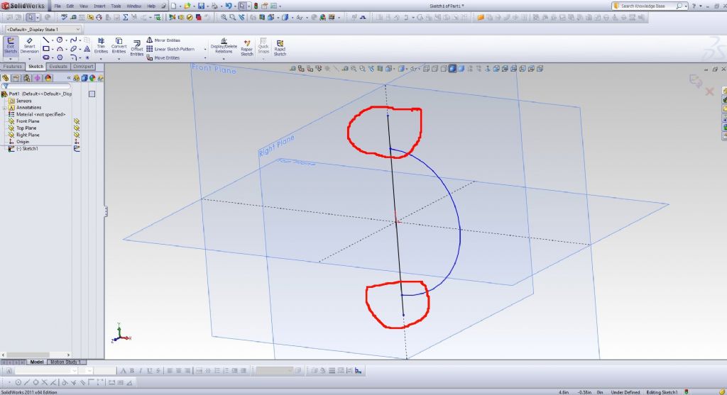

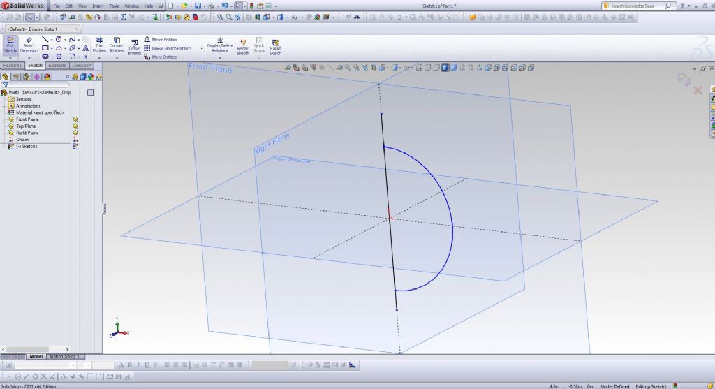

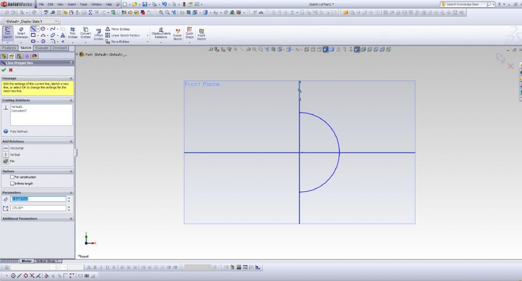

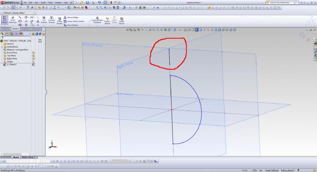

Someone above mentioned how intolerant 3D programs are to the slightest imperfection in a 2D sketch.
This use to stump me in the beginning, and I forgot how big a problem it use to be for me.
If you are not snapping exactly to the endpoints of lines and such, then you can have tiny imperceptible gaps that can be difficult to track down and eliminate.
One way to avoid the gap problem is to over-draw every line, ie: draw the lines longer than they need to be, and then use the trim command to cut them off, thus ensuring none of the dreaded gaps.
Sometimes the trim command itself creates a problem, such as at the intersection of two curved lines. The trim command can produce a small section of arc on top of another line; and this stops a 3D program in its tracks.
Solidworks attempts to show you where the problems are in a sketch, but that feature is pretty ineffectual.
I draw 2D sketches that are intended for 3D very carefully these days.
Even then I sometimes have sketch problems.
One method for determining where sketch problems are is to draw a straight line across half the sketch, and trim it off. If the problem vanishes, then it is on the side of the sketch that was trimmed off.
You can narrow down a problem area somewhat quickly using this method.
Another method to salvage a sketch is to go back and extend all the lines over each other, and then trim them all off again.
This usually clears up the problem.
A 3D program treats a sketch as a boundary, or a fence.
If there is a gap in the fence somewhere (no matter how small), or two lines where there should only be one, or one line on top of another, or a line projecting out by itself beyond the fenced boundary, then the program cannot make the calculation required to create a 3D solid.
Another way to visualize it is to think of a piece of string that has the ends fused together, so you have a continuous loop. You can place this loop of string on a drawing board, and move it into an number of shapes (no overlapping shapes). As long as the string is not broken, and does not overlap itself, the program will work.
A sketch must be a complete, clean, non-overlapping, continuous boundary.
Edit:
Another trick to diagnosing sketch problems is to temporarily cock the 2D sketch into an isometric position.
This is very helpful in exposing stray unintentional lines that are stopping the program.
I will attach a couple of examples, where I added a stray line segment up above my sketch, and another example where my vertical line extends beyond the circle.
It is much easier to see these problems with the view cocked over into isometric.

I have just spent about 3 hours trying 3D again, using my engine's cylinders cut in cast-iron bar, not cast as cylinders. I need revise what I have part-made, due to problems I could not foresee.
I drew the basic block then tried to draw the covers: two discs, different diameters (compound); with a common sector cut off between the cylinders; a shallow boss on the inside face, shallow recess in the top, 6 stud-holes in each including that shared, bisected by the common cut-off. A fairly common feature, bringing the cylinders closer together.
Two overlapping sets of three concentric circles, like a Venn diagram. The cut line joins the circles' intersections. The stud holes, as circles. All still plane figures.
Trim the main outline circles to shape. Move one set a short distance away (TurboCAD makes co-ordinate and distance moves easy).
Join the arcs and cut-lines as polylines ( mind the "gaps in the fence" ) , extrude all plane shapes as required. Those generating the stud-holes project above and below, so subtracting these "dowels" leaves holes.
The recesses and bosses were fairly easy. Adjust their generating extrusions vertically from the common surface; subtract the upper ones to create the recesses.
The stud-holes cylinders were right so-and-sos though. I lost two and had to generate new ones, using temporary construction-lines to find their centres as the covers are now unsymmetrical.
Then one refused to play nicely at all; and I must admit this does hit TurboCAD quirks that are so hard to understand. I have mentioned previously that TurboCAD has at least three classes of 3D solids, each with odd characteristics. One is that if you try to alter its height, it moves up or down instead of growing or shrinking. This happened with one of the holes, making it impossible to generate it properly.
Then I "lost" one of the locating bosses – accidentally deleted. I generated a new one but chivvying it into place necessitated trial-and-error numerical moves as there were no points to which it could be snapped, and I do not know how else to have done it.
Finally I thought I would put the covers above, not on, the block – exploded diagram.
I gave up, with problems insurmountable…
First is the sheer difficulty of moving two semi-symmetrical objects in three dimensions from where I had drawn them, to other places in free space. Snap tools cannot help because those rely on defined points.
Secondly, strange events like the co-ordinates' origin no longer matching the grid axes; something I have seen occur previously. Possibly because I had switched to a facet work-plane and might not have switched it back.
Oddest was what happened to the main block.
I was trying to draw it to be made from a piece of cast-iron too narrow for plain use (giving down to 1/8 inch LP cylinder wall), so sandwiched between steel slabs which would also carry the outer cover studs and possibly the transfer passage. I had drawn and assembled the block and plates. Now, the two plates had risen vertically, like wings, to the top edge of the central block – yet I'd not touched them! Another work-plane error on my part?
I abandoned it, but could neither save the file first, nor did TurboCAD warn me to do so when I pressed the closing 'X'.

Those covers should be such a simple job if the first circle you draw is placed at the crossing of two axis you can then use the third axis as the centre.. Locate all other parts using that centre or simply a concentric constraint.
As for stud holes any half decent program will allow you to draw just one hole and then use a circular pattern to get six equally placed about the above mentioned ctr,
I drew the cylinder about a year ago to show how it can be done and probably the covers too back don't have time this morning to look back.
