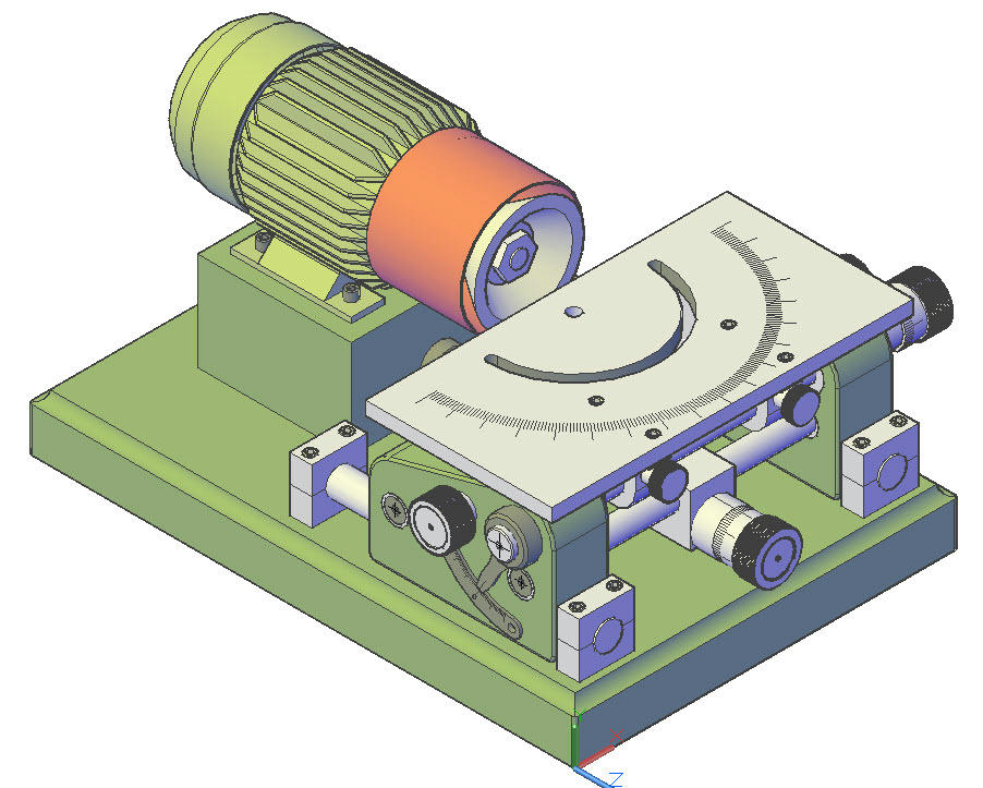

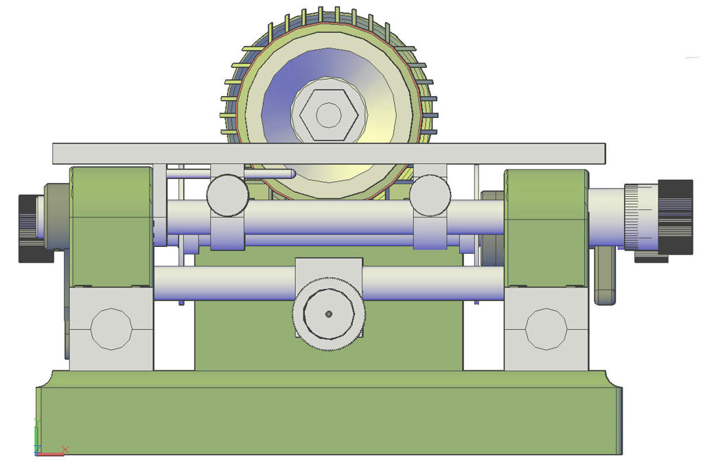

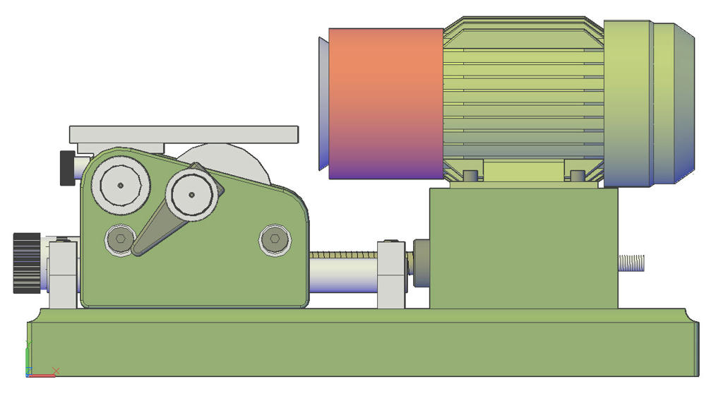

            The mechanical design has almost been completed, all the motions and table locking now work properly. A good example where CAD excels being able to see how parts relate to each other before you build.
            I used the cam method for table rise and fall, clamped by the lever on the right and a substantial friction disk; you can see it on the right in the front view.
            The table angle is directly indicated.
            I would appreciate a little help; I do not have any plans for the Worden; in order for the many accessories that have been designed it would help if I knew the position and size of the arc and centre point locations and dimensions. I will amend the plan. That way the accessories should fit
            The position of the Motor, should it be movable laterally or rotatable? There is plenty of room to make it so. Will it make the machine more versatile?
            The drawings are all AutoCAD files. If any non commercial user would like them I will be pleased to oblige PM me if you would like a copy.
            Once the machine is tested I will produce a set of PDF drawings.

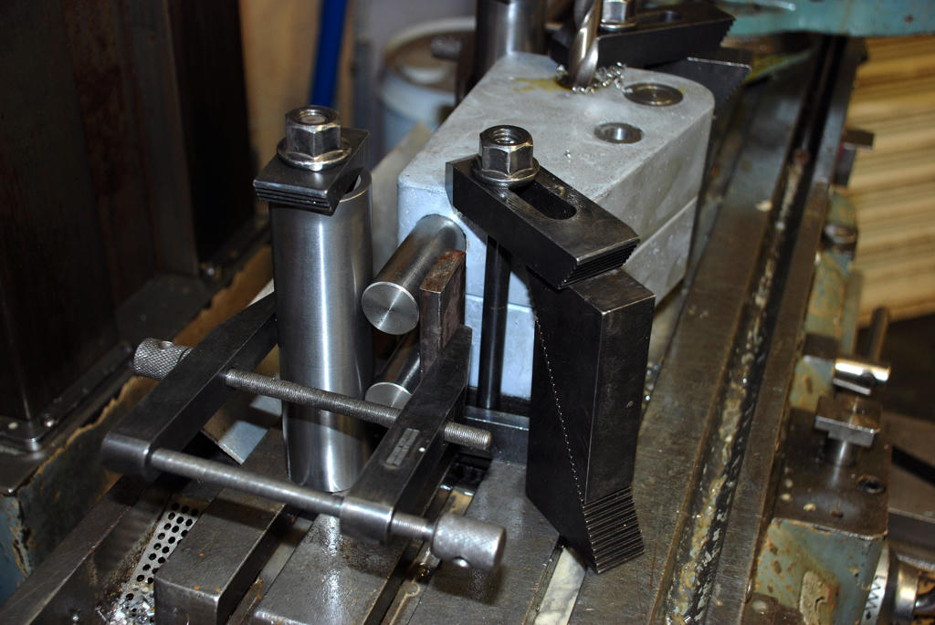

                    Update on the Epoxy Worden
                    The endplates are finished… see attached photos.
                    A nice set of photos and yes it all worked…..

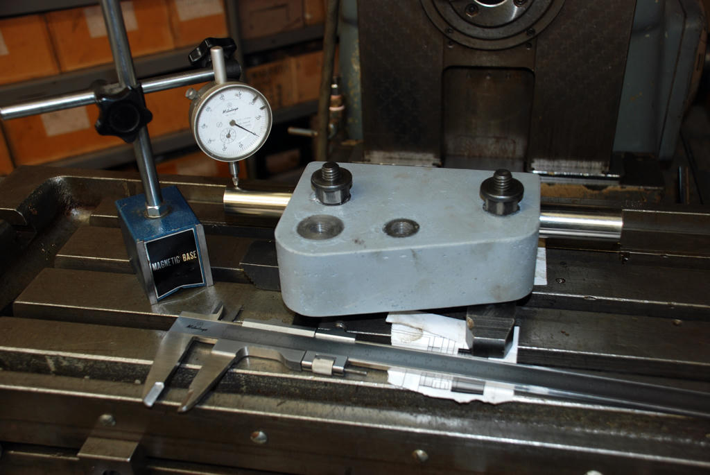

                    However all wrong! Well the method was.
                    It is easy to fall into the trap of thinking traditionally when you should be thinking “how can I improve the process using new technology.
                    In this case I cast the part and then machined it in the same old way as I would have with cast iron.
                    I then separately bored the right and left table pivot holes first, they are different one 25mm the other 20mm; as I wanted to bore all the other holes together that created an alignment problem. In the end I made a stepped locating dowel to align those holes while boring. So after setting out, then jigging up on the mill to hold them precisely, I was ready to bore. In the end I used a drill to open up the holes meaning that the location of the holes will not be exact. Jig boring the holes one by one would have been more accurate while taking a lot more time. However the error is small. Drilling them together does guarantee the holes are precisely located opposite each other a primary requirement. I ran very slowly at 75rpm with a feed of .0025” the holes did not wander, I takes a while so I set the auto stop. so I did not have to watch.
                    To align the Y axis rails I clamped them to two cylindrical squares, self made from 50mm x 5mm tube the large hole in the centre allows plenty of latitude when positioning ….Very handy .
                    So what is wrong with all that…… the time taken.
                    A far quicker method would have been to make up a small plate for the base of the mould using a small piece of light steel or aluminium for accuracy. All that was needed was to mark precisely drill and attach four accurately turned locating pins; and then pace the inserts pre bored on the lathe over the locating pins. There is no need to allow for shrinkage there is none with epoxy.
                    No further machining would have been needed the holes would be exactly positioned.
                    A lesson learnt
                    Next job is the 4 shafts and the four rail mounting blocks.
                    Cheers
                    Y axis aligned level with bed Zero both ends in indicator (Also transversely)
                    Main pivot bearing Bored
                    Set up to be gang drilled
                    Y axis bearing aligned to cylindrical squares.
                    Stepped dowel to align main bearing

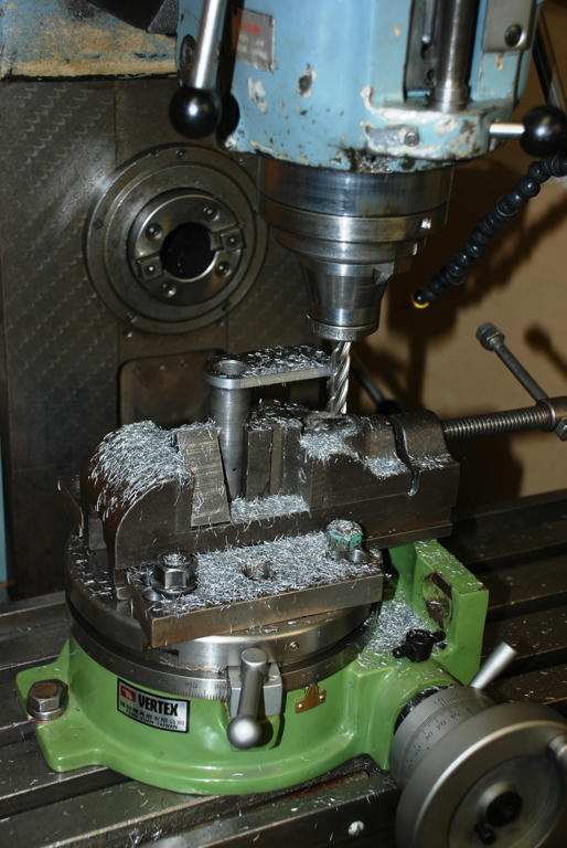

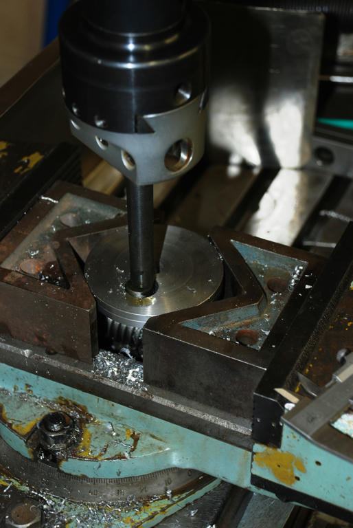

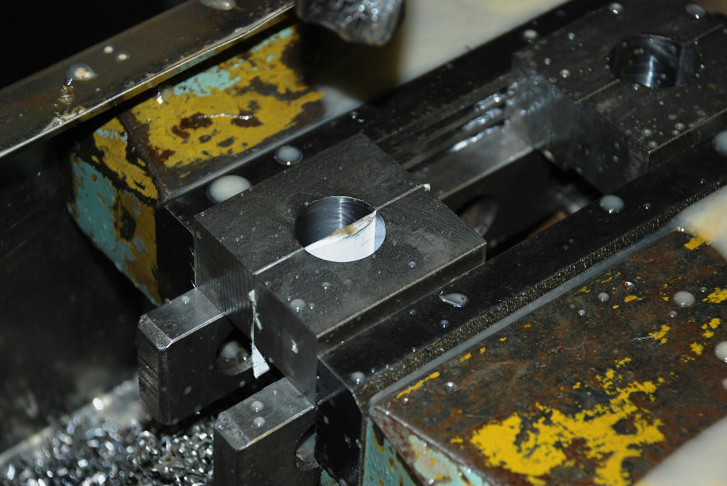

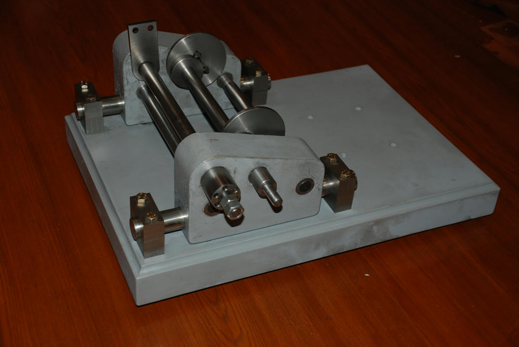

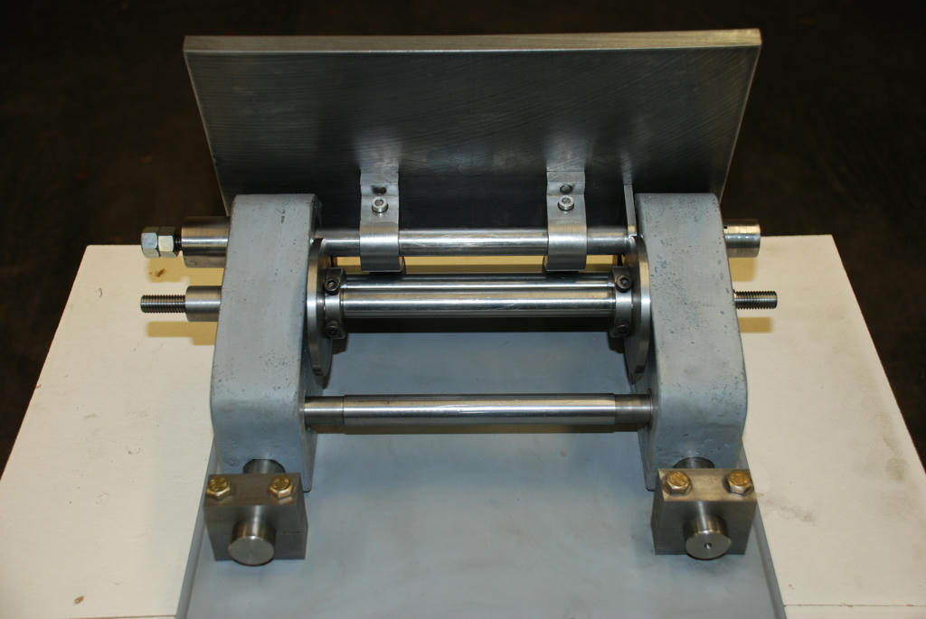

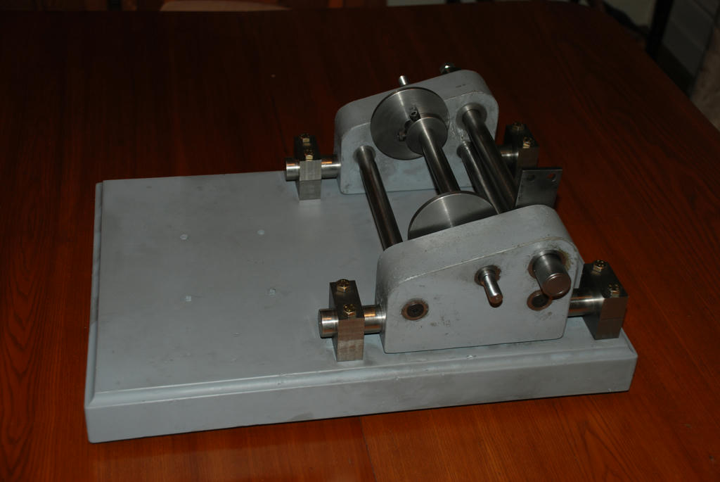

                          It’s been a while since I updated the Mineral Casting method Worden tool and cutter grinder. The good news it has proven without doubt the kind of rigidity you can expect from this method of construction. The movement of the table carriage feels more like a lathe saddle than a grinder there is no perceptible movement. When the tool is finished I will document it formally.
                          The bill of materials: So far all from the scrap bin except for a Litre and a bit of epoxy, Cost about 30 dollars and a bag of aggregate and a bag of sand; total cost $14 from a garden supply. It looks like the only steel to be purchased will be the Table piece but I am still rummaging, also some M8 hex cap screws to replace the machine screws currently holding the bearing rail blocks.
                          To this point The x axis table movement is complete; it is not obvious from the photos but the front top bar that will carry the table pivot brackets can move laterally a distance of 25mm left or right a total of 50mm. The table itself can also move independently upon releasing the two lock nuts (See previous photos). At the opposite end the shaft is bored for a long spring to preload the feed screw. Similar to the way the Quorn feed is arranged although the Quorn does not have a bored shaft the screw bears against the shaft.
                          I am considering adding stops and a lever for quick action on saws and cutters. In particular the draw full inch bore milling cutters I have not been able to sharpen. I plan to sit them on the table in the horisontal position on a locating arbor, and index them against a spring stop finger as is the norm. A lever action would speed the process. There should be no chatter the machine is rock solid.
                          The y axis in feed not yet built will make precise adjustment of the depth of cut very easy. This is where this design is quite different from the original the entire table can be precisely located in the X and y plane. Attachments can be simplified in some cases avoiding the need for a feed mechanism.
                          The turned boss bolted to the right hand casting with a projecting screw is the x axis control. The screw itself is fixed within the boss, the movement being obtained by an M12 threaded hole in the end of the shaft that engaged the threaded shaft. This keeps the mechanism completely internal and away from grinding dust.
                          The arm pointing upwards from the top shaft abutting the left hand casting is to transfer the angle of the table to the table angle pointer that will be fitted to the outside of the left casting…You can see it in the photos of the earlier posts. This part is not finished the two holes and a section of it will be cut off. It is just a convenient piece of scrap that was to hand. Because this piece needs to be exactly in line with the top of the table support brackets I will not trim it until the brackets are done.
                          The table lift cams are complete as well as a secure brake to hold them in position. The plain turned M12 nut in the photo will have a lever with a bored hole that can clamp on the turned nut. This will provide adjustment of the clamped position.
                          Engaging that nut pulls the cam bar to the right, the cam itself sits against a shoulder to stop it sliding along the bar the other side of the cam is forced against a 45mm hollowed out disk attached to the casting, effectively forming a small disk brake. A half turn on the M12 nut and I was unable to move the cams.
                          The next step is the table and brackets. As no one has posted the dimensions of a warden table I will just make it as is if anyone builds the machine by this method they will have to adapt any attachments they may build to fit this table as the position of the radius clamping Arc and the centre point is unlikely to fit.
                          The motor mount is still a work in progress; I think it should be possible to rotate the motor. Even as much as 90 degrees? Any comments would be welcome.
                          There was some discussion re Epoxy a few posts ago, Has anyone found a reasonably priced source of supply for the UK?
                          There are a few photos below the captions should be fairly self explanatory.
                          Cheers

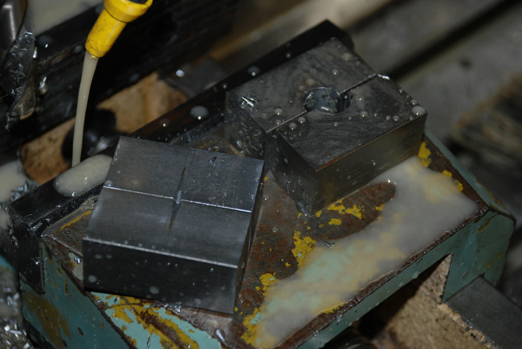

                          Nicking the two halves of the bearing blocks in the centre to start the hole in the centre
                          Starter drilling the 25mm holes
                          Continued next post

                            Paper inserted to create a gap for clamping.

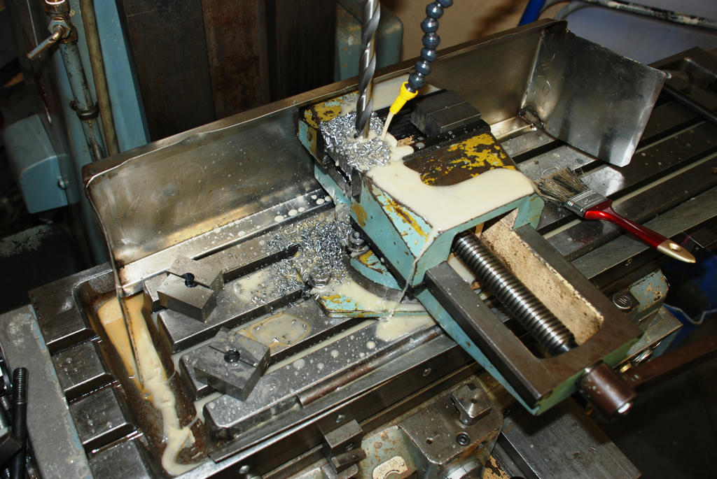

                            Gang Drilling table cams
                            Precision boring table cams

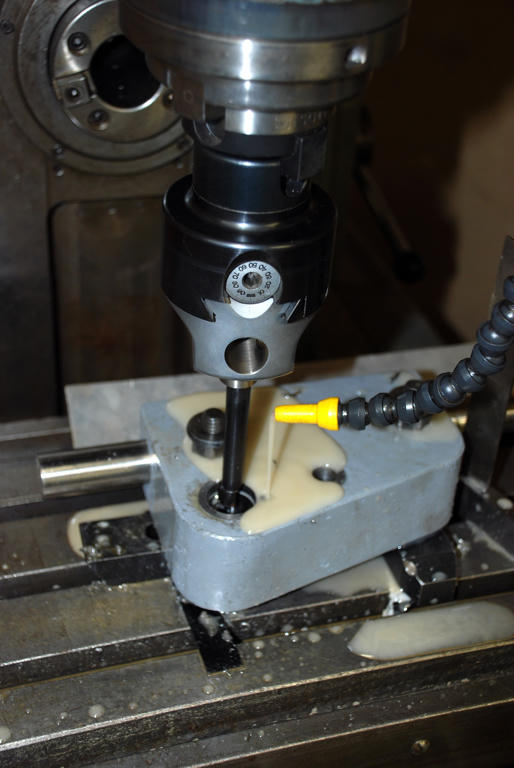

                            Boring cam boss
                            Parting Cam Boss
                            Milling table angle arm on rotary table
                            Continued next post

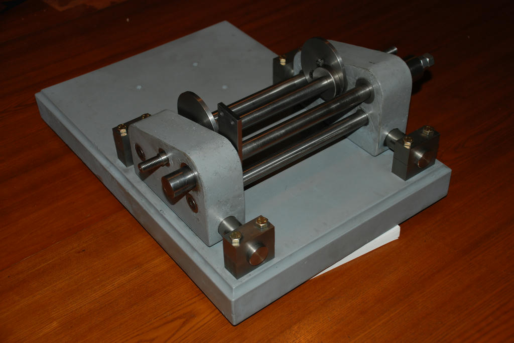

                              Left rear view
                               Left Front View
                              Right front view

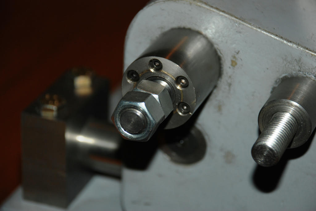

                              Feed and clamp shaft detail… Boss was bored straight through reducing collar silver brazed in then faced off in the lathe. The M3 set screws attach to the steel casting insert

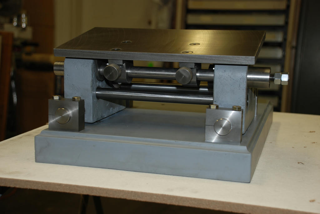

                                Hi All

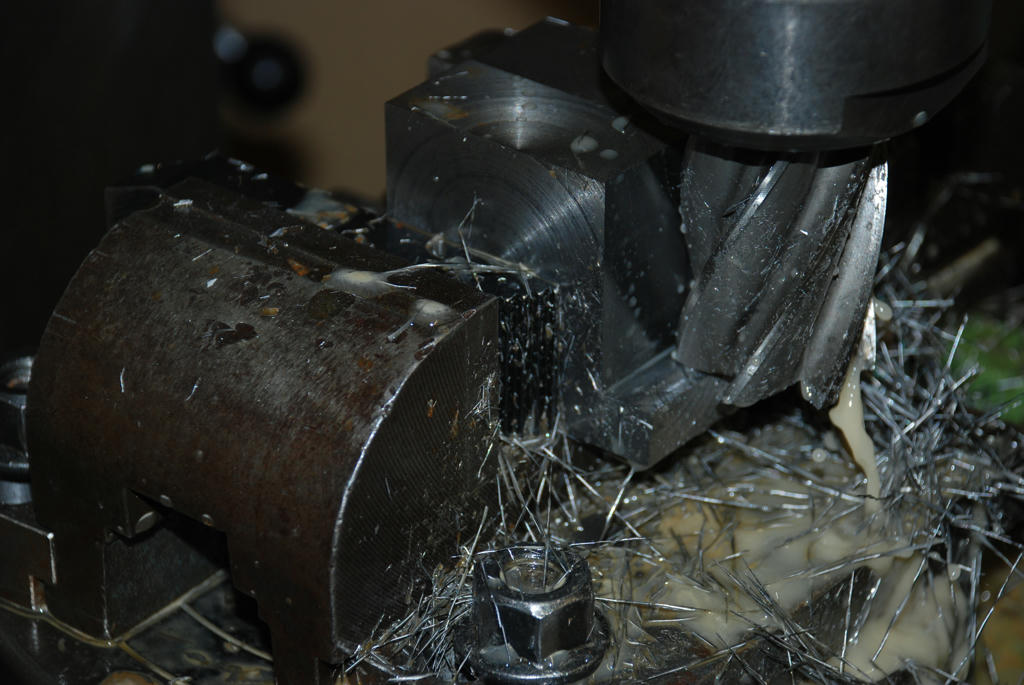

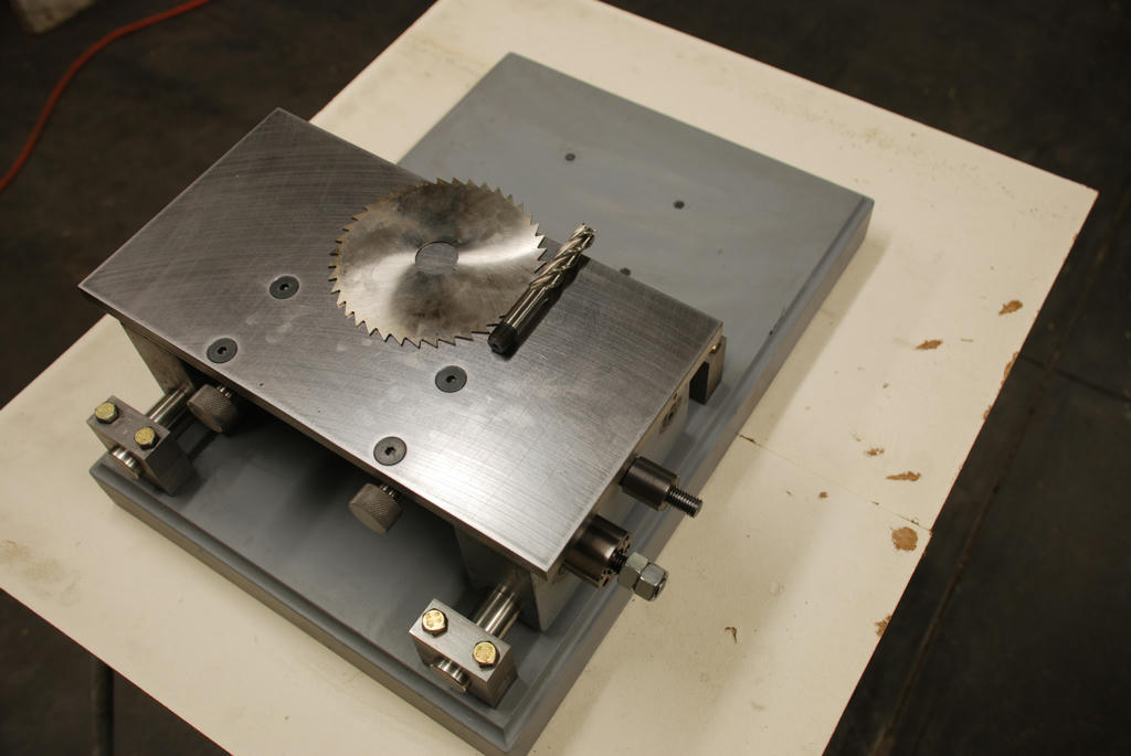

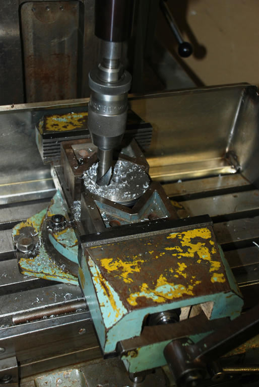

                                A quick Update… The Table support brackets and table made…. Yes I found a nice bit of plate in the scrap pile. Rather happy it had been Blanchard ground, you can see the marks, After a bit of cutting it was ready, it is 13.5mm thick, a little thicker than the 12mm I had planned on using.
                                The photos show the process I used.
                                The last two are exciting…. I just placed the cutters on the table for inspiration. The motor will have to be rotatable. This will be more versatile for working on various shapes of cutters.
                                Next, the Y axis feed and the motor base after that. The plan is to do all other knobs and the graduations at the same time at the end.
                                Cheers

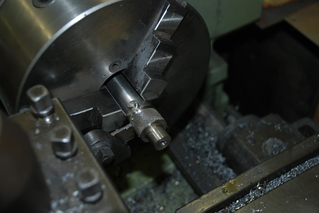

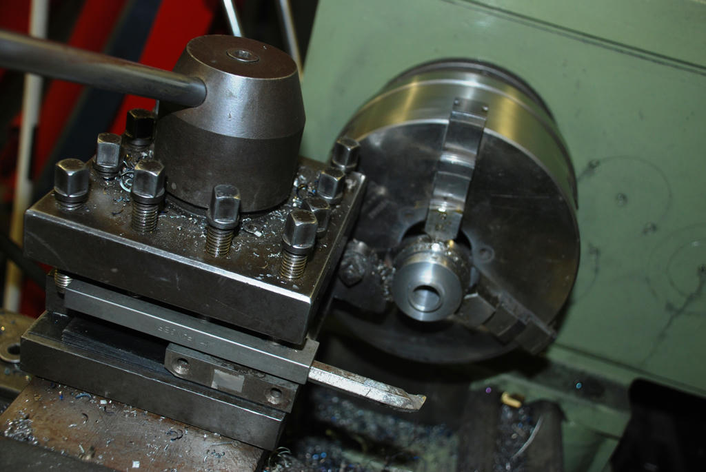

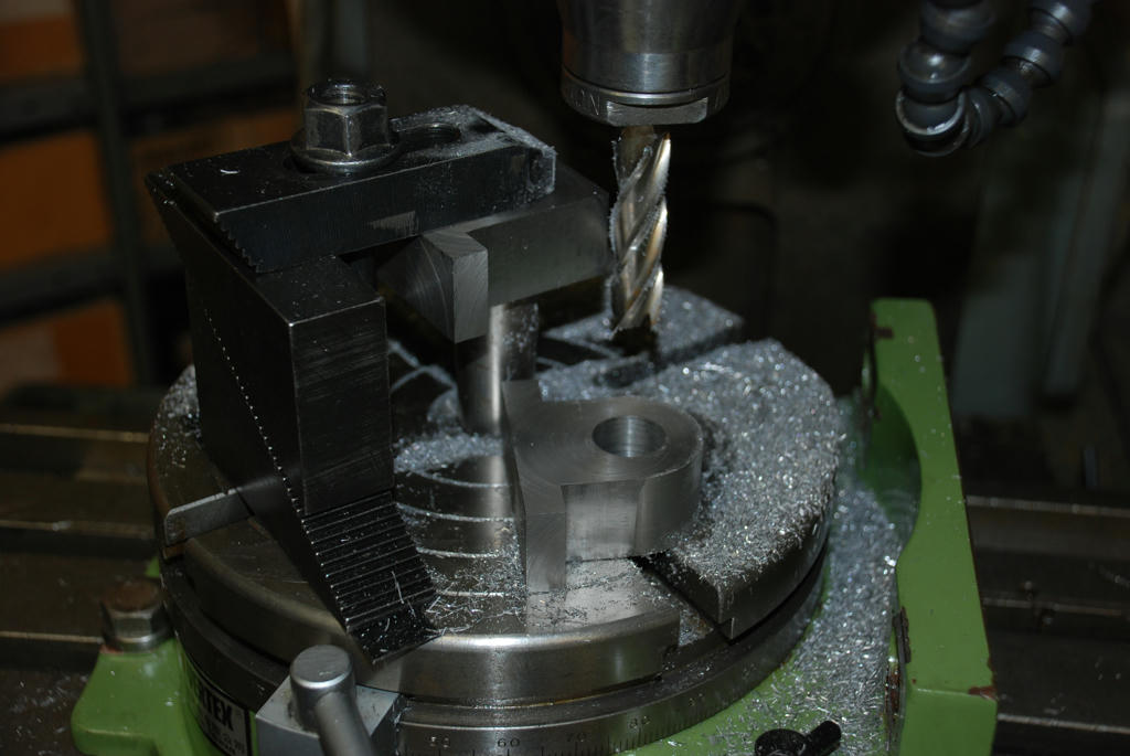

                                First milling cut table support brackets I squared them on the lathe in the 4 jaw
                                Cutting the circular Arc on the table support brackets
                                The part is centred by the bore hole for the support shaft, on a centre mounted
                                on the rotary table. Clamp is pressing down.

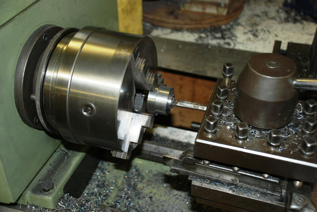

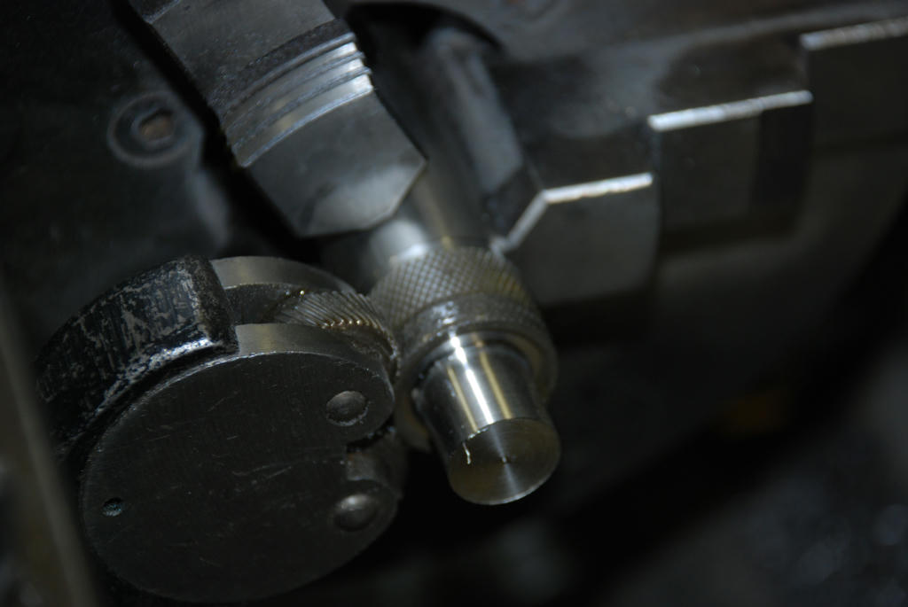

                                Table slide locking knobs. In one chuck setting
                                25mm shaft chucked
                                Faced

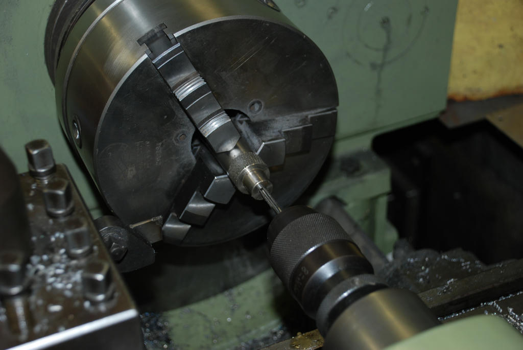

                                Thin section turned watch out for the SS swarf it cuts (the lathe was stopped but even clearing it away it got me.)
                                Turn the area to be knurled taking a couple of thou of to get a true centering. and a clean start for ther rolls to bite in
                                Knurled.. Heavy pressure .003 feed (Or the lowest feed you have) 3 passes (Do not go off the end just to the 3/4 point on the rolls) increase the pressure a little each feed.
                                I got a very nice diamond knurl. the material was 304 stainless it work hardens so be patient.
                                Drill 20mm hole and tap I started the tap in the tailstock to get a straight start
                                put a small 45 degree chamfer on the end edge and the inside knurl edge Not shown
                                Part off knob Dont dither with the tool rubbing, it will work harden, enough pressure to keep it cutting. If you want to stop pull well back. Lots of oil
                                The final step is to put the knob back in the chuck face off the parted end and do a small 45 degree chamfer on the edge.
                                Continued next thread

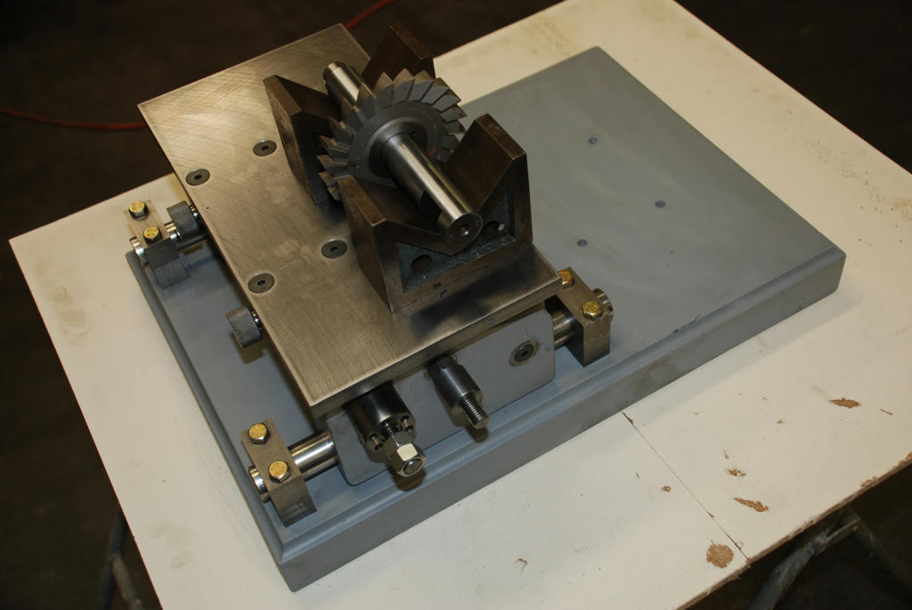

                                  Table installed (It will be milled and engraved later)
                                  Rear view
                                  Possible cutter sharpening
                                  Thinking of larger cutters the motor will need to be rotatable 90 degrees
                                  Cheers

                                            Hi All
                                            Just an update….
                                            I am bogged down with the motor design. And feel a little guilty for not posting an update to the project.
                                            The plan is to make the motor rotatable; the trouble with that is a standard frame size motor is too big to comfortably fit within the base of the machine. Making the motor rotatable means that a spindle is required in addition to the motor (the grinding wheels for this design being around 100mm in diameter) that is a lot smaller than a typical induction motor.
                                            The spindle itself is not a problem and it gets over the problem of end play of the motor shaft. I know you can pack the motor bearings and get some sort of pre load. But conventional Conrad ball bearings as used in nearly every motor are not nearly as stiff as Angular contact bearings properly preloaded in a spindle.
                                            Back to the motor…I came unstuck! the plan was to use a Universal motor (It is almost fully enclosed so dust will not be a problem) and I had one in stock. Well I thought I did. It is a FRAMCO (Fractional Horsepower Motors UK) 1/3 hp the right size and all it needed was a new bearing. So it was taken apart and the bearing replaced. I noticed the comutator was a little grooved, no problem…. into the lathe it went and after a light skim, the copper was shiny bright. After cleaning out the groves between the contacts it was ready to reassemble. No I did not check it for shorts, wrong move there…. having put it back together and powering it up you guessed it a little puff of smoke and a blown fuse; so much for that Idea. The comutator is shorted.
                                            A new motor will have to be sourced. Hopefully this week so I can get on with finishing the project.

                                                Hi All
                                                An update
                                                A new motor was ordered today, it arrives in a couple of days. Now I know the size it is back to work and the project can continue. Once it arrives (The supplier is in another state South Australia) and is tested; I will post the source. It is an induction motor 1/6 hp 120watt 2800rpm 120mm diameter 190mm long including the shaft Frame size 56 continuous running and IP56 fan cooled sealed construction.
                                                Also today I spoke to the Megapoxy representative in Melbourne. He suggested that the best contact for them in Europe is:
                                                Tassos Anastasopoulos
                                                megapoxy@otenet.gr
                                                As I understand it this is their main distribution hub.
                                                I would like to point out that I am only a customer of this company and have no other connection to them, having said that they have given excellent service.

                                                  John, are you sure that 120W is enough, I run my Super Adept on a 180W induction motor, and anything over an inch in dia takes a lot of patience to say the least. My small bench grinder is 380W, 2800rpm, running 5″ wheels, I’d have thought 300W might be nearer, but size is the thing. Ian S C
                                                  #71732
                                                  John McNamara
                                                    @johnmcnamara74883
                                                    Hi Ian
                                                    Gee you got me thinking.
                                                    The local hardware has small 120watt bench grinders. However you may be right. Anyway I changed my order to a bigger frame size. .55kw I guess that will be overkill. If I cannot get the small size I wanted I might as well get plenty of power.
                                                    The minus is it has added 55mm to the length of the motor, meaning a longer ball bearing wheel spindle will be required. The new design will include the ability to rotate the motor 90 degrees. This should make the design more flexible.
                                                    It might even be possible to use it as a cylindrical grinder within the 50mm table travel.
                                                    The motor was sourced here:
                                                    I have no connection with this company I found them on the net. However I received friendly and helpful service so am happy to recommend them. Ask for Sam.
                                                    Cheers

                                                      @iansc
                                                      My little motor is a 1450rpm ie 4pole motor, so it has more torque than the 2800rpm motor. Its marked IBM, I think it came out of a cash register. Ian S C
