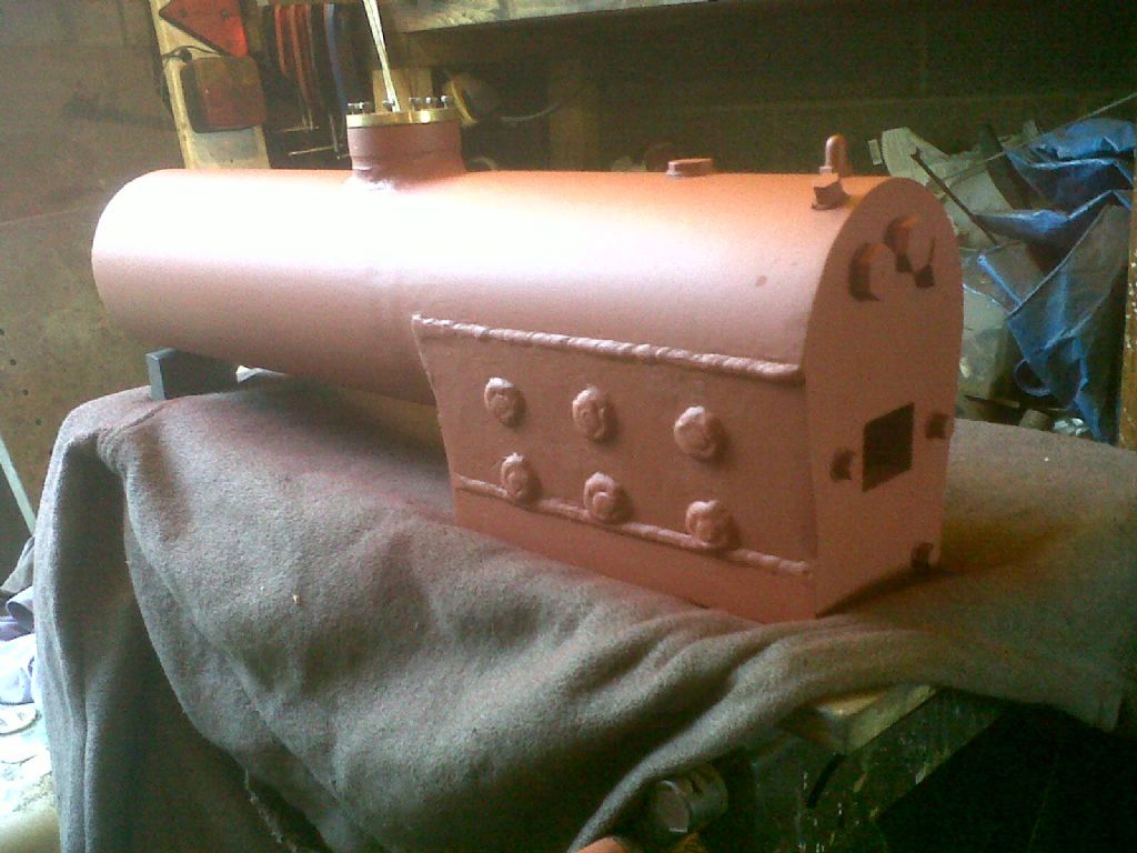

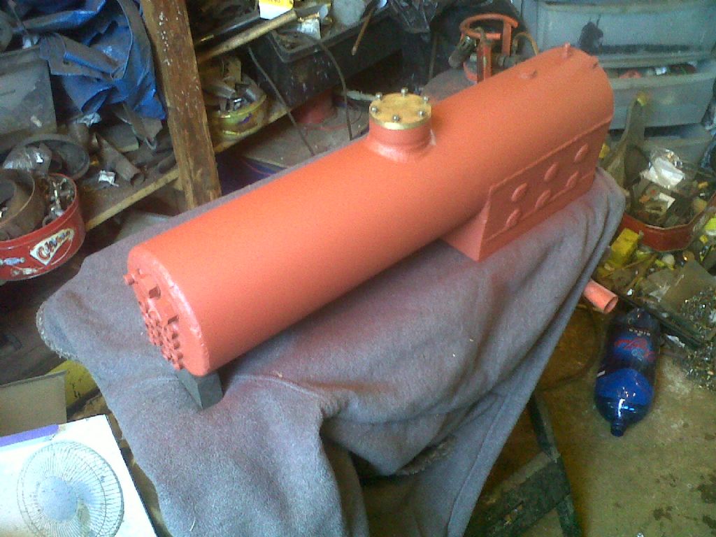

                iTS FINALLY OVER!! I went into the workshop at 8 this morning abd came out nearly 12 hours later – 5 cups of water has kept me going all day! Ive silver soldered the tubes in today, but to be super sure of a good joint in the firebox I separated the firebox section of boiler from the main boiler tube, that way I could get at both sides of the joint. Managed to slightly burn a tube but nothing major. I then soldered the tubes into the end plate before weldint the lot back together – propper hot root run followed by a hot fill and cap run. I will need the joint testing and certifying but its a small price to pay considering I was quoted £2500 for a copper boiler with a two year waiting list. Ive had it up to 170psi with the odd weep around the bust plugs, just needs a bit of ptfe tape to sort. Going to get it to 200psi tomorrow, then weld cert and finally to the inspecter. Costs are: Plate £50, Tubes £60, silv solder £22, allow £20 for various gasses and wire, £60 for the weld test and cert and probably another £50 for 'stuff', and you can see It still cost under £300 all in. If I were to make another there would be so many things id do differently, ive learned a lot on this project.

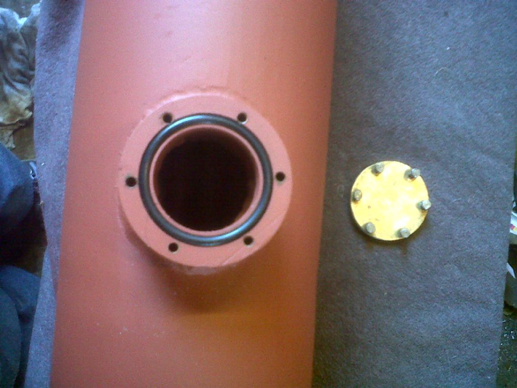

                              Pressure tests concluded – one spirt aside a tube, and a very odd weep on a stay weld. The tube squirt went away after reheating the lot and throwing another £20 of silver solder at it and a quick grind and reweld around the stay sorted that. Holds 250psi all day now. I will post some pictures of it finished so some of you can tell me how the boiler tube spacing is all wrong!!

                                    #99085
                                    nigel jones 5
                                      @nigeljones5
                                      I painted it for you…will be black eventually.

                                                I hate to tell you this Fizzy, but that blanking plate is far too small
                                                #136854
                                                Carl Wilson 4
                                                  @carlwilson4
                                                  Hello Fizzy,
                                                  Fantastic work. What is the spec of the steel you are using?
                                                  Thanks, Carl.
                                                  #136859
                                                  Ady1
                                                    @ady1
                                                    Looks great
                                                    How close to budget did you get?
                                                    Looks like less than 500 quid
                                                    Was it a cheapo welding set you used?
                                                    Would you make the plans available?
