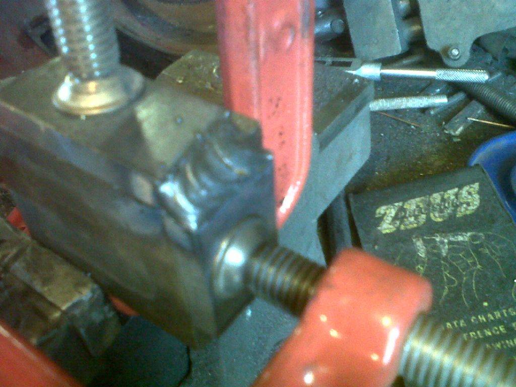

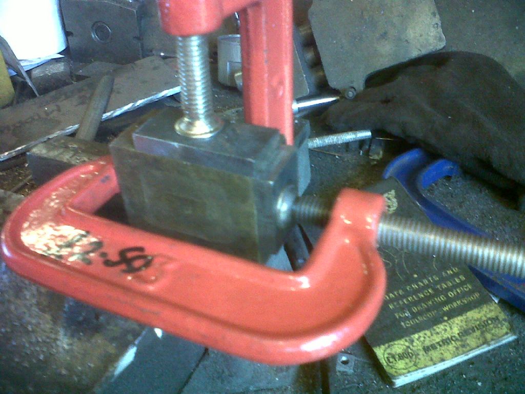

            #96696
            nigel jones 5
              @nigeljones5

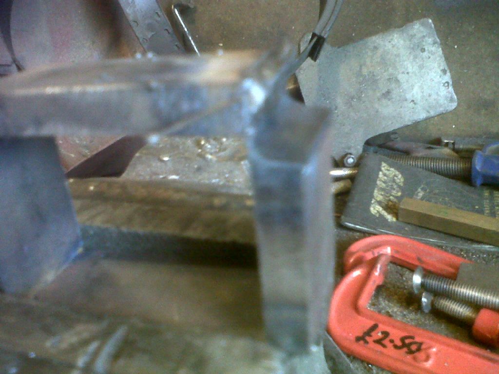

              held in place by brass block ready for tacks

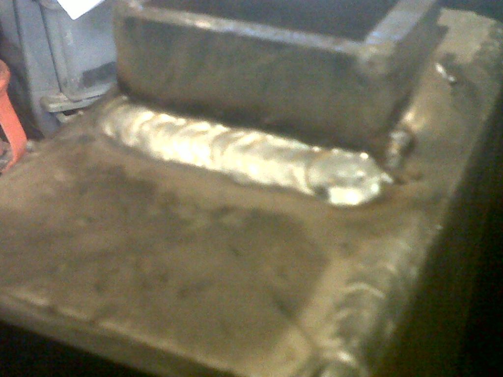

                welded sound

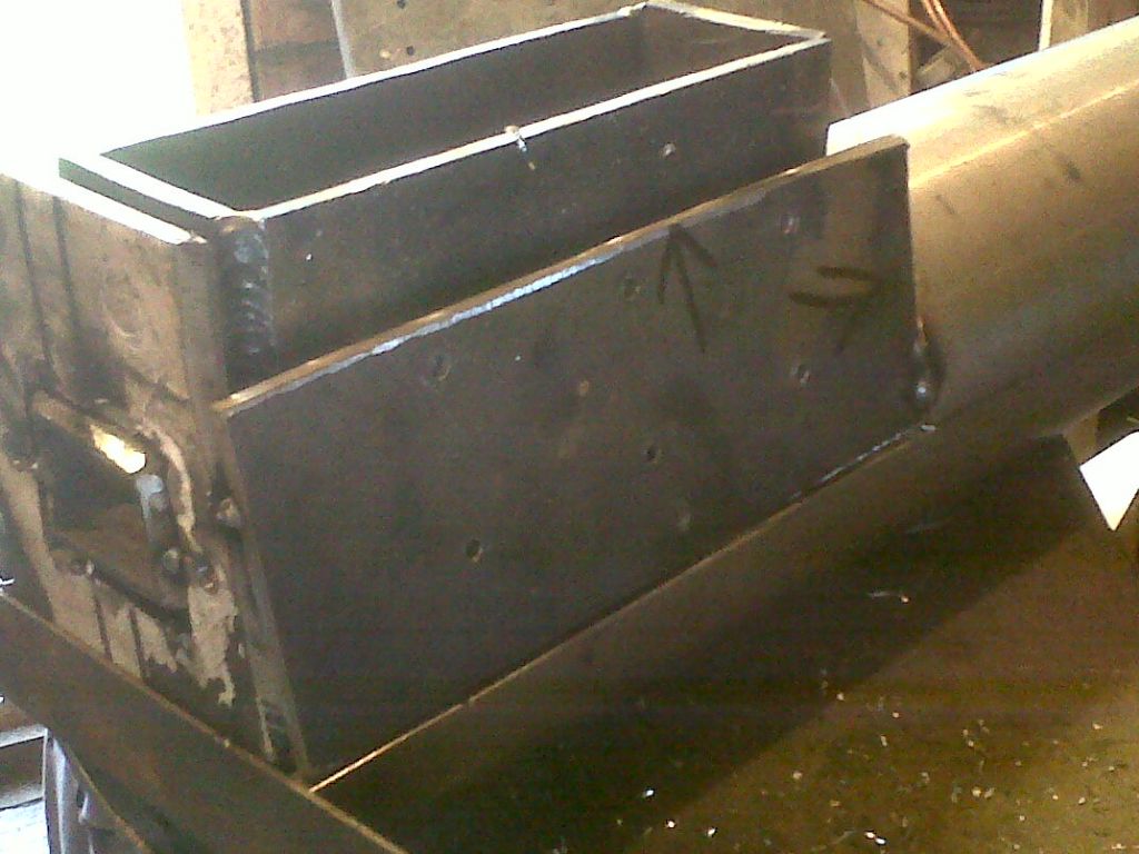

                    #96700
                    nigel jones 5
                      @nigeljones5
                      side tacked on. stay holes drilled through

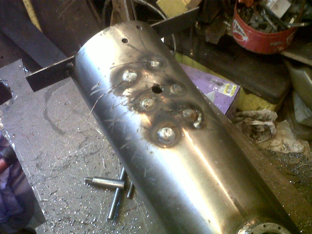

                          time to weld crown stays in

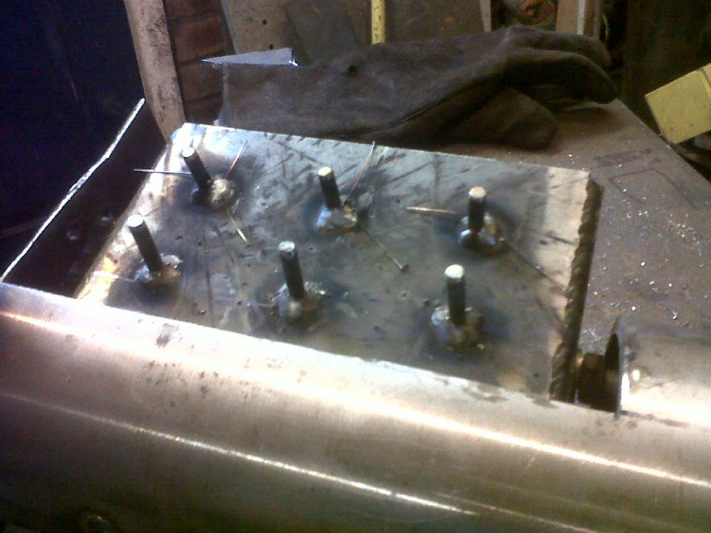

                          #96703
                          nigel jones 5
                            @nigeljones5
                            first row of stays welded
                            #96704
                            nigel jones 5
                              @nigeljones5
                              all stays welded

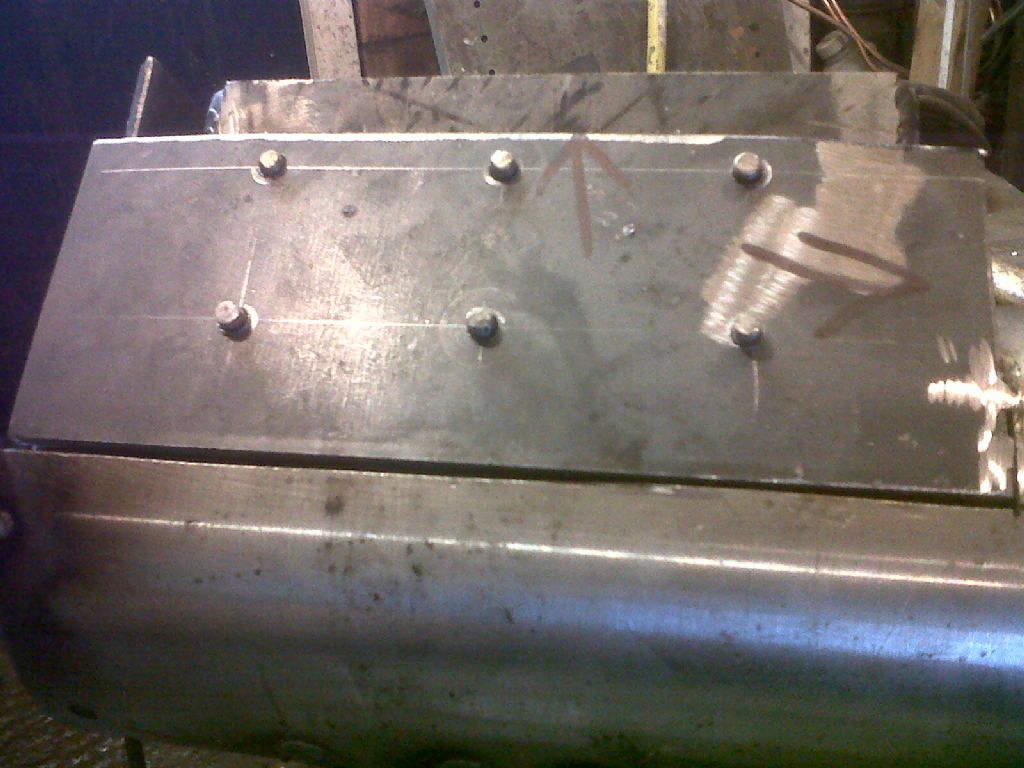

                              #96705
                              nigel jones 5
                                @nigeljones5
                                stays in place

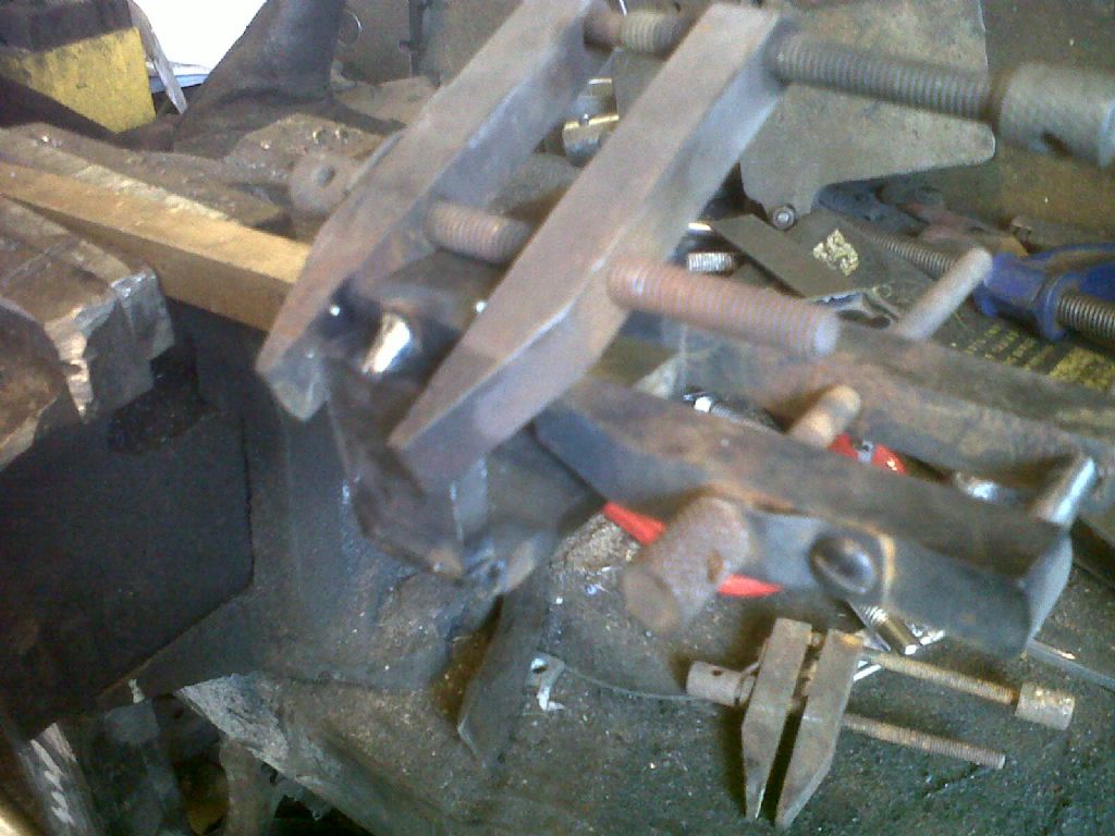

                                #96706
                                nigel jones 5
                                  @nigeljones5

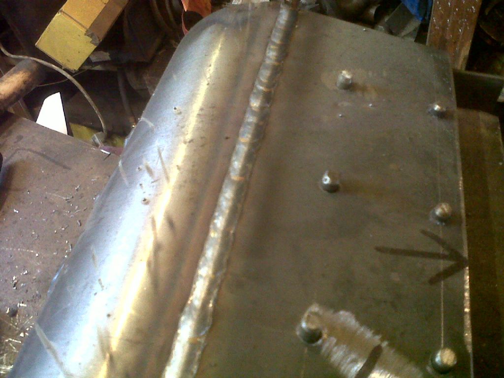

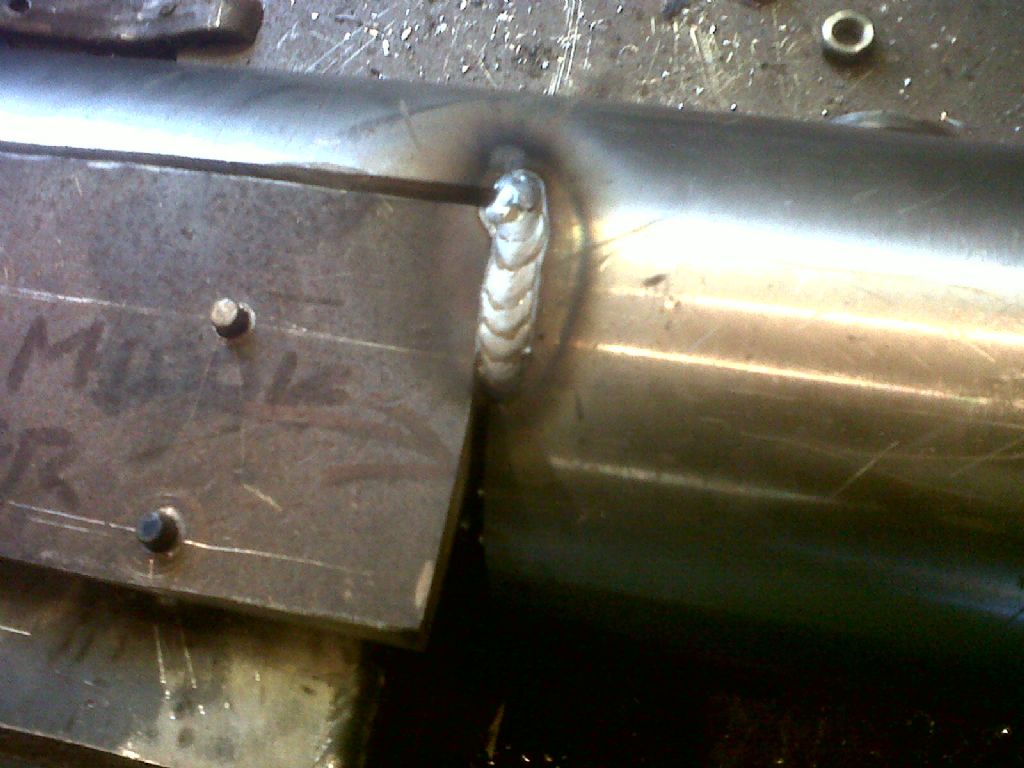

                                  first side weld

                                      next side weld

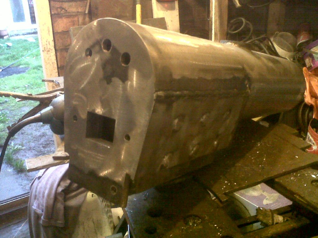

                                        back head welded and dressed, stays welded

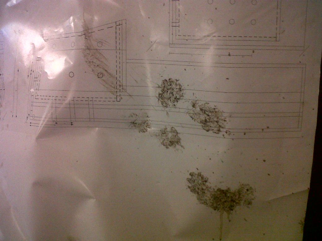

                                          took me ages to design this, and the dog just paddles all over it!

                                            thats all for now folks. spent the last hour getting clean. Its looking better than I anticipated. Welded at 170 amps with .6mm wire. 190A on .8mm would be better but this is the max my hobby mig will go. Its just on the start of spray transfer on max setting – need a new tip now. Hope you like the pix!!

                                              That's some very nice welding Nigel smiley
                                              #96725
                                              Springbok
                                                @springbok
                                                Well Nigel to say impressed is an understatement, It would be interesting to hear about the boiler tests.

                                                    Unfortunately it takes a lot of trigger hours to get a diy welding set to do that…I would have been much more at ease with a boc 500! The welds would have been better aswell! I was a profesional welder for 6 years, bit rusty now. I recon that if you prepped, tacked and braced the job it would take no more than 5 minutes to do the lot on a professional welding set. It wont get finished for a couple of weels due to holiday but I will try to take pictures when it does.
                                                    #96793
                                                    nigel jones 5
                                                      @nigeljones5
                                                      What about the boiler tests…100psi wp, test 250psi, if 6mm steel wont hold that i will eat my hat!
