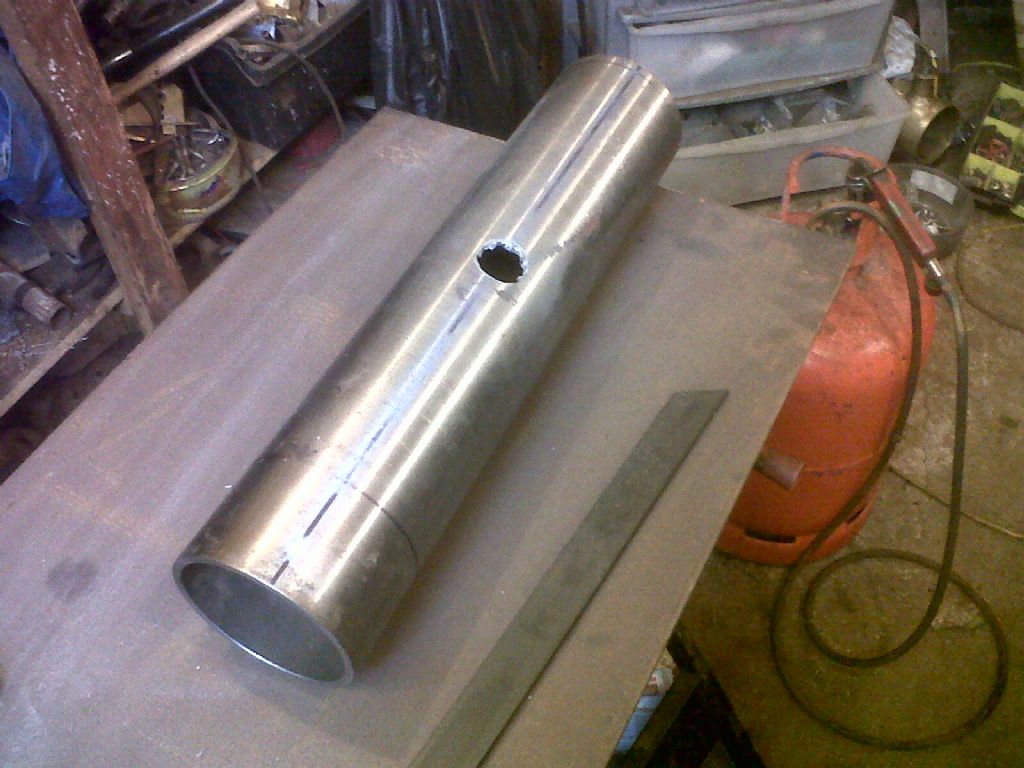

      Ive got the steel on order – 5" OD x 22" long, with certs, the designs are almost complete and ive got a copy of the blue book. Im trying to make it for under 200 squids!! Im going to do a build update if anyone is interested. Ive done all the calculations and it should steam just fine. I would be interested to know what the smallest dia tubes have worked for you – these are 13" long. My calculations make certain assumptions so ive got a little room for manouver on tube size – more and min dia is what i want. Coming out at 7/16 od but would like to know if yours are smaller. If youve got first hand experience of something like this then I would welcome input, I dont mean to offend anyone but if your going to tell me how it cant be done without having the data to back it up then……(im fedup with hearing people tell me what wont work without them having any proof to back their statement up).

          Well My fowler has a 4 3/4" copper boiler so ID will be about teh same as your steel one, that has 21No tubes 7/16" dia, not run mine yet but others I have driven steam well.
          Yes would be interested in tehbuild, we like plenty of photos to go with it. The next traction engine I'm going to do has a steel boiler and would be interested in doing all the weld prep etc myself and just getting it welded up.

            Boiler now wellunderway – photos to follow. Drawings revised as per inspecter requirements, all materials purchased, TIG set serviced. All the time consuming parts are now cut, drilled, honed. Even welded the dome bush on! Im still undecided as to whether to expand the tubes or silver solder them. Just need a 1/2 x 32tpi tap for the wet header.

                  Im having all the welds professionally tested by a NDT company, quote for test and written report is £60. The whole job will take less than 5 minutes. I will take pix of the weld preps also. Preps are something which requires a lot more thought than you would imagine! All welds are to be full strength, full penetration. I had to submit a full weld profile diagram with the overall designs. Welding it up with the mig would have been very easy but I think tig looks much better.

                          dome hole cut – had to chain drill it astube steel too hard for cutter!

                            cutter teeth no more!

                                  boiler tube cut away. You can just about see the finished smoke box on the far right (and my scrap items box on the left)
