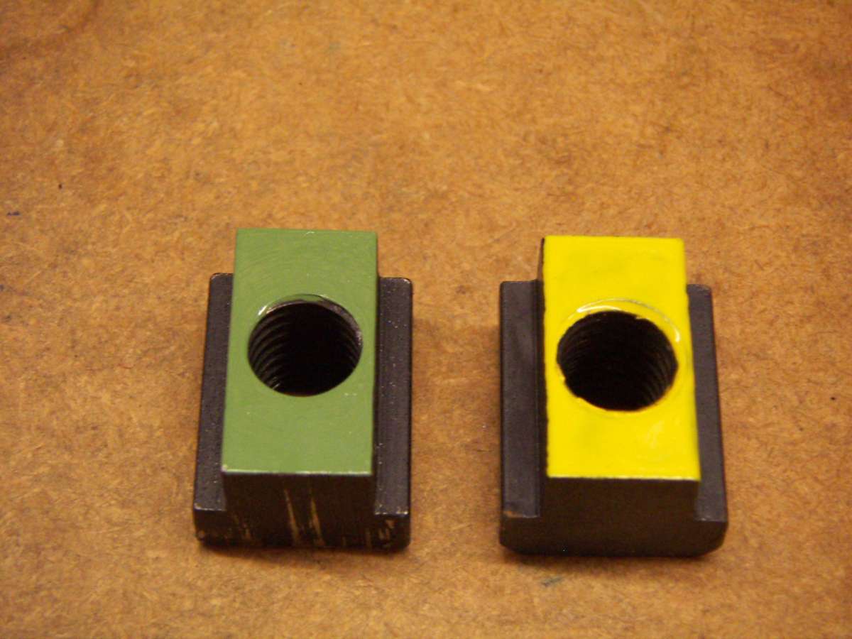

                #721918
                  The aim, to prevent the bolt jacking the nut against the flange and breaking that, is a point that is often made on here and elsewhere, so I am bit surprised you imply letting the bolt run right through the nut.
                  Using Bolts is the way you will risk damage to your tee slots as when tightened they are driven deeper, far less likely to happen with a stud and nut
                  Well the Emco supplied Tee nuts are threaded right through and after 44 years of use I have not done any damage to my tee slots on whatever machine or accessories they or home made nuts have been used on. Most of my commercially bought M10 Tee Nuts do have a no through thread but not all and even using these I have not damaged anything when using them with studs and nuts.
                  I do use some with bolts such as holding by mill vice down but they only get used with that and bolts are a length that won’t reach the bottom of the tee slot.

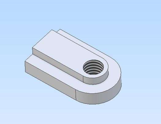

                  Nicholas Farr
                    @nicholasfarr14254
                    Hi, I’ve made nuts from flat bar, and threaded them right through, as it’s much easier than stopping it the right place, but what I do is stake them on one side with a dot punch in four places, which stops the threaded rod pushing through.
                    T nut 3
                    Using threaded rod and nuts, is less likely to jack the T slot up, but if the nut galls up on the thread for any reason, it can be like having a bolt. If you use stainless steel threaded rod, don’t use stainless steel nuts, use ordinary mild steel ones instead, but it’s always best to put a drop or two of oil on them anyway.
                    Regards Nick.

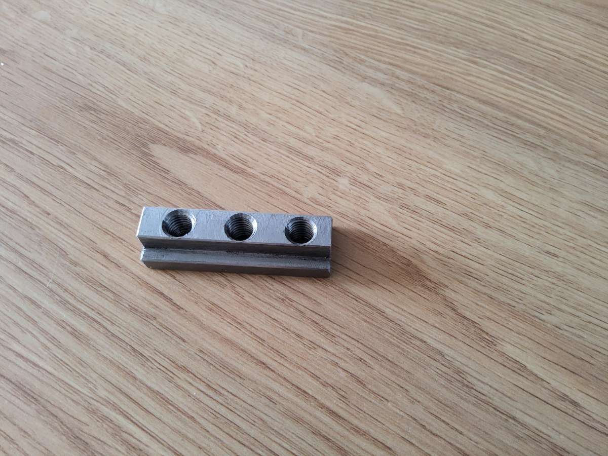

                                                David George 1
                                                  @davidgeorge1
                                                  I have sets of T nuts which are strips with three holes tapped with both 6mm and 8mm threads. They use a larger area in length  which is usful as you can slide the strip along the T slot so the choice of screw position can be from right at the edge to very near to the center of my rotary table without breaking the T slot.
                                                  An 8mm one.

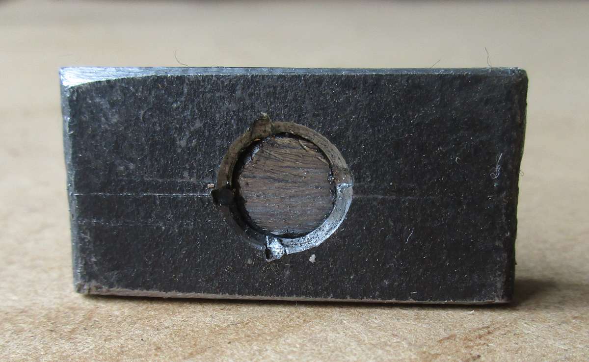

                                                    I also found it useful to round off the end a couple of tee nuts so I could get as close as possible to the ctr of the table when needed
                                                    tee nut
