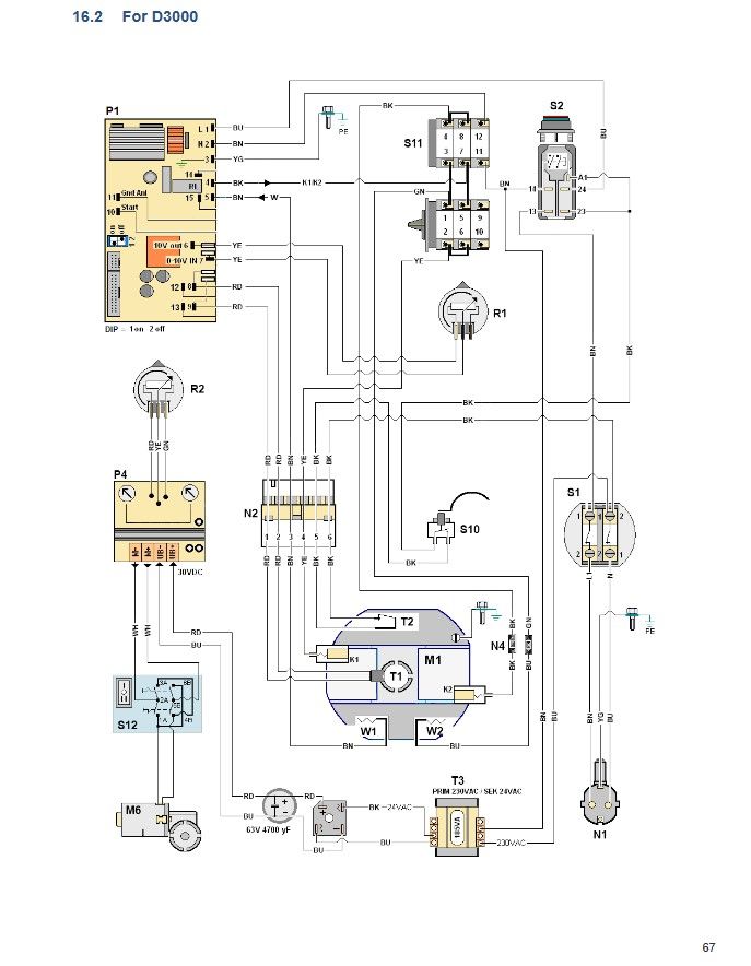

      Hi, the control board on my Wabeco d3000 lathe has gone bad. Wabeco no longer carry parts for the lathe so I am at a bit of a loss what to do. The motor is rated at 1.4kw but that’s the only information they give. I take it that it’s dc motor but can’t be sure. There is no label on the motor itself. So my question is would the motor be dc ? Is there a control unit I can buy to bypass the old board. Or is there a motor upgrade that would suit. Thanks. Michael

          I expect so. Change it for a 3 phase motor with VFD. A far better system.
          #605686
          John Haine
            @johnhaine32865
            Does it have brushes? If so it's a dv commutator motor. Several companies supply industrial drives suitable, Google KBE. But the motor might be a bit elderly and the brushes needing replacing anyway in which case a 3 phase motor and VFD upgrade would be a good approach.

                Here's the circuit diagram from the manual:
                Assuming the problem isn't confirmed by magic smoke from a cooked control board!
                The manual says the brushes should be sanded down every 100 hours and the commutator cleaned. Plus advice to check in the event of a stoppage that the plugs and sockets haven't vibrated loose. If that's been done, I'd check the usual other mini-lathe weak-spots before rushing to change the motor or board:
                1. Check the safety cut-outs are all allowing power to reach the board:
                  • S10 – switch on chuck guard closed
                  • T2 – thermistor on motor closed
                  • S1 – Emergency cut-off reset, not popped open
                2. Confirm the speed control potentiometer is working – they often fail by going open circuit. A squirt of switch cleaner might get it going, or replace
                The manual says the motor is single-phase, and the circuit shows 8 connections:
                • Pair to Thermistor, disconnecting the mains if the motor gets too hot.
                • Pair from Tachometer to board providing speed regulation. If this failed would the motor run fast, slow or not at all?
                • Pair to K1 and K2. I guess these are the field winding and may be fused. If fused, this pair may be the main power input. Check for fuses – I don't recognise the circuit symbol, but it could be an inline fuse. I can't see anything else that might be a fuse,
                • Pair to W1 and W2. I guess these feed the armature and are fed a control voltage from the power board.
                The claim to be a single-phase motor might make sense if this was a simple triac triggered speed control circuit, but I don't understand what the brushes are for. They suggest a DC motor, or is there a type of AC motor with brushes?

                  A motor with brushes, a commutator (segmented rotor contacts) and a wound stator (not permanent magnet) will run on AC or DC. For this reason they are often called a "universal" motor.

                      The two "W" connections are more likely to be the windings and the "K" connections brushes as Kohlenstoff is German for Carbon

                          Almost certainly a wound field DC motor, commonly used for larger sizes rather than permanent magnet field. Many controllers have an output to drive the field winding. A series wound motor is very unlikely in a lathe because it's speed torque curve is very unfavourable.
