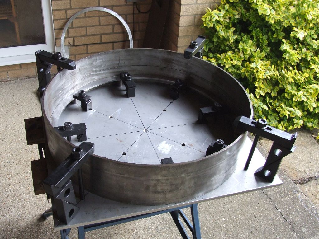

                      I agree with the comments regarding a clamping kit. I made a handful of clamps as per Harold Hall's instructions, and they cover most of my clamping needs. An angle plate is also very useful here. On odd occasions I do also use a vice; mine is one of the precision toolmaker's types from Arc (usual disclaimer etc etc).
                      I should also point out that I started out with just a lathe, no mill. My first clamps were made on the lathe, for clamping work down to the cross slide etc. The simple clamps encouraged by HH can be made with nothing more than a drill and a tap. Slots are a luxury!

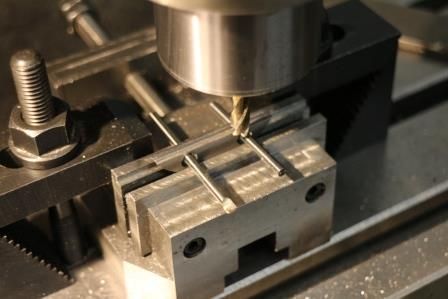

                        I'd advise against sets in general.
                        I have to be careful here as my mills are large in comparison to the SX2. But I'd definitely go for a suitable machine vice and a set of clamps. I use clamps a lot. I've got 8 sets; two 1/2" sets for use on the lathe faceplates and six 5/8" sets for milling. To fair I do have three mills, and it can be easy to run out of clamps if you have several setups on the go. Clamps are also useful for more general fixtures, like wheel welding:
                        Although my vertical mill is R8 I have very few R8 collets. For general work I use ER20 collet chucks. I actually use the Tormach TTS system on my manual mill as well as CNC as it is more convenient. You'll also need at least one drill chuck; I do 99% of my drilling on the vertical mill. The pillar drill is used once in a blue moon. I mostly use 6mm and 10mm cutters in sidelock holders and ER collet chucks for other small cutters. For larger cutters I've got a Clarkson lookalike chuck, but they're probably a bit big for the SX2.
                        Other accessories such as angle plates, box, cubes, boring heads, rotary tables and dividing heads can wait until you really need them.

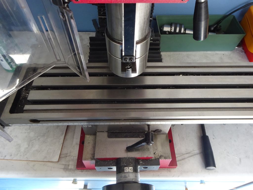

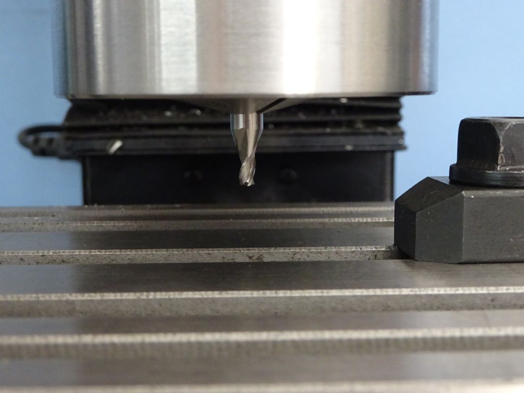

                            Although finger collets will give you a bit more head room and that is the only time I may use them they can be a bit of a PITA for smaller work which Ron is likely to be doing with a Mini-lathe and SX2.
                            This pic is of the next size up SX2.7 from normal operating position, unless you are a 3'6" midget or like to stoop down to work your machines you can't see what you are doing.
                            As you can now see there is a 3mm FC-3 cutter in there and you can also see that if you want to hold work with clamps the quill stops you getting anywhere near it unless you are working in the middle of a large item.
                            So for me the ER-25 holder in the No3 set is a good choice or even an ER20 would do then a finger collet if you wanted to hold larger than 12mm, on my slightly larger X3 I use ER32 for 95% of what I do but could get away with a 25 for the majority of that.
                            I also use my clamping set quite a bit but that is often determined by what type of things you end up needing to hold, a lot of what I do on the larger engines won't fit a vice so it needs clamping but a small engine may almost all fit in a vice
                            Edited By JasonB on 05/10/2018 12:25:35
