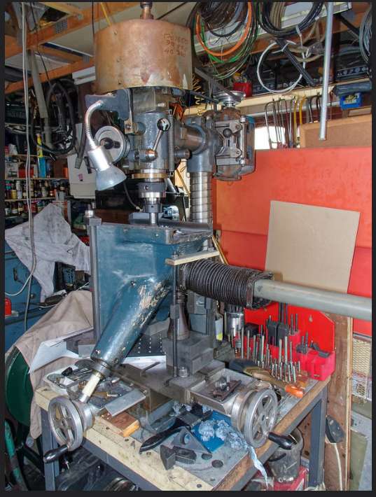

                peak4
                  @peak4
                  Until I picked up a very cheap Centec 2B I found the Dore Westbury a reasonable pairing for the Myford, not least because it used the same nose thread.
                  It’s certainly not as rigid as some other offerings, and doesn’t have a table power feed as standard, but it’s certainly quite versatile, with a capacity beyond its initial appearance.
                  Mine is a long column one, with the column passing through a hole in the bench top.
                  I certainly couldn’t have done a job like this on the Centec
