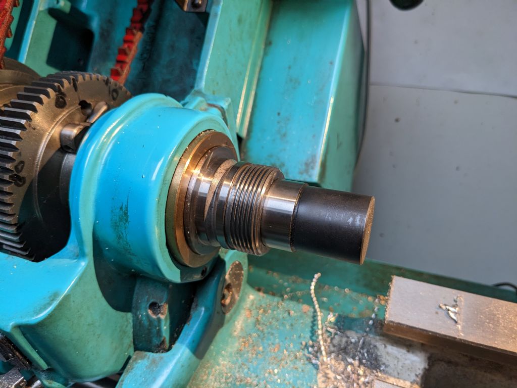

                I think that you could buy or make an MT4 adapter that would take R8 tooling – just a shell with MT4 outside and suitable taper and parallel portion bored and a simple pin as a key. R8 tooling is very common for larger mills. I think it's also possible to make at least a shortened MT4 "plug" that will take a BT30 / ISO30 taper – again a very common style with lots of tooling available.
                I have a VMB with R8 spindle and mainly use R8 collets which are cheap and grip extremely well. You might even consider making a, adapted sleeve and loctite it in place! Though as it's an MT4 taper anyway it will probably lock itself soon enough!
                I also looked at making an adapter so I could fit a BT30 taper into the MT4 spindle on the S7 to make a short ER16 collet chuck – as I recall it looked quite feasible hence my suggestion.

                    Here's a blank end R8 arbor resting in the mouth of the taper on my big-bore S7. There would be plenty of room to make a sleeve though it would have to project perhaps 10mm beyond the outer end of the MT4 taper.
                    Here holding a BT30 taper in the mouth – again with a bit of projection on the sleeve there's plenty of room.
                    With an R8 adapter you could fit collets straight in which are great for holding and consume minimal daylight under the mill head. For BT30 you can get a wide range of collet chucks (this one is ER16), and even direct-fit BT30 finger collets. However MT4 collets are like hen's teeth.
