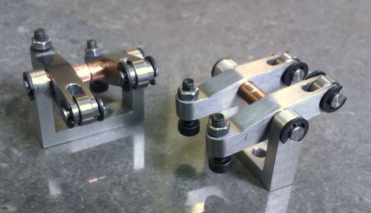

            In the past I have run a Dremel cut off disk up against the rod to cut grooves. These days I use a Minithin parting tool with suitable width bit. As Has been said such a small diameter will want to climb over the tool so keep stick out to the minimum. If you chuck is worn or not closing down well then make a larger split bush of larger diameter.
            These are 3mm Silver steel grooved 0.6mm wide for the E-clips The inserts have very little top rake.

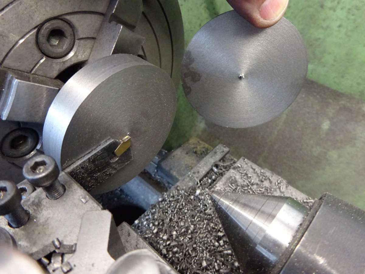

                                    Bit more Front mounted inspiration for those that may need it, First image cut dry.
                                    DSC02442
