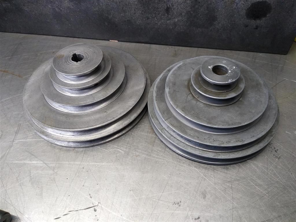

                I have a Meddings motor pulley but it's 153mm diameter at the big end and 40mm at the small end. It's from a Pacera MF4 drill.
                What size shaft on your motor?

                      Andrew it's a 5-way pulley 63mm tall. I could bore it to 19mm for you. it needs boring anyway as the bore is slightly bell-mouthed from previous poor fitting. I also have the spindle pulley.

                            Pete, thanks for the pulley offer but it won’t work as the ratio of pulleys needs to be the same as my old one to use all 5 speeds.
                            Can you give me some advice on the best way to bore a new one as I don’t want to make the same mistake as before?
                            Should I buy a 19mm reamer?

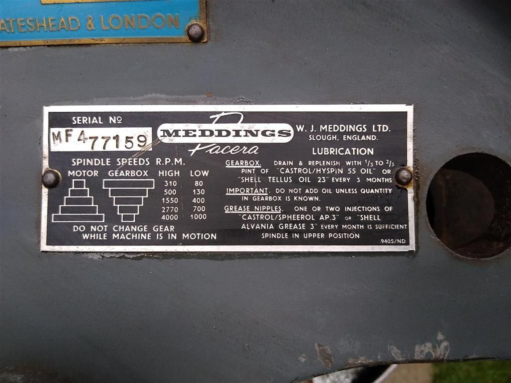

                                My pulley set gives the speeds shown on the tag.
                                Neither are in terrific condition so you could have the pair pretty cheap with the belt. The motor pulley for sure needs boring out. That said, the advice of sleeving and re-boring your original is valid. Loctite a sleeve into it, bore back out to 19mm then cut a key it will last for years.

                                    Hi Pete, I didn’t think about changing both pulleys what would you take for them?
                                    #470682
                                    Pete Rimmer
                                      @peterimmer30576
                                      If you pay the postage you can have them for £20. I'll bore the motor pulley to 19mm for you.

                                          There's no pulley on the spindle, but the gearbox input pulley which is what I think you mean pulley is 9/16" bore.

                                              Ah yes, different machine entirely. Mine has a 2-speed gearbox and 5 groove pulley for ten gears.
