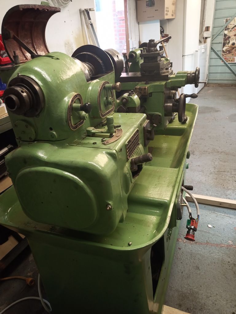

      Hi There,
      I'm a new member to the forum though did hold a magazine subscription for a few years, a few years back.
      I've just moved back to Gods Own County and bought my/our first house,) I knew my garage was begging for a lathe!
      By fluke I ended up going to see a Smart & Brown Model A a month back which looked in pretty good nick (minus the switch gear) and thought it'd be a steal.
      It was sold as 3 phase & motor not working, but a bit of work digging it out from the cabinet and it turns out its a Tuscan Engineering single phase induction jobby. Works fine, bearings sound brand new, sat on it's arse it runs smooth with no vibration or anything. Annoyingly, having just bought a nice lever arm reversing switch, the starter coil is hardwired in so it only spins one way, but I've got the lathe turning.
      With the belt slackened, the 3 speed gearbox changes fine, but I'm struggling to get the "direct drive" (Back Gear 'Out&#39 to function, and hoped someone here might be able to help. I have the book from Lathes.co.uk but it's somewhat lacking as a manual goes and I'm not really sure which model it is, whether its the Model A Mk1 or 1.5.
      On the same topic, I've got some fair backlash in the cross slide, any knowledge on where to start with thatone would be good. Plus, the headstock loves to fire out oil when it's running with the cover open – is this normal? And where should I be topping it up? The manual pump just has a dead cavity when I take the cover off. I'm sure I can work all this out in time but if anyone has some experience I'd love to hear it!
      I've applied to join the old yahoo group which I found in another thread here, but figured it may be worth asking here as well!
      I've attached some pictures below.
      tl;dr Hi, I'm new here, here's my new lathe – can you help me fix the "direct drive/"open belt" function?
      Thanks!
      Duncan

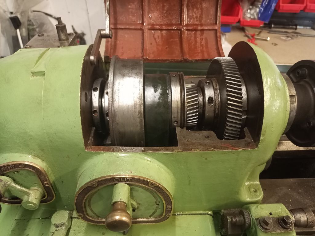

              Does look like a Mk 1.5 machine having the later back gear engagement but sat on the earlier style cabinet. If your problem is getting the back gear to disengage properly, you might have the same issue that I did 30 or so years ago with my Mk 2.
              Operated via the backgear lever, there is a multi tooth dog clutch inside the headstock pulley; this is held in place by three or four 3/16" BSF capscrews. If one of these breaks; as it did on mine there isn't the room for the screw remnant to escape completely, but it will often/most of the time keep the backgear from fully disengaging when the screwhead gets stuck in one of the opposing dog clutch teeth. An exploded diagram is pretty much essential as an aid to stripping the spindle down in order to get access to replace the capscrews. Being as I hadn't seen a manual and it was pre 'internet ubiquity' when I did this repair, I puzzled for many hours stripping it down before I found a hidden tiny pin which retained one of the many spur gears on the rear of the spindle.

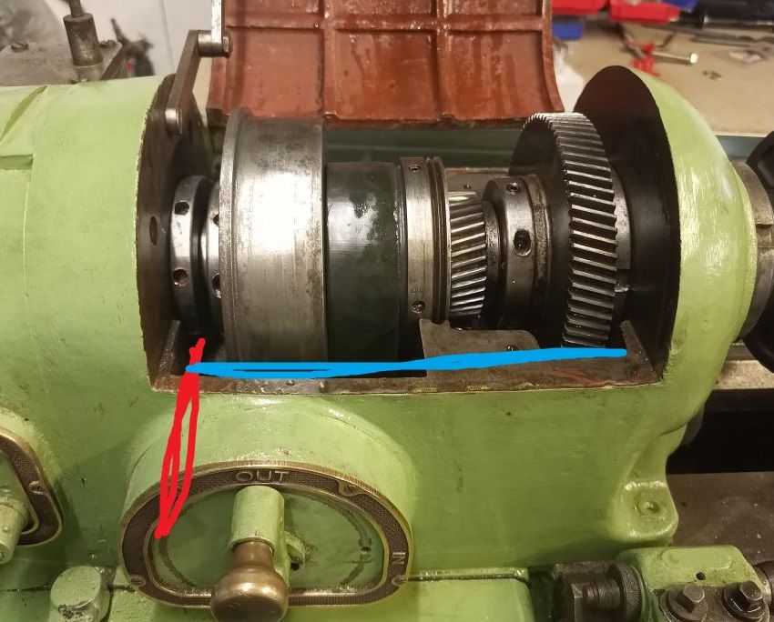

                  So your inner and outer spindles are not being locked together by the dog clutch when the back gear is disengaged? If that's your problem, the dog clutch either isn't being engaged when the machine is in direct belt drive mode or the dog clutch is engaged but the retaining capscrews that live inside the headstock pulley are either missing or have sheared off.
                  My problem was that the capscrew remnant in the dog clutch was keeping the inner and outer spindle locked together when the backgear was engaged. This of course meant that the headstock would not rotate when the lathe was in backgear mode.
                  As I'm sure you've seen already on your machine, the lever that engages the backgear also operates a fork that engages/disengages the dog clutch. The dog clutch needs to be disengaged when the machine is 'back gear' mode and engaged when it is in 'direct drive' mode.
                  #561505
                  Jinks
                    @jinks
                    Posted by Stueeee on 06/09/2021 11:17:37:
                    So your inner and outer spindles are not being locked together by the dog clutch when the back gear is disengaged?….
                    As I'm sure you've seen already on your machine, the lever that engages the backgear also operates a fork that engages/disengages the dog clutch. ….
                    Exactly right on the first one
                    No, not at all, in fact that was the question I was going to ask, as I cant see any way a clutch could be engaged at the moment.
                    As below, the "In/out" lever looks to turn the shaft in red below which in turn rotates the eccentric (blue) onto which the backgear gears are mounted – there doesn't appear to be any forks anywhere to operate the dog clutch and I haven't noticed them on the drawings – is there any chance you could indicate on one of these drawing roughly where I should be looking for it?
                    Thanks!

                      There will probably be a hex socket on the left hand face of the pulley, where the red line is on your photo. This needs to be turned about 180° to engage the internal dog clutch to lock the pulley to the spindle. Make sure it is locked by rotating the pulley by hand before starting the motor as otherwise the clutch will be damaged when the motor starts up.

                        From this photo I can see that you have the Mk1 backgear setup, I hadn't noticed that detail in your first batch of photos. So, Martin Connelly's photo looks to be what you should have.
                        This is the Mk 2 setup with the fork that engages/disengages the dog clutch as well as engaging/disengaging the back gear when the in/out lever is operated. Apologies for any confusion caused.

                          Stueeee – there is a little rectangular cut out into the top of the curve to the left of the lid, yours has a little handle in it but mine doesn't and it's painted shut – what does this cover?

                              The photos provided by Stueeee show the reason why your lathe spews out oil, there should be a cover for the backgears. It has no function but to contain the oil, so it might be possible to make something out of sheet metal. The screws which hold it to the headstock are 2BA.
                              With a shortened hex key, you turn the backgear lock clockwise to disengage the pulleys from the spindle, and then you can engage the backgears. After using the backgear, you first disengage the backgear eccentric and then using the hex key in an anticlockwise direction, the locking dog is sprung back into place to lock the pulleys to the spindle. If you hold the chuck and slowly turn the pulleys, you should hear the dog spring back into place.

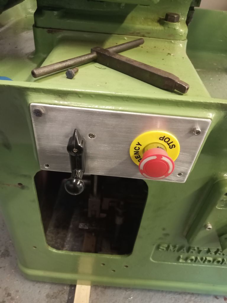

                                              Just thought I'd shoot an update with the switch plate roughly mounted, needs a lick of paint and the rev/off/fwd decal taken from the barrel switch adding but it works for now.
