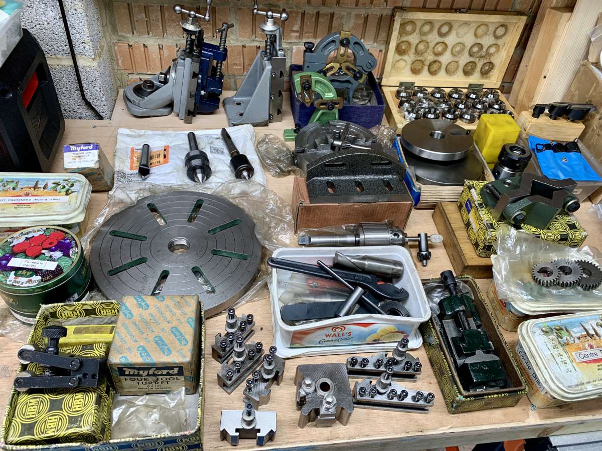

                    The Super-‘7’ came with a selection of tools & accessories, the majority of which are shown in the photo.
                    Also a thick file of hand-written notes, drawings, diagrams, photos & the original(?) + more modern Myford manuals for the lathe & the quick-change gearbox. Also a contemporary Myford brochure from back-in-the-day.
                    The previous owner sadly passed away a few years ago – he was an enthusiastic restorer of motorcycles & I believe a few examples went to a motorcycle museum after he passed.
                    It has been quite humbling leafing through this history of his time with the machine – I hope to carry on the story with some decent work of my own, as I too am a keen motorcycle enthusiast.
                    Many thanks to everyone for their positive contributions… 😎🇬🇧👍

                      You have done well!
                      Replace the ice cream/spread boxes with somethings more substantial. They get very brittle with time.
                      Also, you cannot have too many quick change tool holders.

                            Wow! Looks like you got the motherlode of accessories with it. Well done! And it sounds like the old gent took pride in his gear and looked after it so you should have a good set-up. Most of the accessories look barely used, so most likely the lathe is in the same condition. Like most of us motorcycle restorers, he probably only used the lathe on occasion as needed to make the odd part or two. Well done!

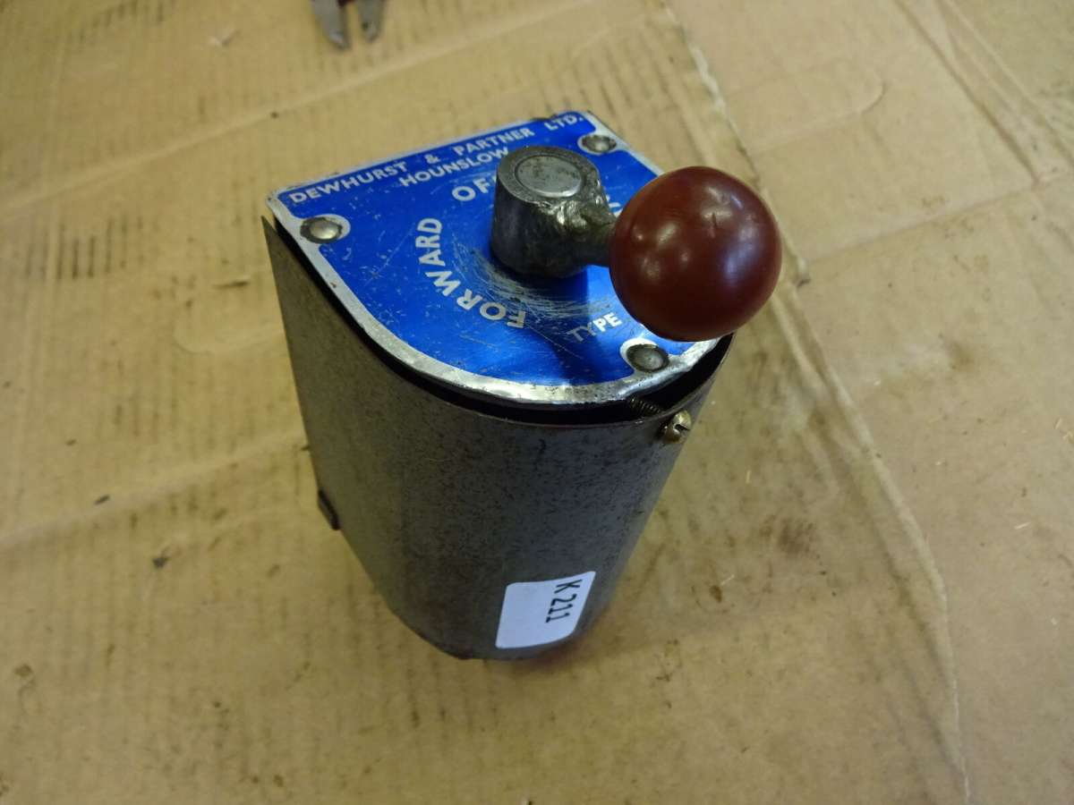

                              Who, apart from Hopper, believes that abused Myford Pattern Dewhurst’s last 50 years?
                              I see it this way.  Switch lifetimes are expressed in number of operations, not elapsed time.   A lightly used Myford Dewhurst, say on a 1950 machine that’s only abused 10 times a week, will clock up a mere 38480 operation in 74 years, so there’s a good chance it won’t be wrecked.    Same machine abused 10 times a day will clock up 269360 operations, and the switch will be hurt.
                              The problem lies in the design of the switch.   When the contacts open with power applied, there will be a spark through which current  passes as an extremely hot arc, which lasts until the contact gap grows big enough to snuff out the arc.   It is the arc that damages the contacts, causing severe wear.
                              When a switch is designed to make and break power, special attention is paid to minimising the arc.   For example, the contacts of a domestic light switch are spring-loaded, so their contacts open and close very rapidly.  In addition to spring-loading, beefier power switches add extra copper to destroy arcs by cooling them quickly,  and others blow the arc out with compressed air or operate in a vacuum.   The contact materials are chosen to resist arc damage, Tungsten, Rhodium, Platinum and such.  All a bit pricey.
                              The Myford Dewhurst has none of these features because it’s a plain reversing switch.   What’s supposed to happen is the motor is turned on and off with the main power switch, and the Dewhurst contacts only moved when the power off.   Done that way the Dewhurst doesn’t experience any arcing at all, and should last donkeys years.  The Myford Dewhurst is a sensible answer, provided the operator plays ball.  Trouble is that too many owners don’t read the manual.
                              I’m pretty sure Dewhurst switch problems are mentioned in my early 1960’s ME magazines, and the issue is common knowledge today.   Part of the problem I suspect is the chunky good looks of the switch.  It lives in a hefty case and is operated with a whacking great ball-ended lever:
                              dewhurst
                              Looks as if should be able to switch megawatts forever, but the reality it’s not, and was never intended too.   Though a rather old-fashioned drum switch, I’d I’d say it’s fine, provided previous owners haven’t beaten it up.   The innards of the Dewhurst are one of the first things I’d inspect after buying a Myford.   All smiles if it’s been looked after, but all too many will be more-or-less damaged.
                              Abusing the electrics is a common problem on Far Eastern lathes too!
                              #733327
                                You make a good ‘electrical’ point, Dave … but there is also an Ergonomic issue, of Dewhurst’s making.
                                The Central OFF position is an open invitation to abuse the switch !
