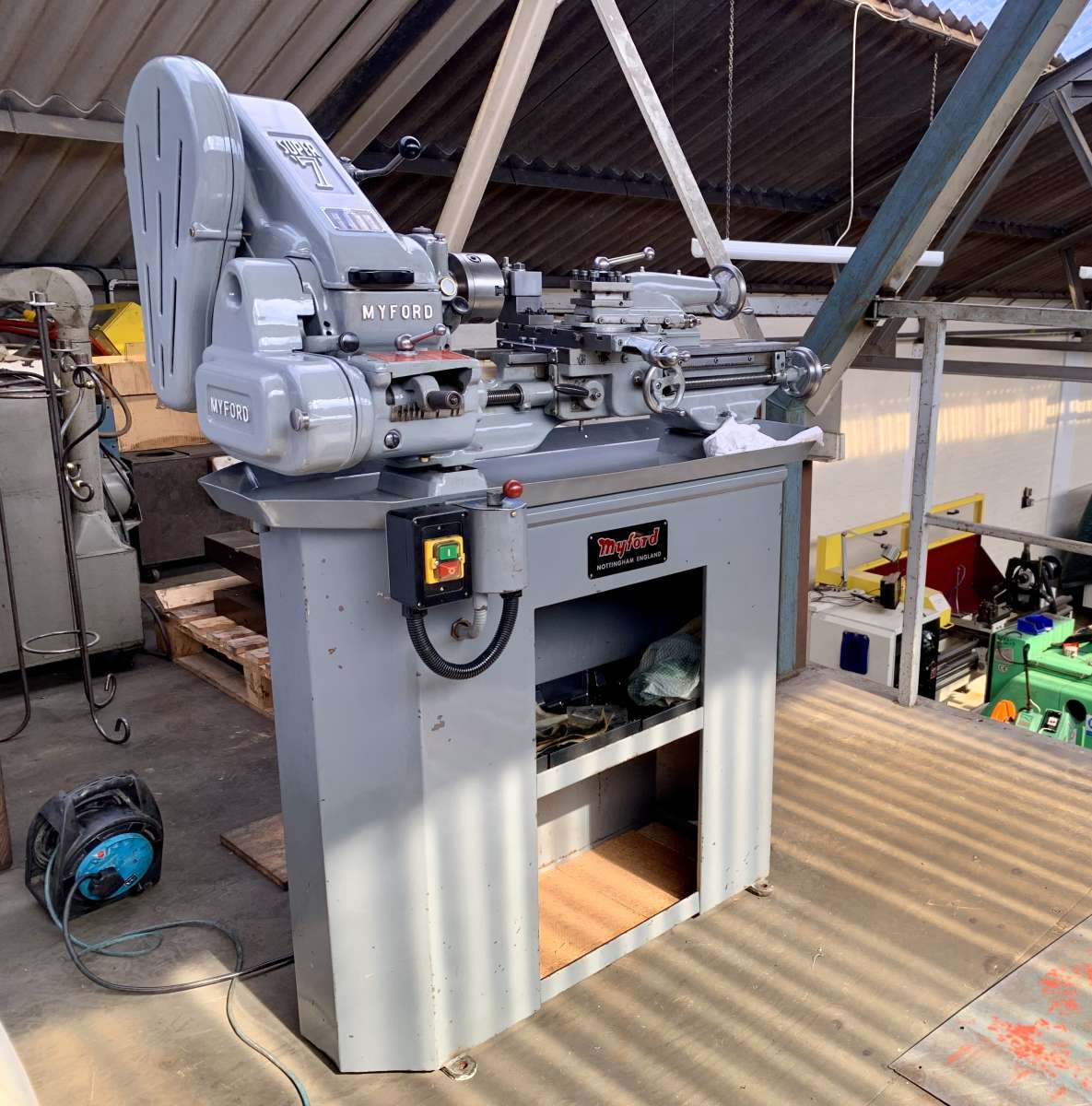

                                            #733087
                                            flatline
                                              @flatline
                                              I found what I was looking for👍IMG_2893
                                              #733099
                                                Hopefully the mechanicals are as good as the recent paint job. With luck the extension lead allowed you to try it cutting metal which is always a good idea.

                                                JA
                                                  @ja
                                                  It could be my old S7!
                                                  It was a good lathe. I put a lock on the top slide (as Geog. H. Thomas).

                                                  #733147
                                                    Hurrah!   Please let us know how you get on with it.

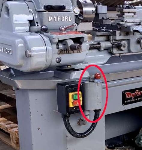

                                                    You probably know this already, but there are a few Myford booby traps!
                                                    1.   The Dewhurst switch is an old-fashioned design, not really man enough, or intended, to switch the motor under power.  Doing so consistently gradually destroys the contacts, forcing a replacement.   Purists like to replace with another Dewhurst, because, unlike most modern switches, the Dewhurst matches Myford styling.   Unfortunately, Dewhursts haven’t been made for many years, and are getting hard to find and pricey!   If you have a Dewhurst in good-nick, don’t abuse it!
                                                    dewhurst
