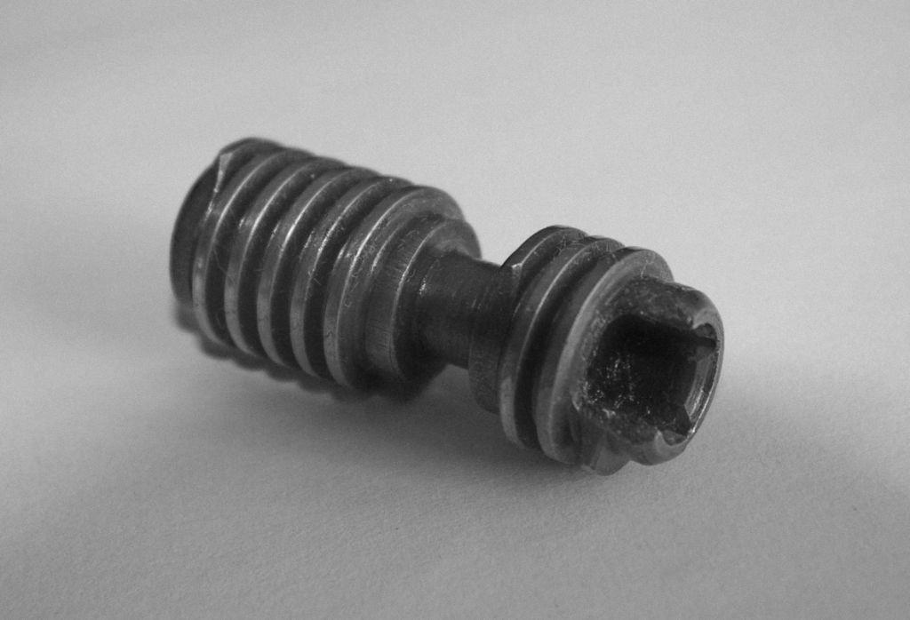

                            #67154
                            Steve Garnett
                              @stevegarnett62550
                              So I took one out. In this particular chuck, the screws are located by a yoke that projects forward from the rear of the chuck, fitting around the groove. This can be driven out with a small drift, so at least it’s easy to replace afterwards. In other words, the jaw looks like a normal chuck jaw when you’ve removed it, and the screw bears some sort of resemblance to the one shown in the article:
                              The eagle-eyed amongst you will realise that this doesn’t have a Whitworth thread at all, but appears to be a LH Acme thread. The diameter of the groove cut into the thread is just over 8mm, so drilling it out for a spigot, grinding off the top and silver-soldering a suitably turned-down hex-head bolt looks like a distinct possibility.

                                Slight snag – apart from the broken bit at the top which appears (presumably because of repeated fatigue) to be quite soft, the centre of the screw is rock-hard, and won’t drill at all without softening it. I suppose that this won’t matter if I can grind off the rest of the broken top, and solder a much shorter hex-head into the small recess. I’m open to other suggestions though. How else could you realistically do this, preferably without having to soften the screw – or is that the best thing to do? I don’t have an EDM, unfortunately, and I have four of these to do.

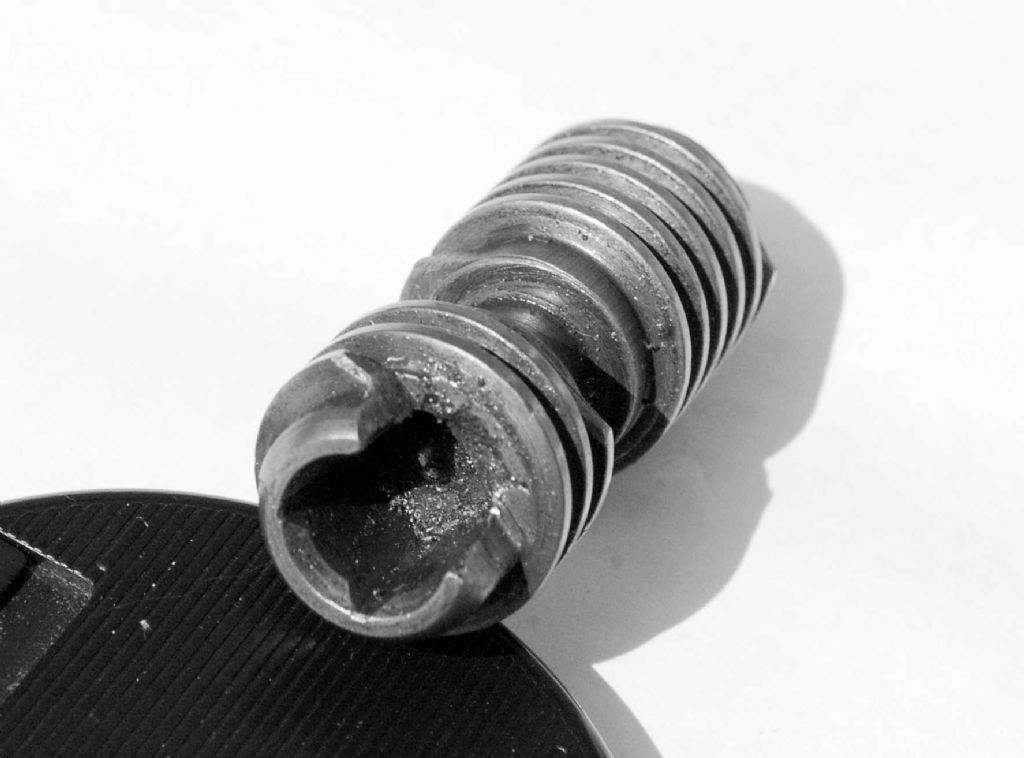

                                  Steve Garnett
                                    @stevegarnett62550
                                    Thanks for replying, John. I suppose that the answer is that I’m not sure. I’ve had another go at photographing what’s really happened to the socket at the end, but I don’t know how much clearer it is – perhaps a bit:
                                    The socket is square down to the bottom, which is about 2mm below the flat surface I filed at the end of the thread, which is the softer part. You can just see the tip of my attempt to centre-drill this if you look carefully.
                                    Having thought about it some more, what I’m now wondering is two things; One is that I’m intrigued as to how the hell they make these square holes in the first place, because I’m reasonably confident that they didn’t use a wobble-broach as a mass production method, and the other is whether I actually need to extend the hole down deeper anyway. The idea that I currently have is that if I can find a suitable size hex-head bolt, I could clean the rest of the screw surface flush with the broken side, and reduce the bolt thread so that it’s only 2mm long, and file it square, and then silver solder it in place. That is, assuming that I can get everything clean enough, and don’t screw up the soldering.
                                    The dremel is a good idea though – I have some diamond burrs, so even if it only cleans it up, it’s worth it.

                                      Steve Garnett
                                        @stevegarnett62550
                                        As in repair the original square socket, you mean? That might work on two of them, but the third one is way worse – it’s broken out on two sides, not just one. The other thing that’s not visible from either photo is that this one is starting to crack in another corner, as well. Which will make it as bad as number three in no time…
                                        The thing I’ve now realised is probably how they make these. You drill a hole, and notch the corners with something rather powerful – which makes me think that perhaps the manufacturing process leaves the material with four relatively weak spots. The wall thickness in the corners is only about 2/3 of the side thickness around the rest of the socket head, after all.
                                        But I’m bearing all these suggestions in mind, certainly. Fortunately there is absolutely no rush to fix these screws, as presently it’s a spare chuck anyway. If I can get it sorted one day, it will most likely get used on a rotab, and not for higher-speed turning as such.
                                        Any more suggestions or comments are welcome – I still haven’t got the best solution sorted in my mind yet.

                                              Steve Garnett
                                                @stevegarnett62550
                                                Thanks for the replies, guys. I’m pretty certain that I’ve got to do something which involves silver-soldering, but it’s a bit of a moot point as to what. The idea of reversing the polarity of the driving sections so that they are male instead of female is intriguing – the only thing that concerns me about that is that it would inevitably leave parts of the shank projecting beyond the circumference of the chuck, if I only used the 2mm available, and that they’d have rather sharp edges!
                                                OTOH, Les’s point about what the soldering temp would inevitably do the the steel does leave me thinking well, what the heck I might just as well soften them anyway. And if I did that, then I could drill them, and it would then be possible to insert some hex bar or whatever rather further in, so that it wouldn’t have to project beyond the circumference at all. Since the screw has that groove in it, it might well be possible with a bit of care not to soften the entire screw by using a heatsink around the longer part of the thread. Then I’d only have to choose whether to make them male or female driven.
                                                All these points have been useful – I will sleep on it!
