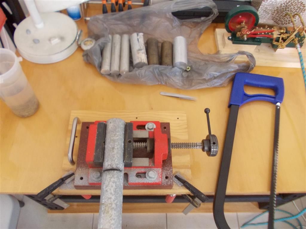

        I spent some time today using my new full size hacksaw to chop up 25mm and 38mm aluminium and also a piece of 31mm brass bar from the scrap yard. It does not take much longer than the jigsaw !
        I have reduced the length of the main shaft of the mandrel by 20mm by parting off in the lathe. This time I reduced the speed of the lathe until I found a speed (about 200RPM) where there was no grinding or chatter. The parting off worked well. I am still practising taking cuts off the minor shaft of the mandrel ; it is down to 10mm. I can get a good finish by taking 0.1mm cuts but even a 0.2mm cut will cause marks on the piece. Everything I have read says that I should take a fairly large cut as I get close to the required 6mm and not make the final cut a small one but this is not what I am experiencing.

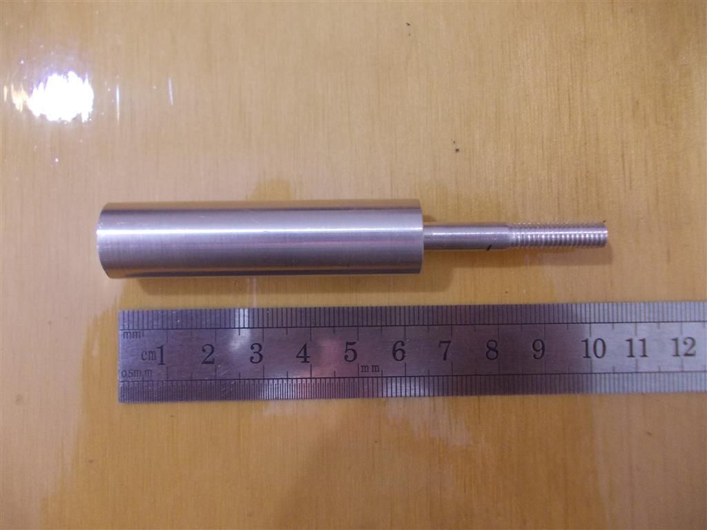

                  I went to Hopper's place today (Thank you Peter) and he was able to cut a longer angle tool to get in closer to the dead centre. The Arceuro tools are good high quality steel and if there is a problem in the cutting then the problem is with me
                  Here is my first finished mandrel. The unthreaded bush is 5.95mm in diameter which may be too small and I am still not happy with the fit. I will cut a few more holes in something tomorrow and check it. Cutting the 6mm thread was surprisingly easy by placing the die holder against the tailstock and forcing it against the shaft while turning the lathe chuck by hand. (NEXT JOB : spindle handle for the lathe !) Cutting a thread on steel is probably more difficult.
                  NOTE : total length is 100mm, major shaft 60mm long and 15.5mm diameter, minor shaft unthreaded 18mm long and threaded minor shaft is 22mm.
                  I will be making another one in aluminium and then try to make one from steel too.

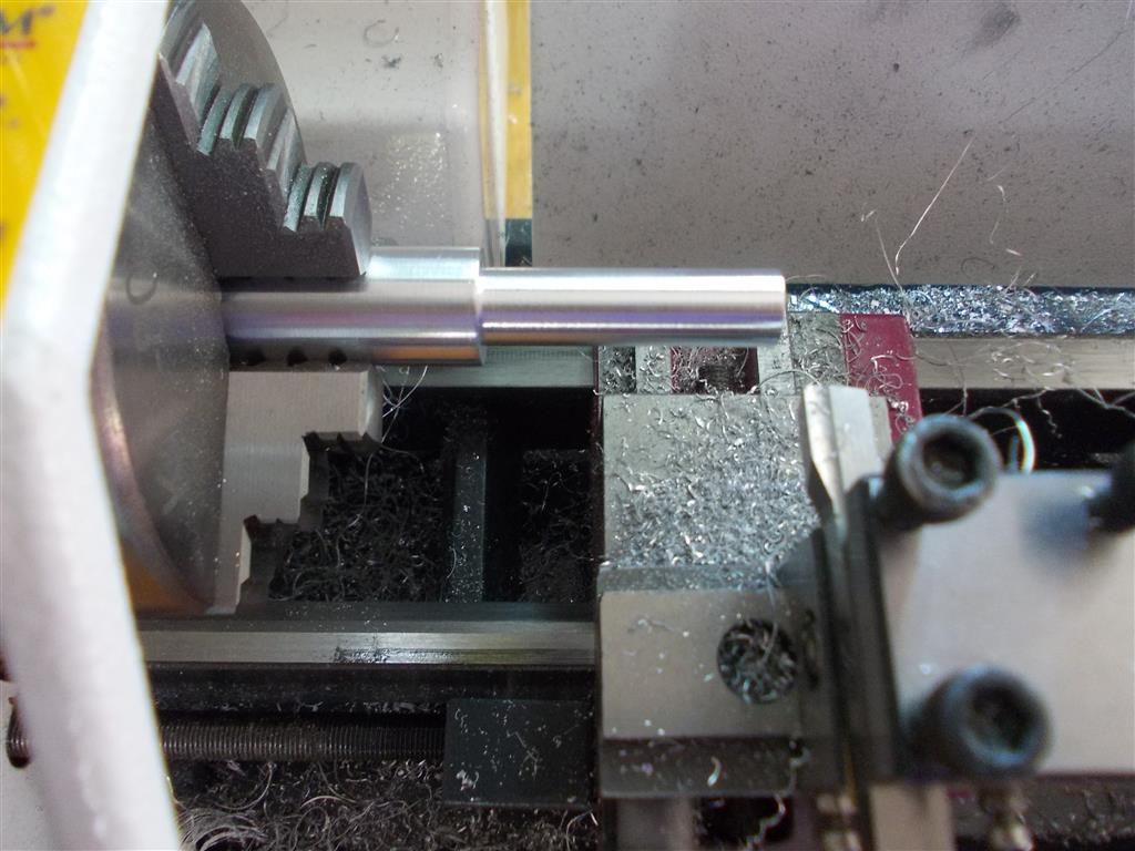

                        I am still getting those marks on the workpiece when I take a cut. It was good yesterday but bad today. I am sure it is the saddle ; there is still some movement in it when I wobble it by hand. I have to lock down the carriage lock and then loosen it 1/8 turn to get anywhere near a good finish. But this works itself loose after a while. I do not think I should have to be adjusting this all the time ?
                        I suspected that the adjustment screws underneath the carriage need tightening up as I have already done with the top slide and the cross slide. So I unbolted the lathe from rom the workbench (I will leave it like this for now until all problems are sorted) then hung the tailstock end over the side of the bench to access the screws under the carriage : two large 4mm socket caps and four small 2.5mm grub screws. I loosened the large ones and then tightened the smaller ones then tightened the larger ones back up again. I kept fiddling with this for 2 hours but it has not made any difference. I expected to be able to lock the carriage in place with the four small screws and then back them off a bit and tighten the large ones. Nothing much happened at all and I am not sure why ? I am right back to square one fiddling with the carriage lock screw on the top …frustrating !
                        Any further suggestions would be welcome.

                          "I loosened the large ones and then tightened the smaller ones then tightened the larger ones back up again. I kept fiddling with this for 2 hours but it has not made any difference"
                          Brian, I would say the 4 grub screws are jacking screws and they need to be UNDONE slightly to allow the gap to be closed by the two larger screws.
                          I would also suggest you try using the power feed, this will eliminate any tendancy for the saddle to lift and fall as you turn teh handle. Worth a try at least to see what difference it makes.

                                  +1 on the grub screw theory. If it is so, you would slacken the grub screws right off then do up the clamp bolts finger tight, then screw all the grub screws in until they just touch metal, then just a tad more maybe 1/16 of a turn or less. All by the same amount of course. Then tighten the clamping bolts and test carriage for free sliding movement. If it is tight, repeat the process but nudge the grub screws in a tad further before retightening the clamp bolts.
                                  Brian, a carriage stop is only for manual feed. If you put a clamp type carriage stop on the bed and drive the carriage into it on power feed, you will do damage to the lathe, probably stripping the feed gears. The carriage stop we were looking at on my old Drummond is a different beast altogether. It moves a bar that disengages the change gear drive to the leadscrew, a feature built into the lathe by the manufacturer but not done on today's lathes.

                                        Today, I spent the whole afternoon adjusting the carriage. I moved the carriage down to the tailstock end and made the necessary adjustments. It was easier to do it there with the end of the lathe hanging over the side of the workbench. I removed all play and tightened things up but when I moved the carriage towards the headstock where most of the work is done it locked up ie. the adjustment was too tight at this part of the lathe. So I had to get underneath again to make the adjustments with the carriage closer to the headstock. I do not think that is good news : it should be the same from one end to the other ?
                                        I made three attempts and eventually I got everything tightened up with no movement when I try to wiggle the carriage by hand. But it has not helped. I am still getting a terrible finish ; it is worse today than yesterday. I had a look at what I made a few days ago : I was getting a perfect mirror finish then. I also tried the autofeed but this was no better. I tried various tools RH, LH and carbide tips but the problem is not the cutting tool. I am not sure what I can try next. I think I have exhausted all possibilities but I may have overlooked something.

                                              UPDATE : there is still play in the carriage. I was sure I had removed all the play ; it is a tricky thing to get right. I will have another go at adjusting underneath it tomorrow as I have to work tonight.

                                                Have you checked that the cross and compound slides haven't slackened off Brian? The manual on the lathe suggests checking these rather regularly. I'll also add that while you might want an oil free life it's needed on lathe slides. You can probably buy slideway oil off ebay. Just a smear is needed. When adjusting slides it's best to remove the lead screws and adjust for a little friction when they are pushed by hand WITH the oil on them. It can be done via the handles but it's easy to over tighten and wear out the lead screw nuts more quickly than they should. One problem with slides is that often there are no oiling points so the best way to apply it is to remove the slide.
                                                Tools may be blunt now. You could sharpen them again with an oil stone buy running the tool on it's cutting edge side along it. Notice the word oil again – it will improve the cutting action. A light oil is best. Grade 400 wet and dry paper should do a decent job too – oil or soapy water on it, Just make sure it's on something flat.
                                                Tools generally don't cut very well if above centre. Best way to check is to face something off on the lathe – just in case the bed is bent. If you look carefully when it cuts to the centre you will see if it's above or below centre. A few thou under is best.
                                                I hesitate to mention the last thing that can cause problems – loose head stock bearings. You really shouldn't be having that problem yet and the manual gives no clues as to how to check and adjust them. It's very easy for people to mess this up and wreck the bearings very quickly.

                                                    The tools are okay. I tried the LH cutting tool which has hardly been used at all and it still gives the same bad result.
                                                    There is no play in the top or cross slide. I know it is the carriage as I can feel it wobble when I wiggle it ; I can see it move slightly. What I do not understand is why it is happening. The whole thing was locked down very tightly and I had trouble loosening the nuts to make adjustments yesterday.
                                                    Anyway, I am awake now so I will have another go at removing the play in the carriage. I am hoping that practice makes perfect. I am glad I did not buy a 40KG lathe ! I would hate to have to be doing this all the time to a much heavier machine.
                                                    UPDATE : I have tightened things up to the point where the lead screw is a bit stiff to wind but I am still getting the same bad finish ; there is no improvement at all. I was sure that the problem was movement in the carriage but now I have no idea. Time to think for 24 hours before doing anything else !

                                                      Further information : the problem is much worse on auto feed. This is not what I expected. Does this tell anybody anything ?
