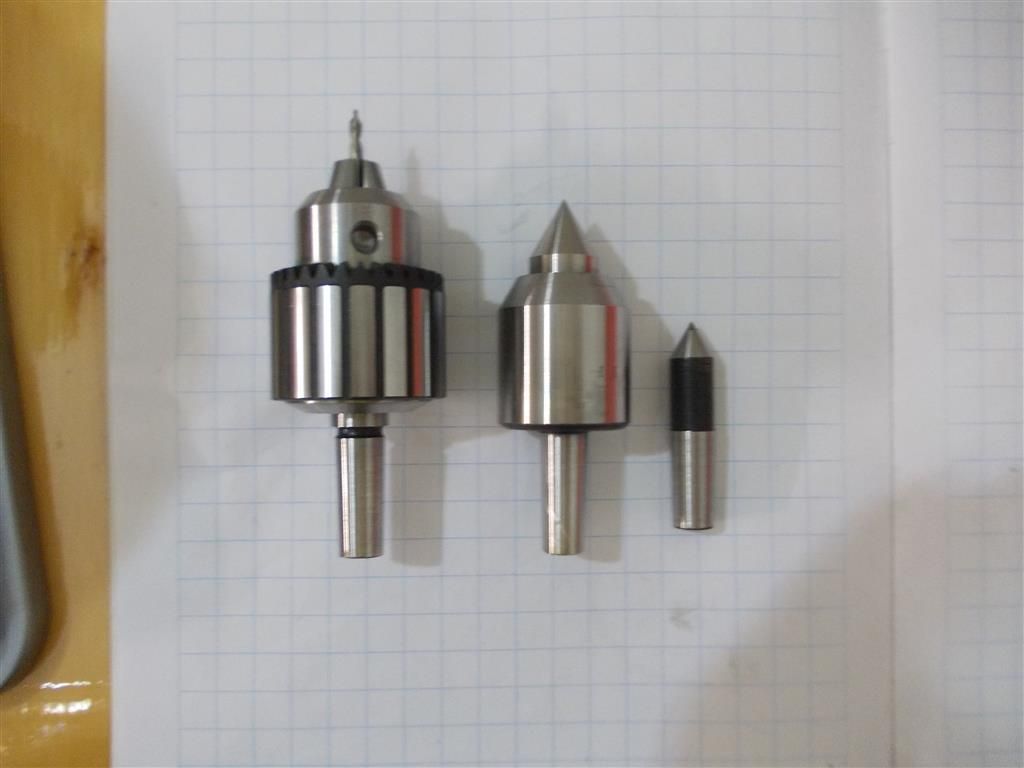

                                  The live centre is for use in the tailstock. Why would it be used in the headstock …I am unaware of this practice ?
                                  The arbor on the live centre has now been trimmed using the rotary tool fitted with a carborundum wheel. The hacksaw barely makes a mark on the surface ; this must be tough steel. I do not know if the live centre will even be needed but it did not cost much so I bought it anyway. When does using a live centre become a necessity ?
                                  If a lead screw cover was to be made then it would have to be fitted carefully as there is not much distance between the carriage and the lead screw.
                                  A carriage stop would also be useful. I am looking at clamps to see what I can use.
                                  How close do you work to the rotating jaws of the chuck ? I must admit it gives me the jitters when I get close.

                                    Brian, difference in terminology in different hemispheres I think. Live centre in Oz generally refers to what the Poms (more correctly) call a revolving centre, ie one with a ball bearing inside it to let it revolve freely. Live centre in the UK I believe technically refers to the solid centre that is put in the headstock spindle and rotates "live" with the spindle.

                                      Thanks Hopper … that's exactly right
                                      … I was thinking [hoping] that Brian was about to try some 'between centres' turning: but evidently he is not.
                                      … It's probably time me to stop trying to help !

                                        My guess is because of different terminology people are getting confused as to what centre you have and what you are trying to do with it.
                                        If you can elaborate a bit more I'm sure more people will help.

                                          You would have to watch what you are doing with shortening a live centre, I use Skoda live centres and the rear bearing on these type is about 10/15 mm from the end of the Morse Taper, there is a button on the end to open up for greasing. I think the centres for mini lathes must have short coupled bearings in the head of the tool.

                                            Regarding centres my understanding is this.
                                            If it rotates with the work it's a live centre and if the work rotates on it it's a dead centre.
                                            Centres come either fully hard (a hard centre) or are unhardened (a soft centre).
                                            A centre in the headstock of the lathe rotates with the work (it's a live centre), as there is no movement, so no friction, between the work and the centre it is usual to use a soft centre. This protects the spindle bore and allows the centre to be re trued-by turning.
                                            A centre in the tailstock does not rotate with the work so is a Dead Centre. The point of this centre acts as a bearing surface and needs to be lubricated. It is usual to use a fully hard centre for this. To avoid the friction between the centre and the workpeice at the tailstock end a Rotating Centre can be used instead. This has its own bearing and as it now rotates with the work is also a Live Centre.
                                            So when ordering solid as opposed to rotating centres they come in two flavours, Hard Centres and Soft Centres.
                                            When in USE if you put ANY solid centre in the headstock it will become a live centre.
                                            When in USE if you put ANY solid centre in the tailstock it will become a dead centre.
                                            Hope things are a little clearer now.
                                            regards Martin

                                              The lathe came with a dead centre to be fitted to the tailstock : the MT1 arbor had already been shortened.
                                              I purchased a live centre to replace this. It had a full size MT1 arbor which had to be shortened.
                                              Dead centre is on the right and live centre is in the middle. I also had to shorten to arbor on the drill chuck.
                                              I thought I was ''turning between the centres'' the other day when I was attempting to reduce the 6.35mm silver steel rod down to 6.0mm. I initially had only 20mm of rod protruding from the chuck in order to centre drill it for the dead centre. Once this was done I moved the rod out to 100mm until it was supported by the lathe chuck at the headstock and the dead centre at the tail stock. Isn't this turning between the centres ?

                                                  In the old days you had dead centre lathes. Technical still the type of lathe best suited for producing totally round work
                                                  These had two non-rotating centres opposed to each other, like on a pole lathe or watchmakers' turns..
                                                  Along came lathes with a rotating spindle, The centre fitted to that was the 'live' centre.
                                                  When centres which rotate but fit in a fixed tailstock appeared naturally some call these 'live' as well.
                                                  Strictly:
                                                  Live centre – fixed centre fitted in rotating spindle.
                                                  Dead center – fixed centre in fixed spindle/tailstock
                                                  Rotating/revolving centre – one that can spin when fixed in tailstock.
