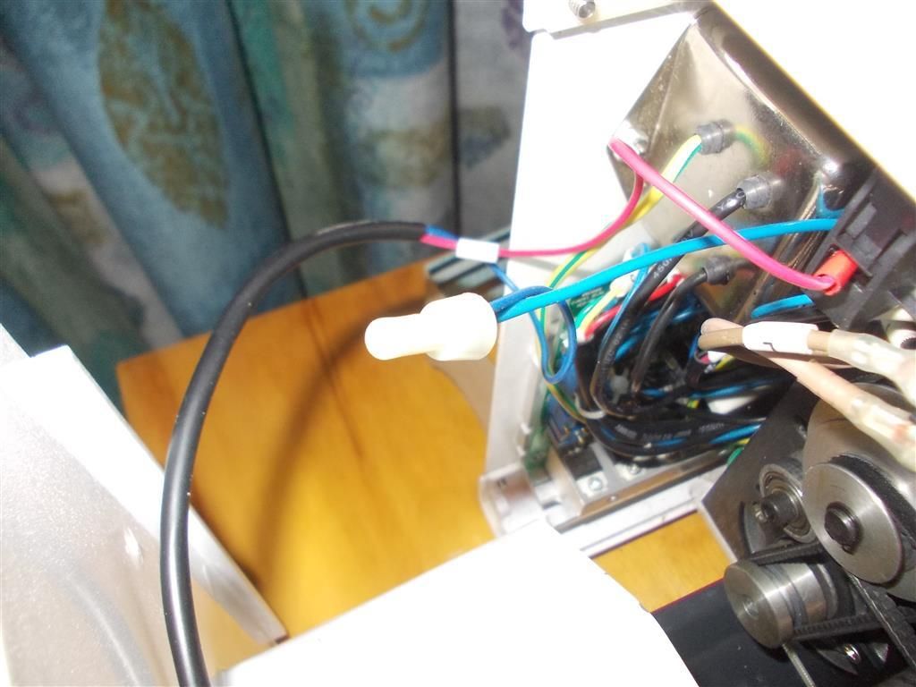

        The lathe is not on ''an uneven substructure'' but I get the point. I will check to make sure that the nuts are not too tight.
        I opened up the case to have a look inside. The micro switch on the door (photo 1) did not seem to be lining up correctly. I made adjustments to this but it did not help. (The magnets are not very powerful in these micro switches.) You can see the other micro switch in photo 2 (black box with two nuts&nbspwhich is controlled by the chuck guard shaft. The shaft is to the left in the photo. I have not attempted to fiddle with this yet.
        What is that thing in photo 3…connecting two loose ends ?

          if you mean the white ‘top hat’ with two blue wires – it is a twist on connector (usually these are very stable)- I’d check (a v gentle tug) whether the red wire (ie live connector) from the lead is sitting properly in what seems to be a terminal block (or is it a fuse block?)
          ETA the item you state is the microswitch in photo 2 looks very unusual to me to be such but I don’t have a manual in front of me – I’d normally just expect 2 wires to be connected to such a switch

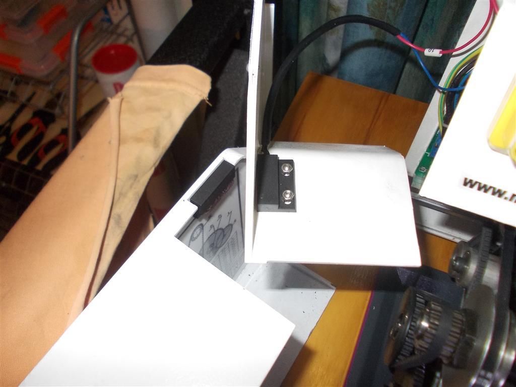

            … the item you state is the microswitch in photo 2 looks very unusual to me to be such but I don't have a manual in front of me – I'd normally just expect 2 wires to be connected to such a switch
            It looks rather like a Magnetic ReedSwitch, doesn't it ?

              Not to me – a reed switch (at least from my 40+ yrs in electronics/telecomns etc is a linear glass envelope containingg 2 leaves that make contact under an applied magnetc field – this appears to be some form of rotary switch presumeably other side is the arm supporting the guard – the two positions reflect up or down of guard and I guess the signal wires (blue + yellow) control the motor + possible breaking of drive current + ?brakeing of chuck
              I’m reluctant to make any further suggestions re using a meter on live wires not knowing the background + technical experience of the owner)

                Photo 2 is not good but it is the best I can do now to show the micro switch on the chuck guard. I may take the back off the lathe tomorrow and this will let me get closer. To do what, I have no idea ?

                    Posted by Brian John on 31/08/2015 13:12:08:
                    Frances,
                    I think we may be at cross-purposes … This ^^^ is the switch I had in mind.

                            the safety microswitches are correctly drawn as the open state is their default without any actuating force (ie the magnetic field) applied – likewise the safety switch is in default state as fully home prior to depression of button.
                            One ‘easy’ way to check + bypass microswitches is to tape small button magnets close to the reed switch (you should in a quiet room hear the slight click as the leaves come together – if a mechnical microswitch tape a small nut over top (again should hear a click as switch operates)
                            Michael – yes I mis understood the ref – the chuck microswitch is I think the out of focus block at right – what I was looking at must be rear of speed pot

                              The micros switches are operated by magnets ; there are definitely no pips.

                                    Posted by Frances IoM on 31/08/2015 14:42:23:
                                    I'm reluctant to make any further suggestions re using a meter on live wires not knowing the background + technical experience of the owner)
                                    Potentiometer for the speed control isn't it?
