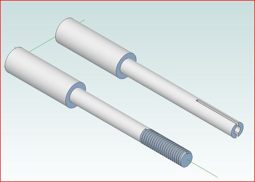

                                    By the looks of things the 4 grub screws are used to adjust the gap between carrage and bottom plate and then the two capheads tightened up. So to adjust (reduce play) you need to loosen the capheads, slightly loosen grub screws and then retighten the cap heads.
                                    You really want to use a larger dia material than the bore for the mandrel, as Neil said somewhere earlier the flywheel wants to tighten against a shoulder.

                                      Regards the mandrel : if I make the expanding mandrel then could I not use a 6mm nut and a large washer as a shoulder for the flywheel to tighten against ie. it will have a nut and washer on both sides ?

                                          If you are having a nut both sides then that means you will be placing the flywheel bore against a threaded shaft, you will not get the fit or concentricity required. The flywheel needs to be a very good slop free fit on a plain parallel shaft for at least 2/3rds of teh hub width.

                                            Make your mandrels something like these. expanding at the back, nutted at the front. in both cases the hub should come most of the way over the split or thread
