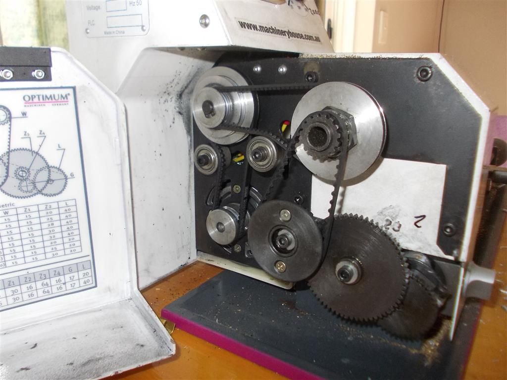

      There are three belts on this lathe. Should they be replaced regularly or do I just wait until something breaks ? I am going to order the belts next week to have on hand ; at this point I do not know how much they cost.

        Posted by Brian John on 10/07/2016 08:17:52:
        Why fix something thats not broke?
        Just ensure that the belts are tensioned correctly and are kept free from contaminants, they should last quite some time before needing replacement. Having spares on hand is a good idea especially if you are in the middle of something…
            You need to ask yourself another question, Brian
            … What will be the 'impact' of belt-breakage ?
            That will inform your decision.
            Example: Some overhead-cam car engines are intolerant of belt breakage, because valves and pistons collide with catastrophic results … These belts should be replaced regularly.
            However: In the case of your lathe, it is likely that no physical damage would be done; and the 'impact' would merely be 'loss-of-use'. … You might therefore want to have a spare set to hand, but not need to replace them until they fail.

              It could be worth having a spare set about but it wouldn't surprise me if you never use them. The main thing about maintaining a lathe is periodic lubrication = slide way oil ideally. Headstock bearings are often difficult to re lube so in many respect it's best to ignore until they need replacing. At some point though they probably will need adjusting but again that is best left alone until there are signs that it needs doing as playing around can easily wreck them.

                Use until they let go if that ever happens, handy to have a spare for each as its bound to happen when you need teh machine.
                Have a look on the belts for any code numbers as it will probably be cheaper to source them from a belt supplier is Oz than have them ordered in from Optimum if the supplier does not keep them in stock.
                Contaminates – swarf, oil, grease, etc

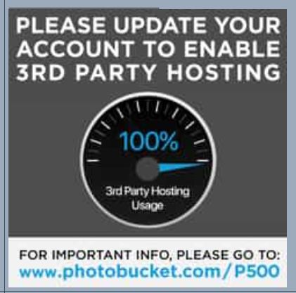

                                  4) All of Hopper's pictures have appeared as a message from Photobucket to update my profile for remote hosting.
                                  (Doesn't happen with anyone else's, or on other threads, so what is the solution, since I have no knowledge of Photobucket?)
                                  Finally, Good on yer, Hopper, and Enjoy yourself Brian!

                                    Photobucket are demanding money in order to allow you to use your photos on 3rd party site many forums are now having a problem with this photos being replaced with the image below, pure blackmail don't pay if no one pays to upgrade there account then at least they will have to come up with a cheaper solution alternatively move to a rival photo hosting company

                                      Howard it is not you that needs to update your profile it is the person who's photos are hosted by Photobucket. otherwise what Harry says. You will find it on quite a few threads and on many forums.

                                        Grief, it hadn't occurred to me but yes, it's very easy for people with nothing to do with photobucket to think they need to pay.
                                        I wonder if anyone has paid up because of this?
                                        By the bye, I can't quite see the point of an image hosting site if you can't share the images…
