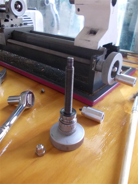

                        I took the tailstock apart again today but I have had no luck shifting that stuck bush. I wrapped it in some thin brass to protect the bush and placed it in a vice to grip it but it will not move. Any suggestions ?

                          You may well find the handles has a screw thread in it so needs "screwing" off.
                          #230819
                          Hopper
                            @hopper
                            Yes, I would think you might need to unscrew the main handwheel first then unscrew the sleeve.

                              Nothing will move…that includes the wheel/handle.

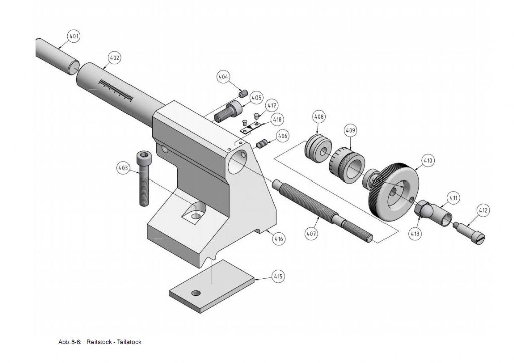

                                Posted by Ajohnw on 20/03/2016 08:50:32:
                                Brian,
                                John is quite obviously correct ^^^
                                The internal thread is shown clearly on the exploded diagram.
                                You will need to find a way of gripping the large screw-thread, and the knurled handwheel, without damaging them.
                                Edited By Michael Gilligan on 20/03/2016 09:29:37

                                  As Michael says try gripping the long thread in your vice with a piece of wood either side to protect it from the jaws. Wrap something around the handwheel to protect it and then a pair of gland pliers or similar to undo it.
                                  #230834
                                    Posted by JasonB on 20/03/2016 10:10:11:
                                    …and then a pair of gland pliers or similar to undo it.
                                    or maybe even one of those 'strap wrench' gadgets, made for opening difficult jars.

                                        I tried the timber in the vice to hold the long thread but no matter how tight I screw the vice, the thread still slips against the timber. It is really stuck on there. The odd thing is that the scale wheel which is between the bush and the hand wheel still moves freely. I would have thought this should be jammed too.
                                        Any suggestions as I am out of ideas at the moment ? I could try the blow torch on the bushing to see if that will expand it slightly but I want to run it past a few people first.
                                        #231263
                                          Your little drill vice is probably not upto it, really needs a decent size bench vice.
                                          The scale wheel is only a friction wheel so it can be reset to zero so one would hope that it does rotate.
                                          I doubt heat will help without getting it very hot and that will possibly damage the soft handwheel, if some galling has taken place then heat won't help much either.

                                            Brian,
                                            One detail that worries me a little …
                                            The exploded diagram that John copied [from p69 of the manual] has a "bubble" numbered (414) which is poorly positioned but, according to the list on p70, the item is a Spring.
                                            … With the benefit of having the assembly on your bench; are you comfortable that you understand where (414) is, and what it does ?
                                            P.S. The number is barely legible on John's jpg crop, but is reasonably clear in the pdf.

                                              I do not have any spring 414 : maybe this is the cause of all my problems ! Where is it supposed to go ? There is nothing at all marked on the tailstock exploded diagram..is there ?
                                              On page 67 there is something (a spring or clip ?) marked as 527…I think. It is supposed to fit over the bush. I do not have this item at all and I have never seen this before. Considering the dickhead way they assembled the clutch mechanism it would not surprise me if they left this thing out altogether !
                                              Thank you very much for drawing this to my attention.

                                                      Posted by Brian John on 23/03/2016 09:17:38:
                                                      Look carefully at the exploded view:
                                                      (414) is cunningly camouflaged by the knurling on the handwheel.
