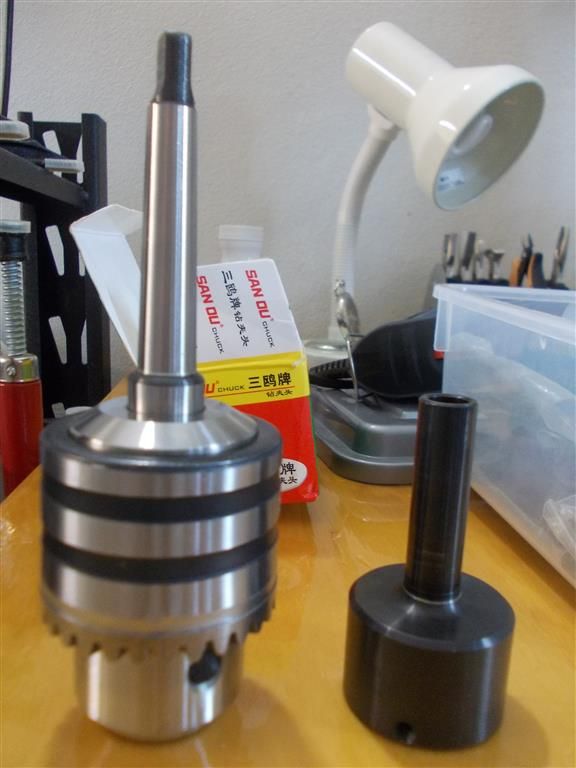

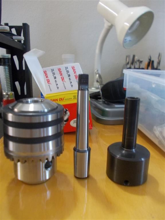

                              My new larger drill chuck arrived today : 3-16mm B16 taper. This is needed to hold the tailstock die holder the shank of which is too large at 12.7mm for my smaller 1-10mm drill chuck. The MT1/B16 arbor also arrived (from a different company). Is it seated properly ? There is still about 5mm not inside the drill chuck…I thought it would go all the way in ?
                              NOTE : I have to cut down the arbor so it fits in my tailstock which is MT1 short.

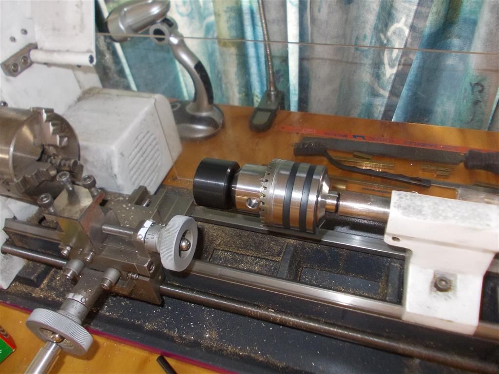

                                That's a strange looking die holder Brian. It looks as if it would have to pull the tailstock along in use.
                                Usually the holder slides on a parallel rod and is prevented from rotating by a short handle. A simple project to make yourself to fit your lathe.
                                Something like this: **LINK**
                                Russell

                                  I got two different sizes of those holders at the clearing sale of a tool store in Christchurch (NZ).

                                    I would expect most of the taper to fit into the back of the chuck Brian. Maybe around 1mm proud.
                                    You can check the B16 sizes from a link on this page
                                    **LINK**
                                    You could turn the die holder you have into a sliding one by turning the end of a drill chuck arbour parallel to suit the hole in the die holder. Your carbide tools should be ok on the B16 arbour. You may need a 2mt to 1mt sleeve to hold the work in the head stock spindle. I can't remember you headstock taper.
                                    To be honest when I needed 1mt arbours I parted off and turned down used 1mt reamers on a Hobbymat. Screw cutting them if needed was ok too but the dog clutch needed deburing with a file afterwards. That is what started me off converting brazed tip parting off tool into screw cutting tools. In this case it's probably possible to get a reamer running true in the 4 jaw.

                                      Thank for the link John : correct size at big end is 15.733mm whereas mine is 15.90mm so no wonder it is sticking out a bit. It was a cheap arbor from China so I guess we shouldn't expect too much ! I cut it down to size today so that it will fit in my tailstock chuck. It all seems to work quite well. I can now hold my large 12mm stub drills which saves using the boring bar when boring out a cylinder ; I just use the boring bar for the final cut and finish.

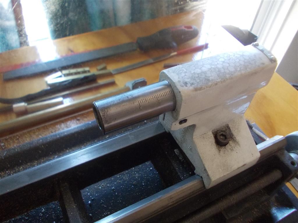

                                        I have a problem with the tailstock. I was cutting an M3 thread on some silver steel using the lathe to keep things square ie. work piece in the chuck and the tailstock barrel pressing against the die. All of a sudden the tailstock seized up and would not turn in or out. I have used this method to cut threads many times and this has not happened before. I expected to find some swarf in the tailstock somewhere but that was not the cause.
                                        I pulled the whole tailstock assembly apart to examine the problem : the barrel/pinole (part 402) and the bushing (part 408) had suddenly become to large for the tailstock ! Even with all the grub screws taken out, these parts could not be removed or reinserted by hand ; I had to knock them out with a hammer and punch. How can this happen ? I removed the barrel and polished it up with 1500 grit and that seemed to work okay as it is now a good fit. But I have taken too much off the bushing (I should not have used a file) and the whole tailstock is now wobbly. It is good for nothing in its present state.
                                        I have called Machinery House and they do not keep such parts in stock. They suggested I make one up myself which I will have to do. I do not think this lathe is very good with large steel parts. Could the bushing be made of brass ? I am hoping that a new bushing will solve the problem otherwise I am all out of ideas. I buggerised around with this all afternoon. I still do not know why it suddenly stopped working ; it was fine yesterday.

                                        Hopper
                                          @hopper
                                          Brian that seems very odd. Have you checked for swarf in the moving parts and burrs on the barrel / Pinole (WTH is a pinole anyway?) along the groove where the grubscrew 404 locate?
                                          Is the pinch bolt 4054 backed off? ISTR it had to be set just right for things to work smoothly. Too loose and the barrel flops about the place. Too tight and the barrel will not move. Needs to be set so there is just a bit of drag perceptible.
                                          It's hard to see how a loose fitting bushing 408 would make the whole tailstock floppy. The barrel should be guided by its fit in the hole in the casting, regardles of whether the bushing is even in place or not. And when installed, the grubscrew should hold the bushing in one place and not allow any slopping about.
                                          If that bushing is designed to rotate with the spindle, I would make the new one out of steel so the grub screw does not wear it quicklly. But if the bushing stays still and the shaft rotates inside it, brass might be better.

                                                Looks like the barrel has been rotating probably due to the grub screw nearest the headstock comming loose and not seating in teh keyway.
                                                If you click the photo sof 31st Jan you cannot see the scale printed on teh barrel, latest photo you can see the scale.
                                                If the barrel rotated against the grub screw it would have made it tight, the bush is probably meant to be tight as that is what the screw acts against and it takes the thrust.

                                                  The scale has always uppermost ; it is sometimes not visible due to the angle of the light or if the flash is used.  If you enlarge that photo of the 31st and look closely you will see that the scale is on the top. The barrel has not been rotating.

                                                    Brian, there is a possibility that the barrel may rotate slightly against the grub screw in the keyway underneath, and raised a very slight burr. The problem I had with my tailstock was when I had it too far out (on about the last thread), when I was drilling a deep hole, and the thread burred over, just as it got to the end, and it would not go back in. No fault of the lathe, the book says 95 mm travel, but 85 mm is the usable travel (on my lathe).

                                                      Sounds like the thread was binding or however the backlash is set up had worked itself too tight. Unless of course the barrel was extremely tight when the screw and etc was removed but I wouldn't expect that to be very loose. i doubt if I could push the one out of my lathe easily by hand as I can feel stiffness via capstan arms about 150mm long which gives a fair amount of mechanic advantage via the rack and pinion it drives.
                                                      Sometime Brian I suspect you need to think more before jumping in and figure out how this works before doing anything to it.
                                                      I reckon brass should  be ok with some grease but may not last as long as steel.
