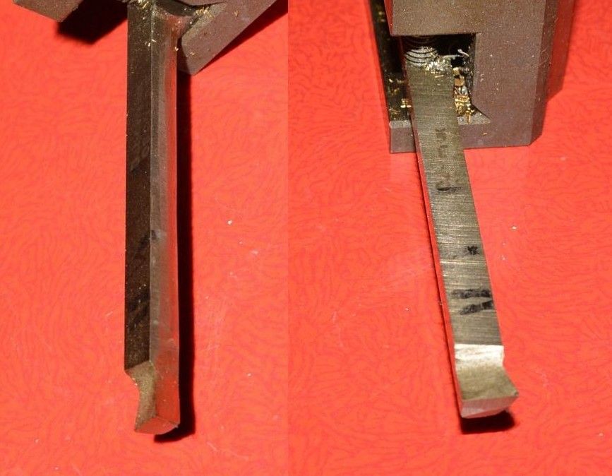

              This one was made for 1/4 sq hss. Not much needs grinding off the tool bit. Just radius the corner with a little off the cutting side width.

                          Try & make your own, re Ian S C suggestions. I have made a few of my own over the years from broken HSS taps…
                          … a couple of home made boring bars
                          George.
