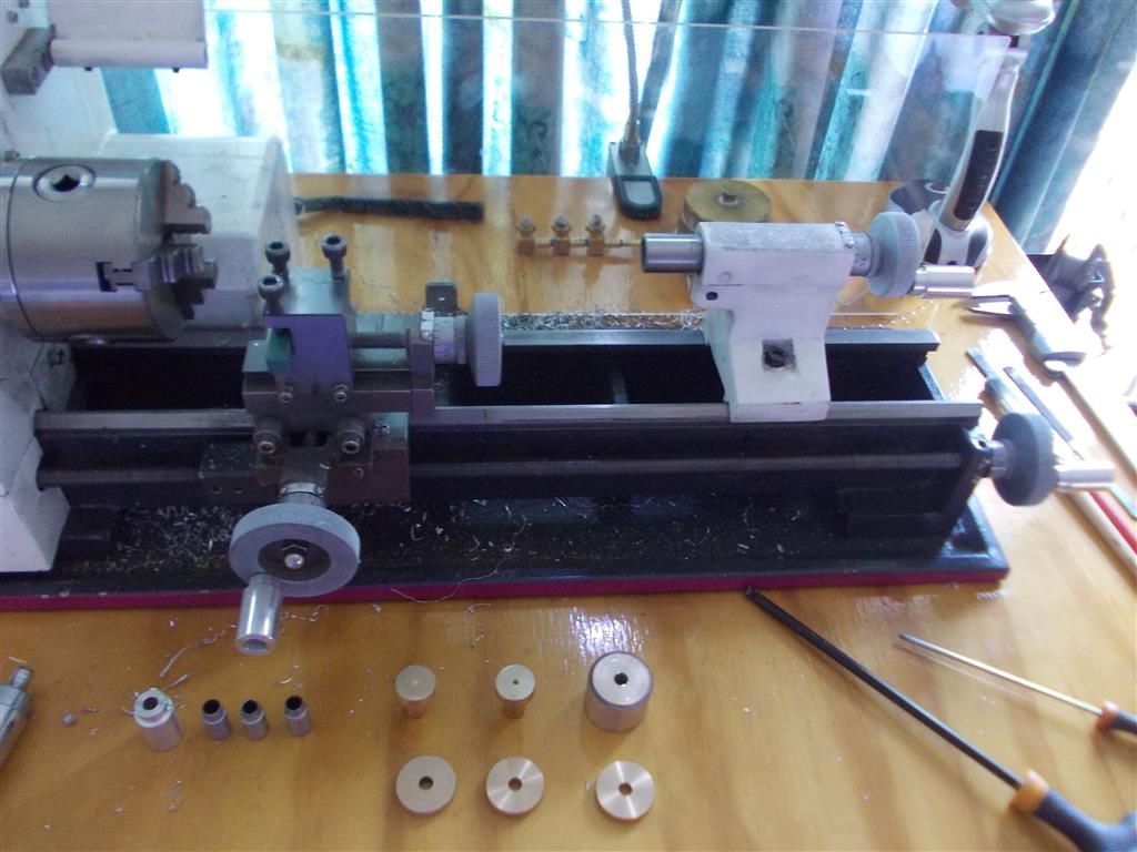

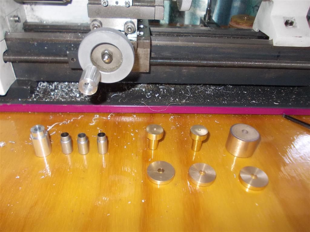

                        Back to Brian's specific machine, here are some pics of the end result. Some 1mm and 1.5mm deep cuts on some scrap 1" and 1/2" diameter steel bar. Quite an acceptable finish too.
                        And never again shall I think of the Mighty Drummond as a small and light duty lathe! Brian's new faceplate set up for boring the new register recesses on the back.

                                #211455
                                  Posted by Hopper on 10/11/2015 12:05:45:
                                  Good to see evidence of the results, Hopper
                                  Never doubted you for a moment … Super Job. star

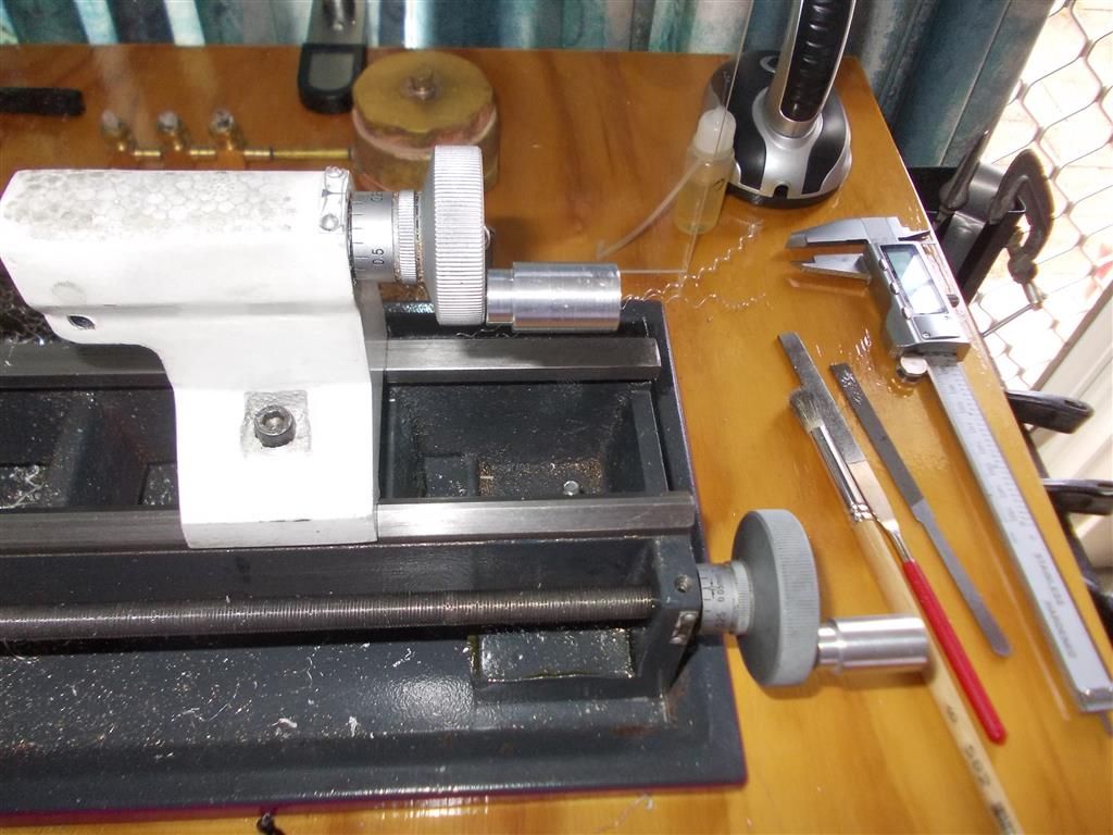

                                      Things are going well now. I did come across one problem today when the tailstock jammed up while I was trying to drill some holes. I pulled it apart and found that swarf had got in there : between parts 402 (pinole…centre sleeve) and 416 (tailstock body). I would never have thought swarf could get in there ! Anyway, I learned a new word ''pinole''
                                      I made some new, larger handles from aluminium for the lathe and this has made a big difference ; it is much easy to turn all three wheels now. The old piddly, little handles and one new handle are in front of the lathe. You can also see the wax chucks and the discs I cut from them. That went very well and this will be my usual method for facing small parts.
                                      Hopper has worked some real magic on this machine….many thanks.

                                        Hopper
                                          @hopper
                                          Result! Glad you are enjoying it mate.
                                          The first accessories for your lathe made and fitted. You are well on the slippery slope now. Be careful, it can become addictive!
